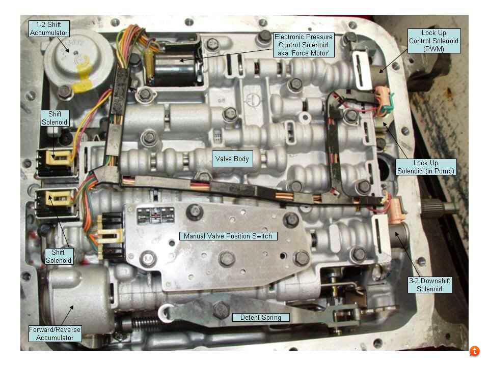

If its the transmission if you time the shifts right, letting off the gas when it would normally shift drops it to the next gear. As a temp fix i'd try putting in new shift solenoids. About $10 each and its a simple bolt and wire plug process that you can see with the pan drained and the trans filter removed. They look like plungers.
The two yellow plugs on the far left are the solenoids
