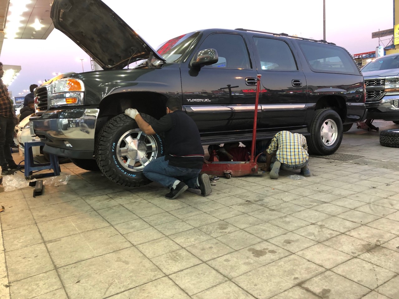

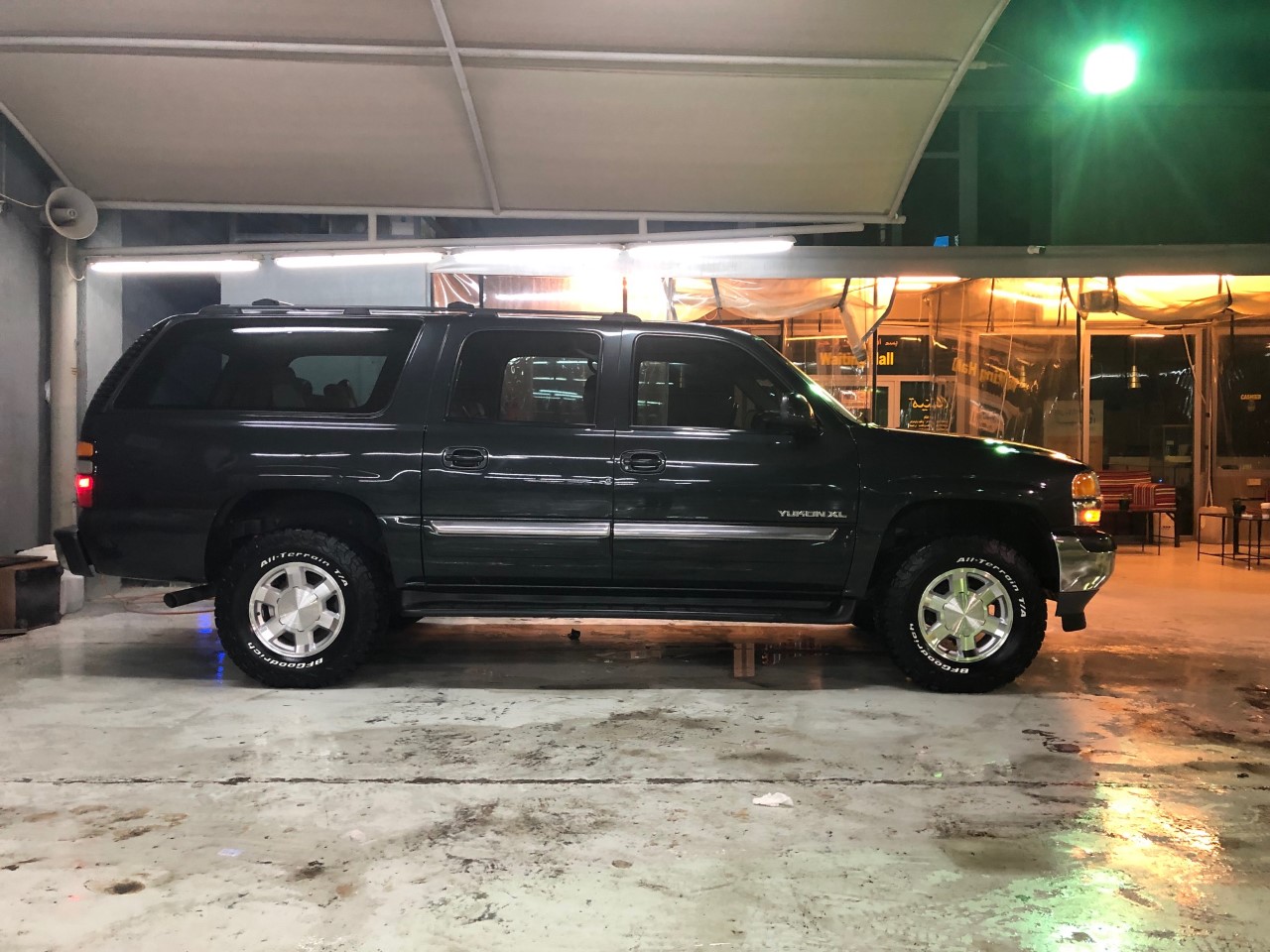

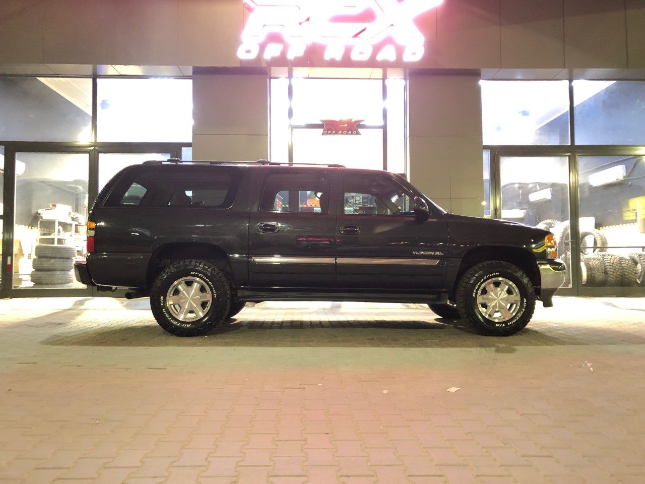

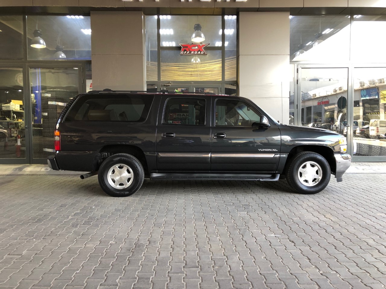

hello guys just want to share my project and whats the difference between before and after

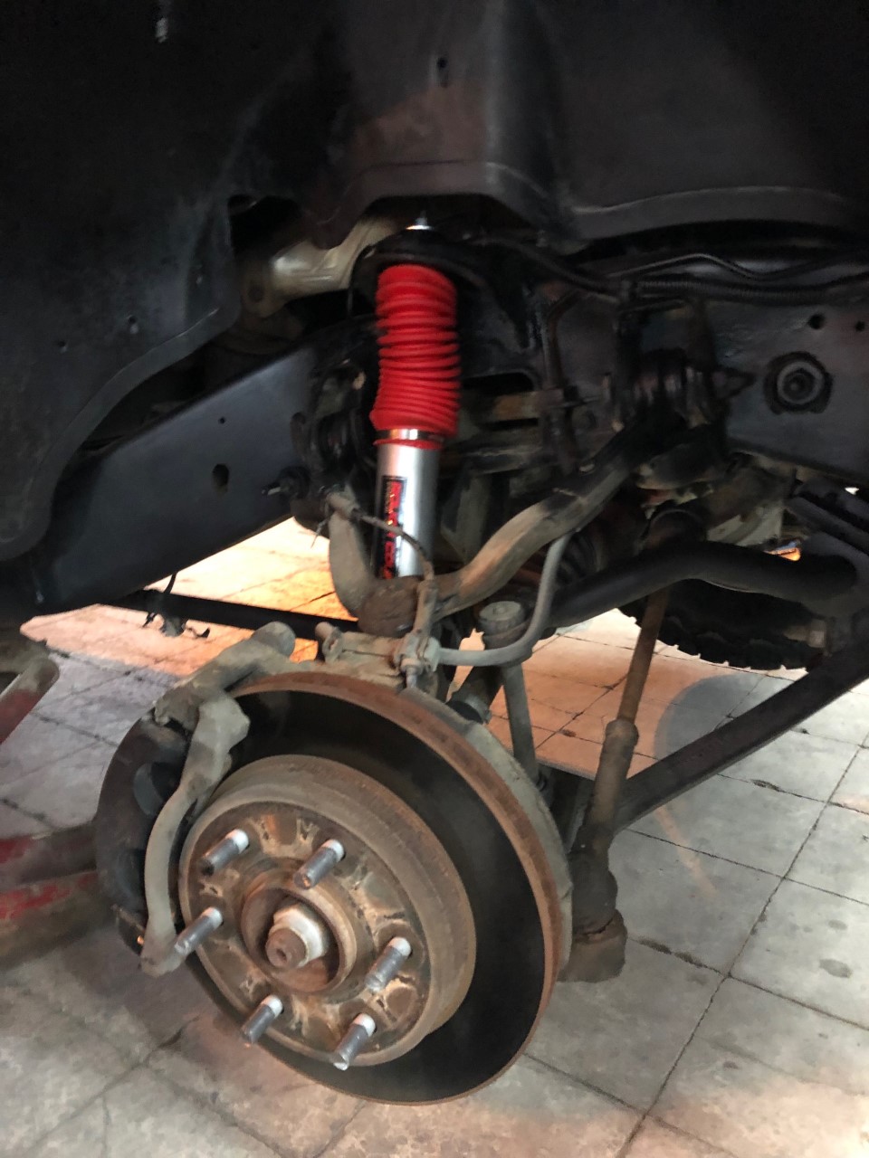

this is my 2003 Yukon XL with 4wd it was normal shocks and i have use rough country torsion keys with rear level 3 inch with factory coil because my truck non air suspension no need to replace it but i worry about the feeling for the drive quality before i install, my vehicle come with rear fat shocks from the factory and i chose the correct part and every thing is extremely Nice :)
i have replace wheels and tire
new factory wheel 17 inch with 285/70 BFG Ko2 the truck is totally Different and more stable.
here the parts:
torsion Key lift :https://www.roughcountry.com/gm-leveling-lift-kit-7592.html?find=2003-gmc-yukon-xl-1500-4wd-567691
front shocks: https://www.roughcountry.com/premiu...a.html?find=2003-gmc-yukon-xl-1500-4wd-567691
rear shocks: https://www.roughcountry.com/premiu...c.html?find=2003-gmc-yukon-xl-1500-4wd-567691
shocks boot:https://www.roughcountry.com/shock-boot-87150.html?find=2003-gmc-yukon-xl-1500-4wd-567691
rear lift:https://www.ebay.com/itm/For-00-06-...ke:GMC&hash=item3aab528aed:g:YAkAAOSwN8hd16W4
here the results :)
