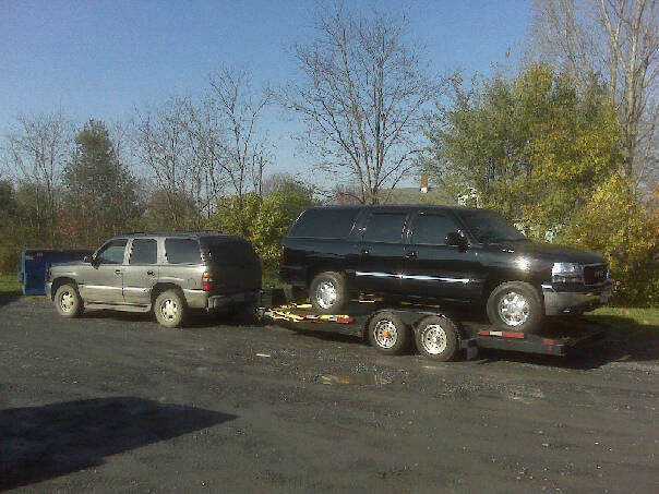

Which gears does yours have? I know some came with 3.42s but I think it's kinda rare most had 3.73s or 4.10s. These 5.3s have more upper end power though mine comes on strong aroun 2800rpm.
here is the pic of my buddy towing my yukon.
