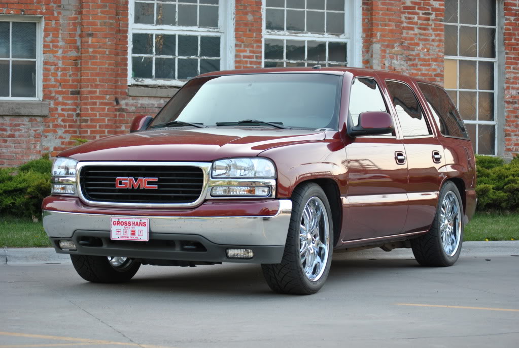

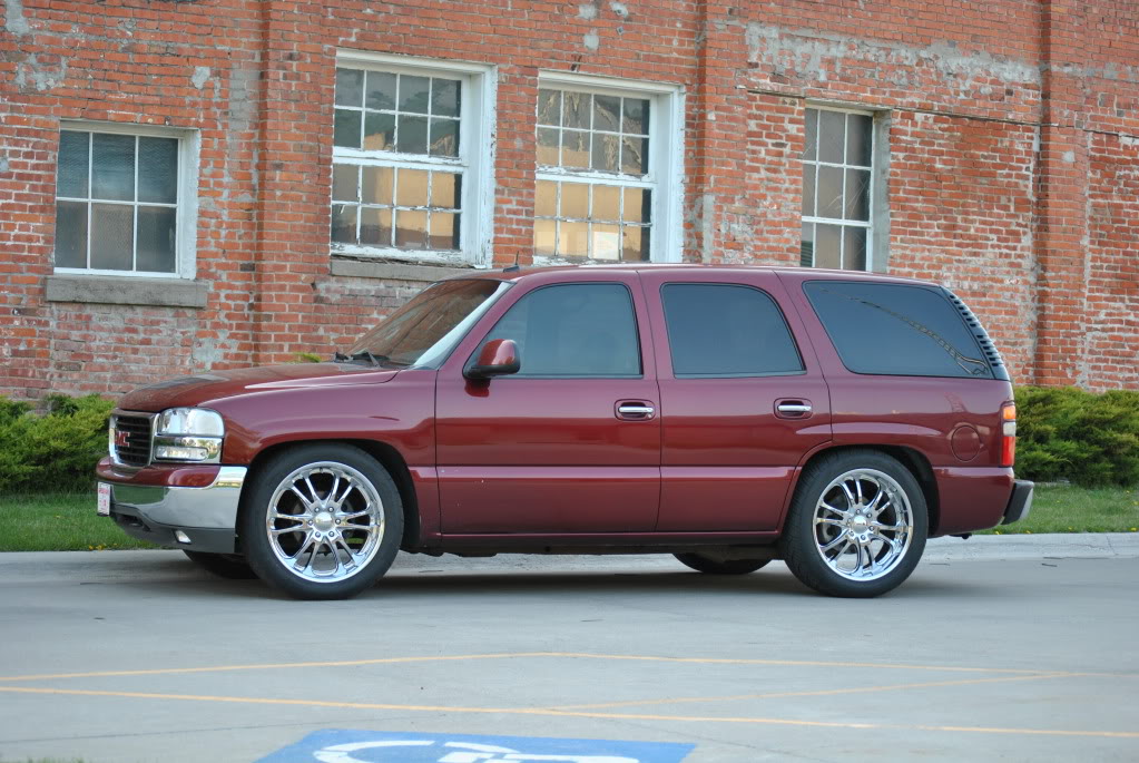

Took some new pics today. It sits lower with the isolators out!
I will get a few others up soon!
---------- Post added at 10:40 PM ---------- Previous post was at 10:39 PM ----------
It sits even all the way around. It is currently sitting at 31.5in at all 4 corners. Wanting to go lower in the back.
---------- Post added at 10:45 PM ---------- Previous post was at 10:40 PM ----------
More:

Looks good! I like the way the front bumper turned out. I think it makes the whole body look cleaner with the grill and bumper that close.

looks perfect what did you do again 89 chevy to get it so low ? suspension components ?
I did the DJM 3/5 drop. It includes LCA's, and 5in drop springs in the back. I removed the Isolators in the rear so its a 5.5in drop in the rear. Then we body dropped it. It lowered the truck 1.5in. My drop currently is a 5in the front, and 7 in the back. I am lowering the rear another half inch at least.
The wheels are 285/45/22 Boss 313's with Nitto 420S tires.
Thanks for the complements!
