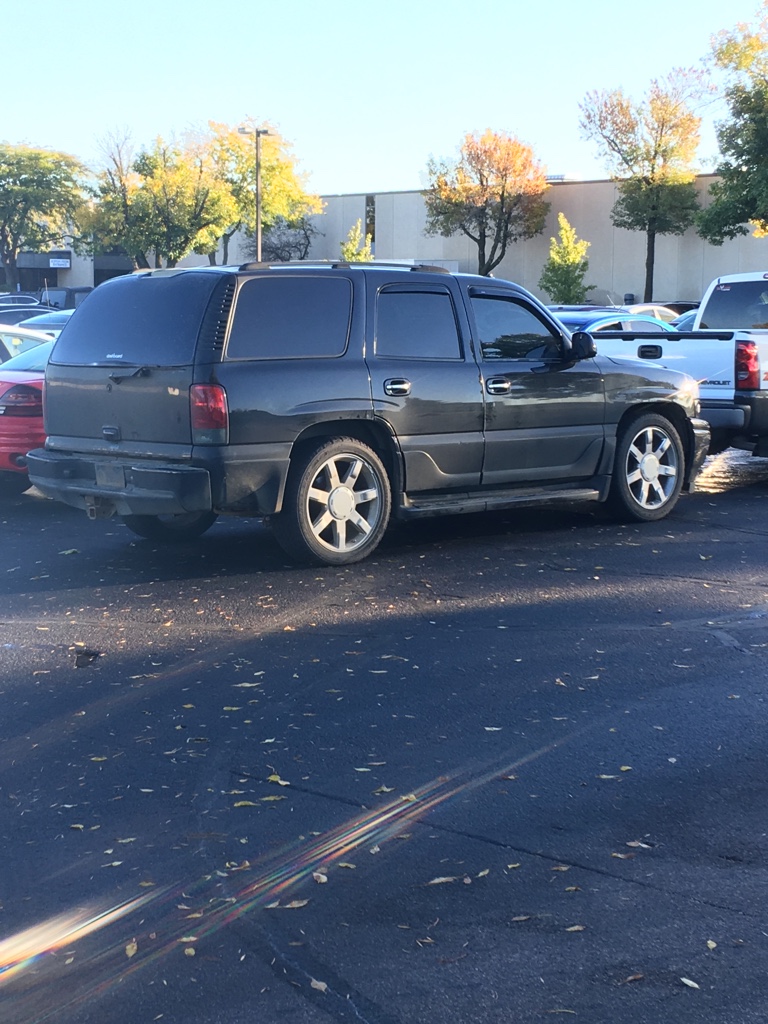

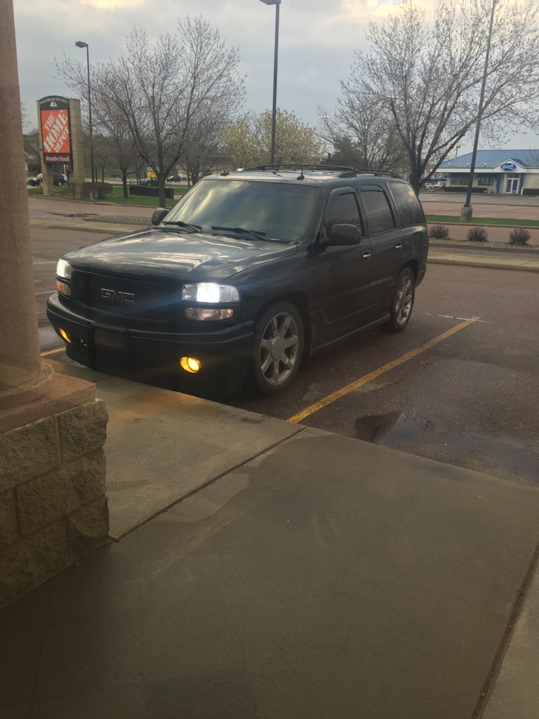

Here's a picture of my Denali and the start of my build thread. Have lots of plan for it.
Here's a list of what's I've done on the exterior so far.
Exterior: De-bagged, lowered torsion bars all the way, cut springs (cheap way, rides fine), tinted windows, esky handles, esky antenna cowl end cap, esky 22s, led tails, clear Sierra headlights and turn signals, LED conversion on all lights, painted grill, and added lower valence

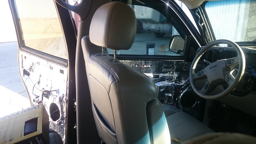

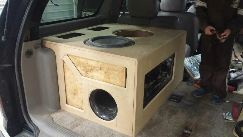

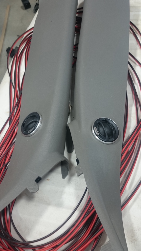

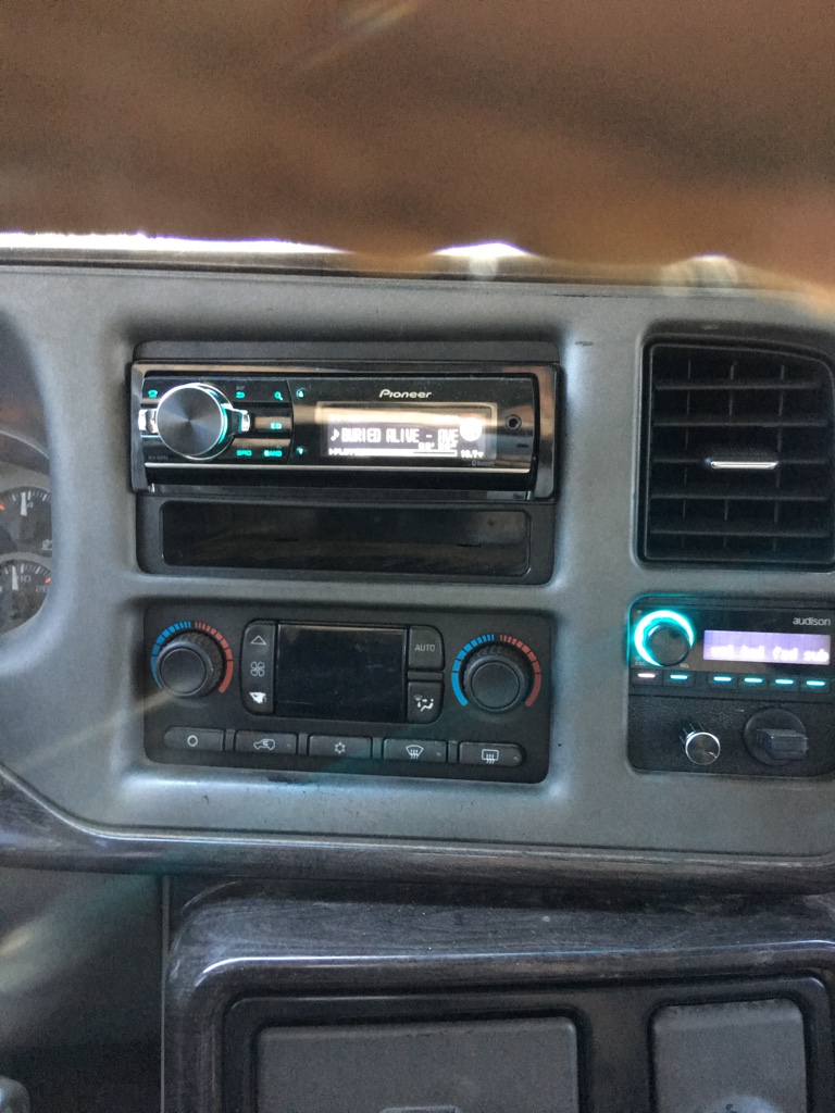

Interior: escalade knobs and vents (putting shifter in soon), full audio system includes Pioneer 80PRS, stinger 8000series rcas, Phoenix Gold Elite 5 Amp, Audison Bit TenD, Hertz Mille 2way(front), Audison Prima (rear), Hertz Hi-Energy 12s, Dynamat all around and some Dynapad on the floor, Stinger SPV70 battery also. Here's some pics of the build

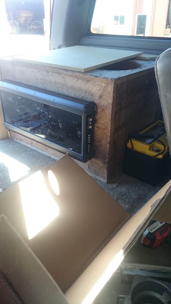

That box looks big , but badass .How's it thump ?
Box isn't that big. Just looks big with the beauty panels. It's an sq set up. I ended up hitting 145db

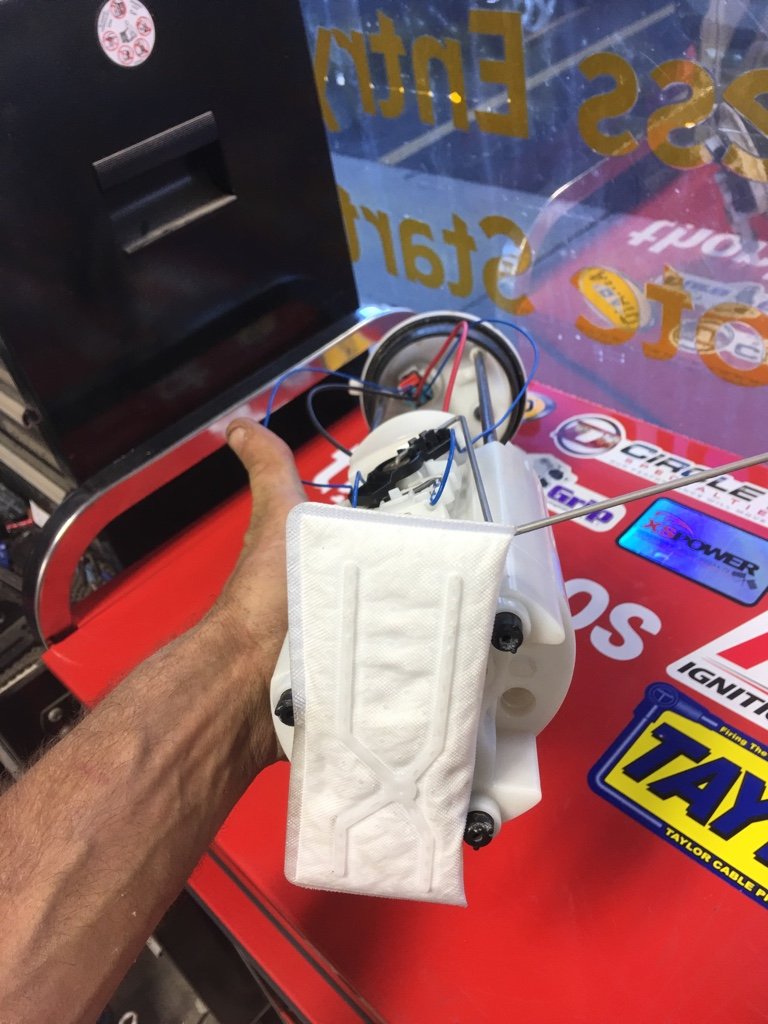

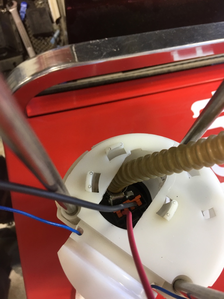

Threw a Walbro 255 pump in the factory pump assembly today
What's the deal with Walbro ?
I am looking for a good pump and haven't had much luck with aftermarket in the past. I found the dealer is the best but pricy.
How good is walbro and how there pricing ?
W
Wstlk7
Oct 3, 2016
32
19
I bought the pump for about $95 if I remember right. Walbro is a good brand in my opinion. Good reviews from my research. I'm also doing performance mods. I had to mod the factory pump assembly a lot to make it work. I had an extra one laying around from my old truck so I to the plunge to save me some time when I pull the truck apart.
