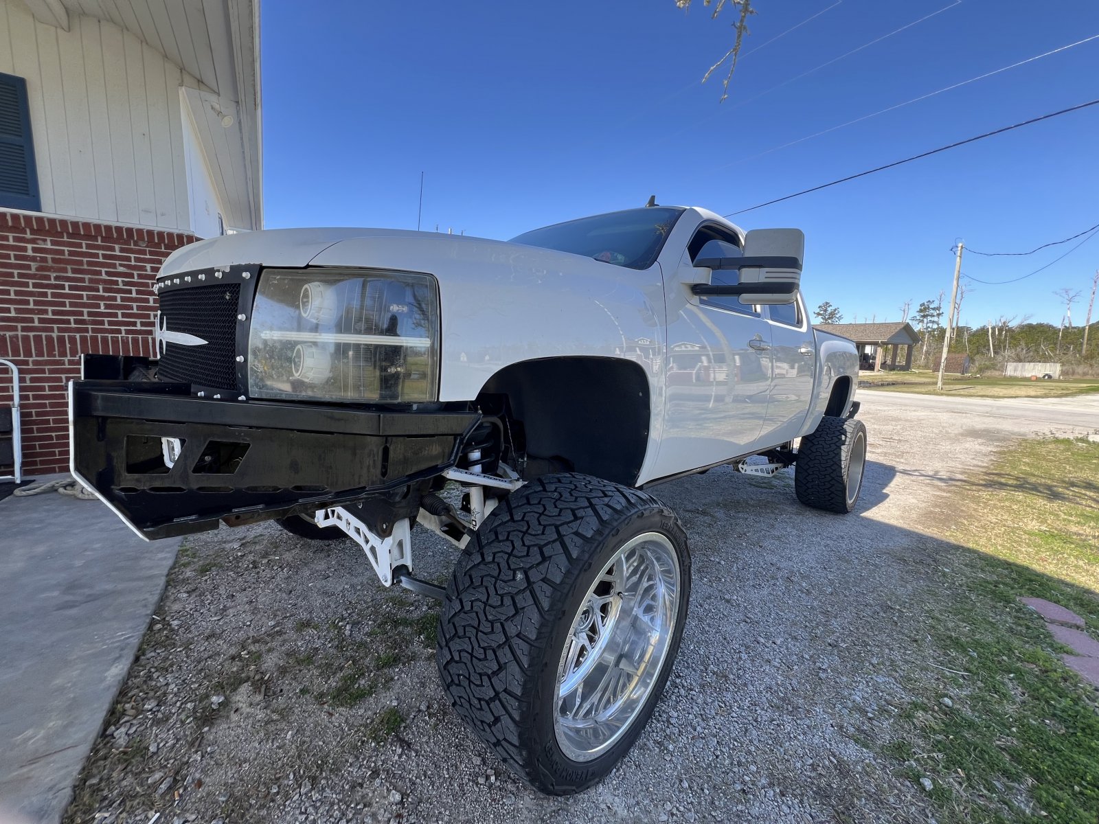

Atomic fab makes a nice torsion bar to coil over conversions for these 99-06’s
I personally run kryptonite products on everything I own and I’ve had no issues at all with any of their stuff.
I wanted to be one and done for awhile as far as the front end goes so I opted for the beefier kryptonite stuff and locking alignment cam plates from dirt king fab to hold it all together
Even if you plan to stay stock height kryptonite is about the beefiest suspension you can get for these rigs before stepping into fabricated pre runner suspension with heimjoints and what not
Note if you do switch to coil overs up front it would be beneficial to upgrade the upper control arms and if money allows it a set of uniball uca to allow for more down travel as it’ll give you a smoother ride and your suspension won’t “bottom out” like it does on the stock suspension

I did my kryptonite suspension at around 250,000 miles or so
I now have over 400,000 miles on the Tahoe in my profile pic
So my front suspension has lasted the abuse of a 9” lift and 24x14’s and 35/15.50s on 2” wheel spacers for almost 150,000 miles now and it still drives like I just put it on!

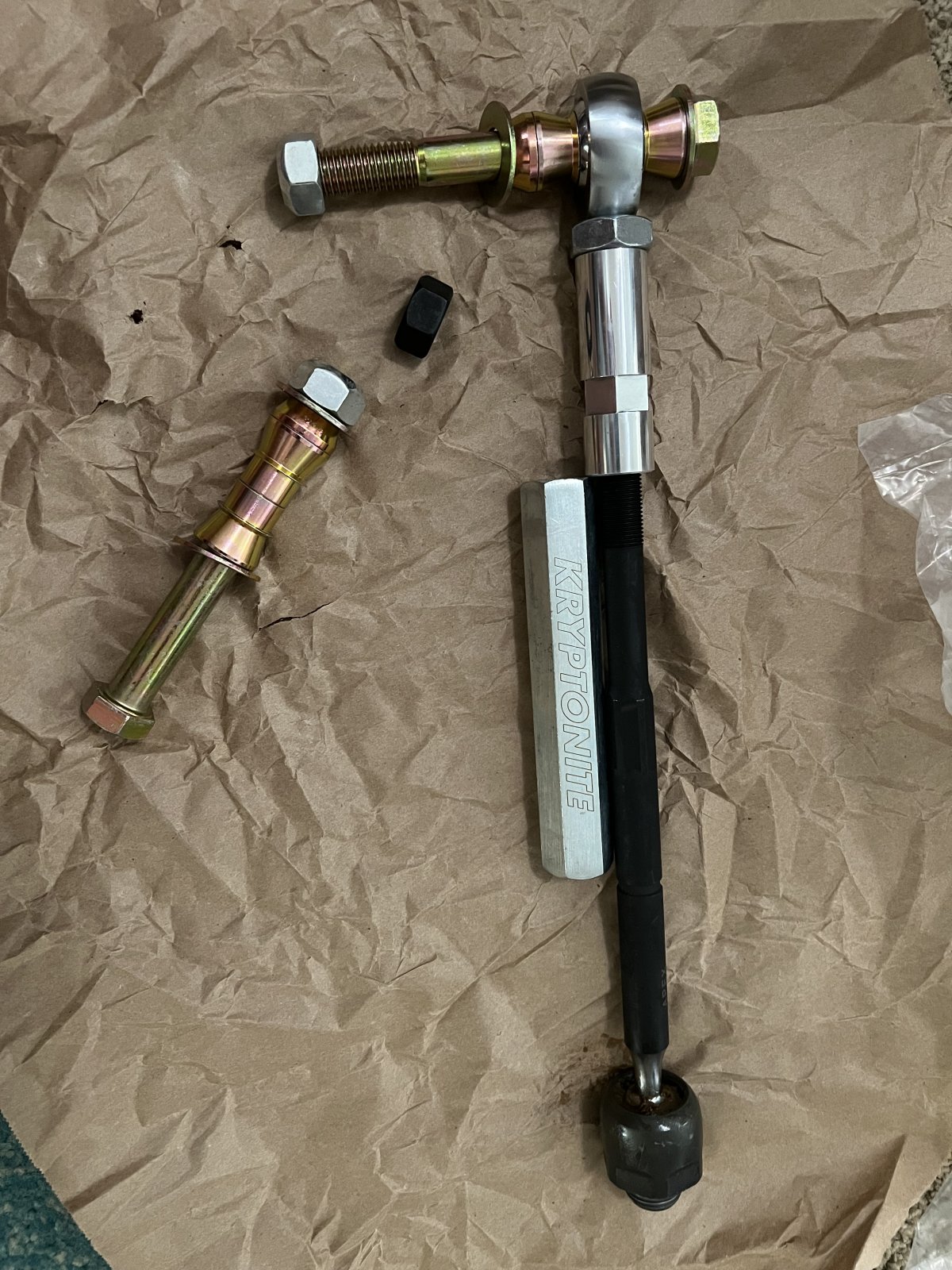

Just got my mixture of parts today for my Silverado
Got kryptonite uca bushings
Kryptonite lower ball joints
Kryptonite tie rod sleeves which I will have to cut in half for these apex tie rods
Apex hummer style inner tie rods
Dirt king locking alignment cams
And twisted metal fab tie rod ends
