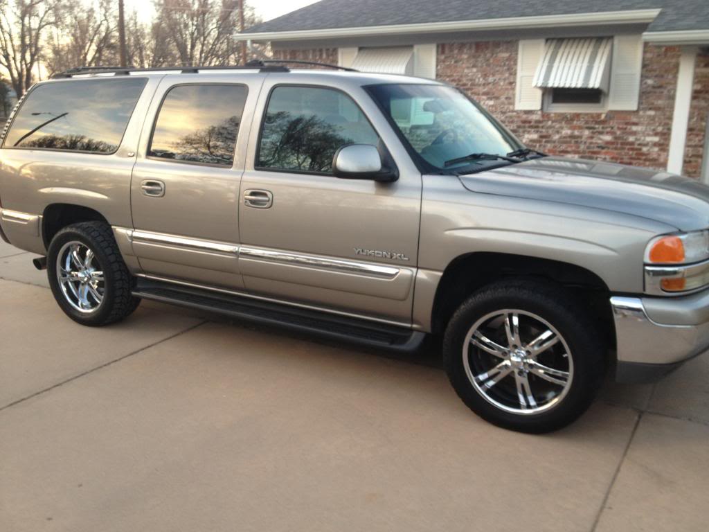

Slapped on some 20's today that I got off Craigslist for 375. They have 285/60/20's on them and I think it is a close fit. Don't think that you could go taller or wider. I am still going to do the Keys, and Spacers for a little lift. The new wheels lifted it a little, and I love it. Here's a pic.......
thegeneral
Jul 25, 2011
136
Don't do keys! You'll be replacing ball joints every 6 months. The keys put the shafts at a bad angle and it does wonders on your suspension (I know from experience). Go for a full on lift or keep it the way it is... I think it looks sweet as you have it now!
