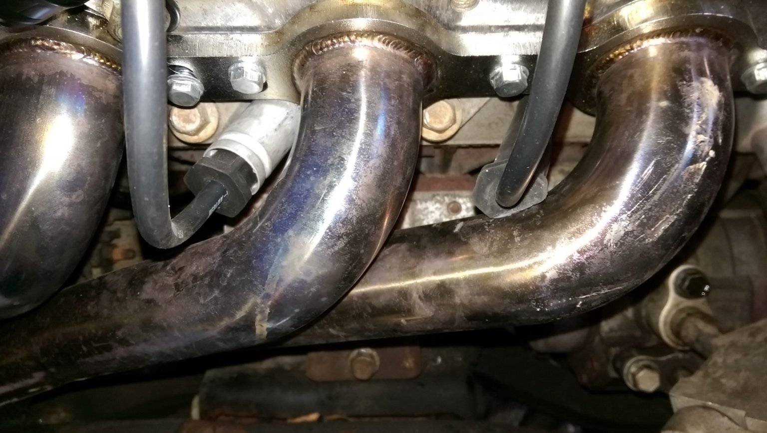

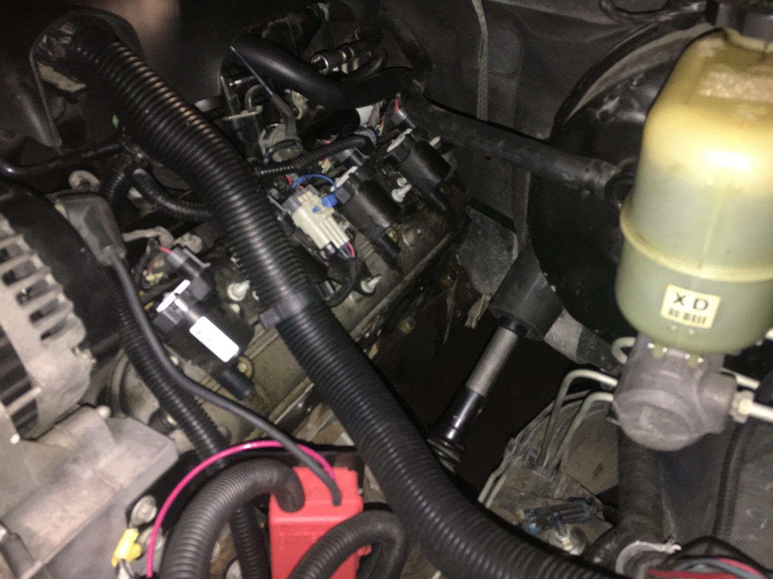

Longtubes came in this afternoon. I managed to get everything but the passenger manifold off the truck in about two hours before I called it a night. Test fitted driver side, only issue was the littl aluminum skirt that hangs off the motor mount more than it should imho. Trimmed it off and it fit like a glove. I'm fully expecting the passenger side to be a ***** and to end up having to do motor &a trans mounts. Just how my luck is when I work on stuff, but we will see how it goes. Fingers crossed

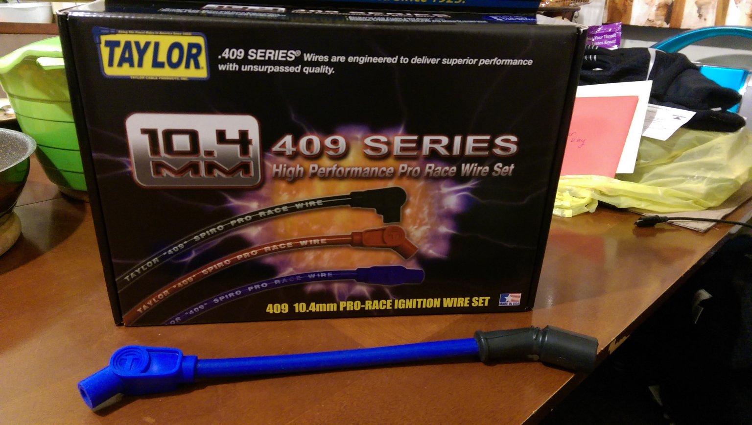

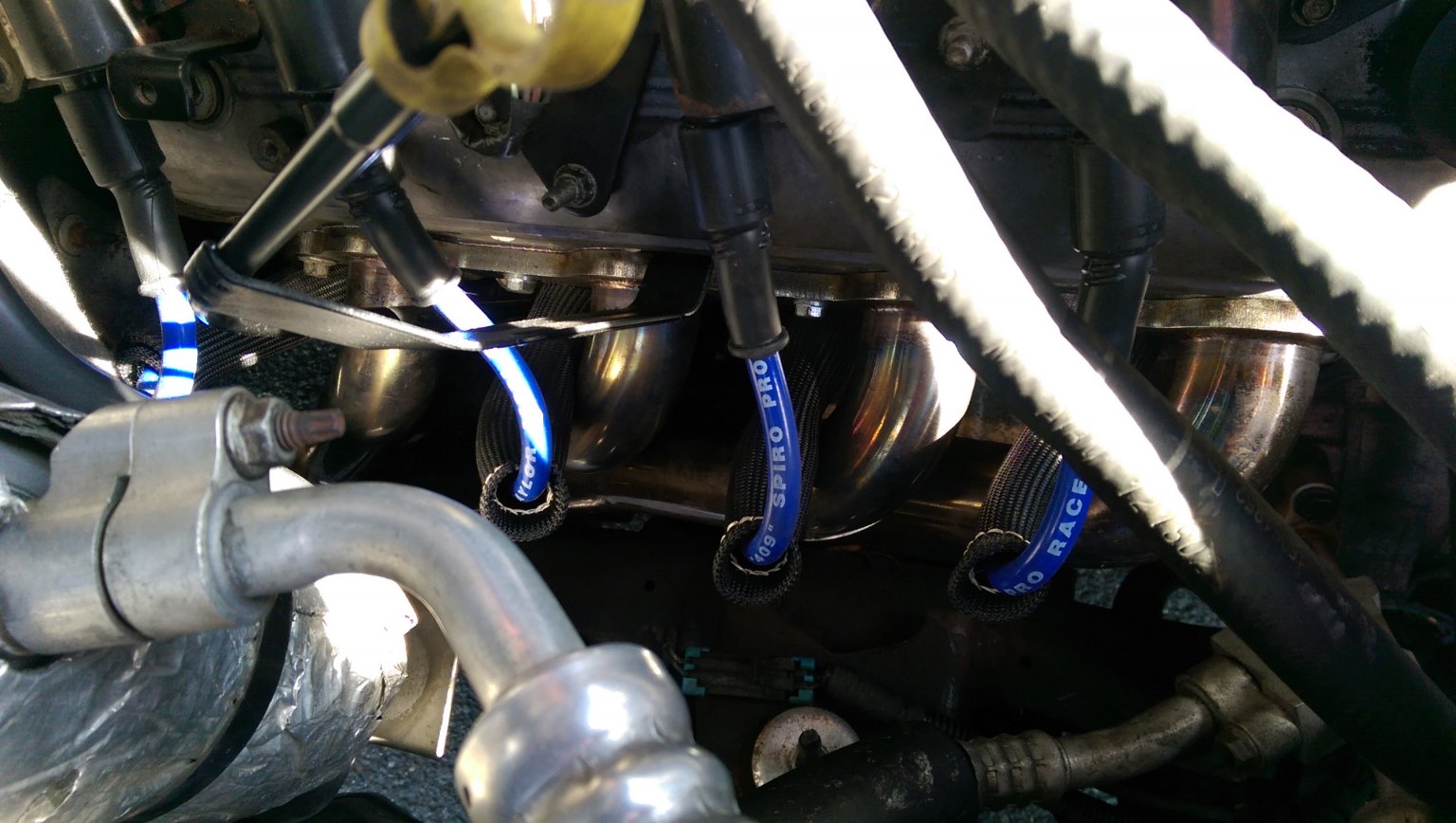

I had to go with racing plug wires, headers burned a few boots on the stockish wires. Boots we're too long.
