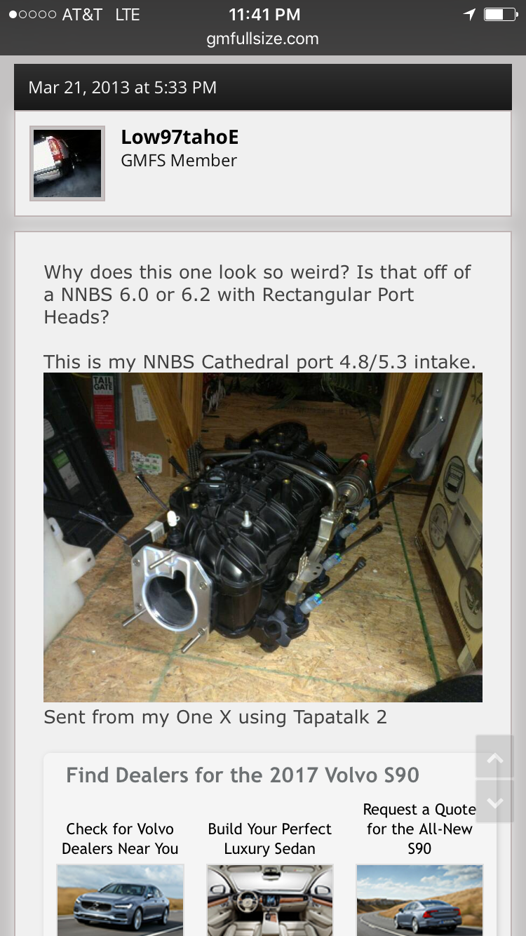

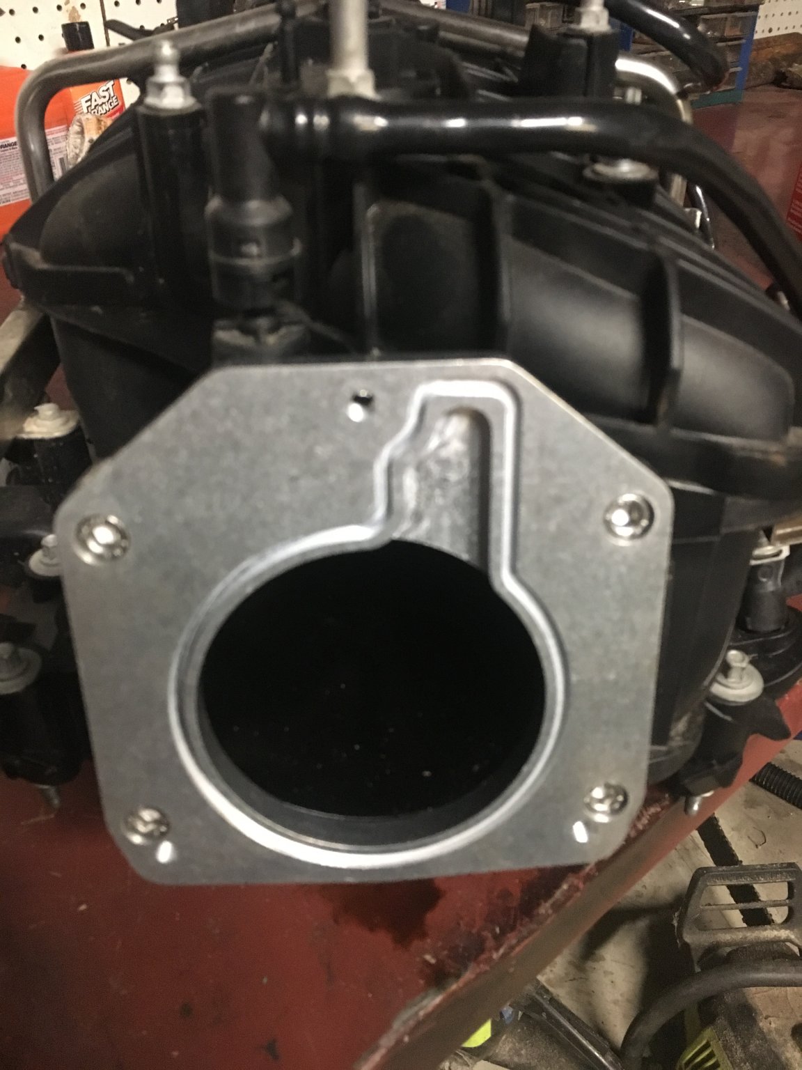

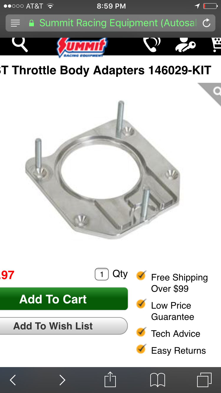

I'm stuck. I'm ready to throw this damn intake in the garbage. Fair warning this will be a lengthy rant. I've had this mother******g intake on and off several times. The latest realizing I have the wrong adapter. Finally I said screw it gonna just order the $250 harness and be done with it BUT THATD BE TOO EASY! My Tahoe is an 01 which is usually dbc but since it has traction control (assuming) is why it's dbw and has the extra plug. So that fast adapter is the ONLY adapter I've found that looks like the back side of my throttle body/gasket. It's for a fast 102 mm which I doubt will work idk what the mm opening is on the nnbs intakes. If I order the x-link I'll still be screwed bc the throttle body that was on the intake only has one plug. I'm starting to question if this is worth 10-15 hp but at this point I'm $150+ into it...

I'm starting to get scared to do mine. I have to get the tbss tb tho, probably make it a little easier. Idk it's last on my mod list. Maybe never get to it

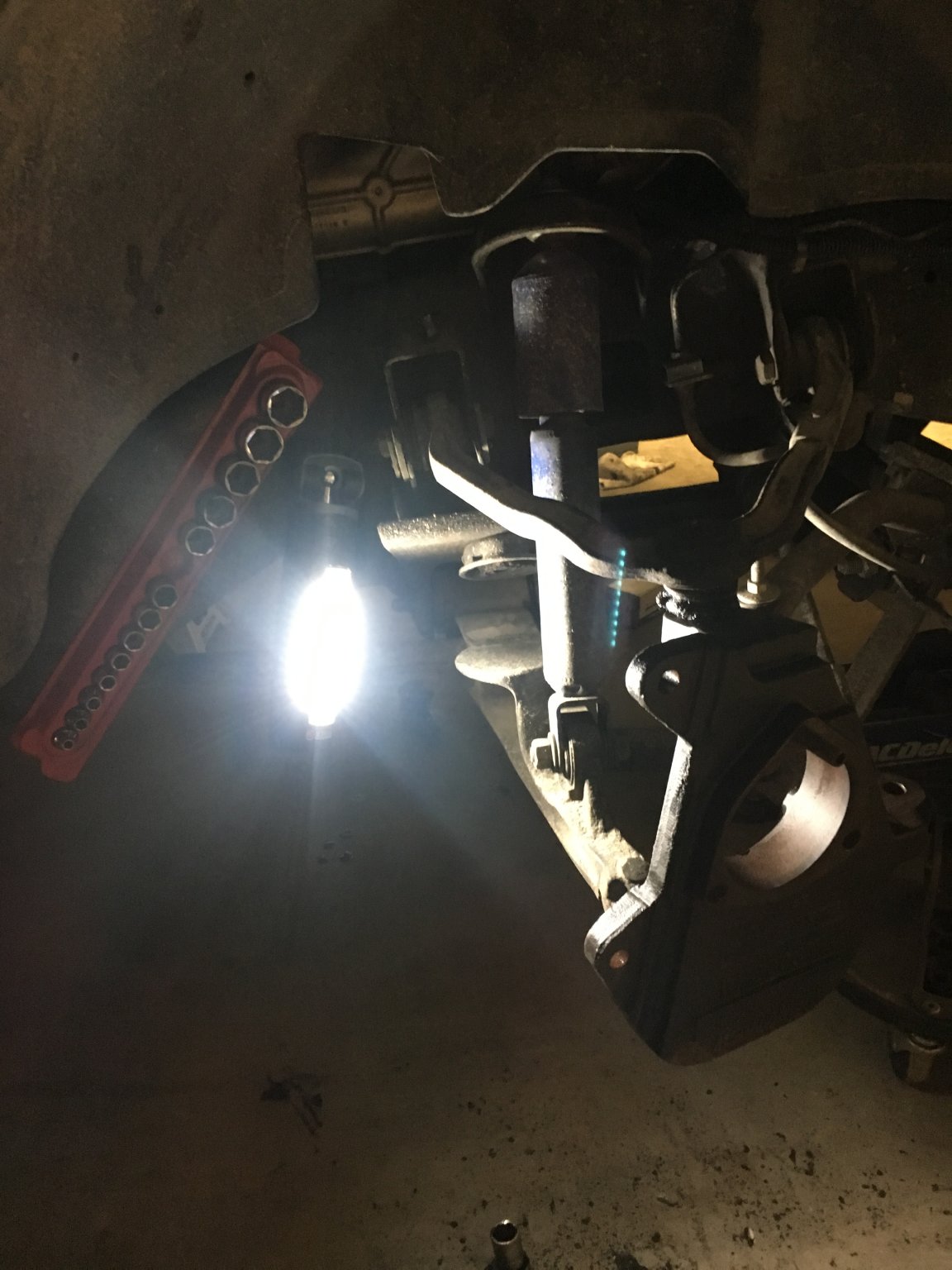

Picked up a set of mcgauphys drop spindles for $100. Went ahead and got them and the ball joints done tonight.
The ride improvement is great over the lowered keys, no more bouncing around. I ended up ordering the speed engineering long tubes and y-pipe. Really hoping not to have fitment issues like others, but we will see. After this Ima gonna take it easy and start doing more of the little things. I really need to get the ugly frame painted and a little maintenance stuff done.

Get the spindles new or used? I should've bought a set! Hopefully you won't have the same issues I have with my y pipe.
33,178
51,386
Doesn't come with spindles tho. After all the money I've spent on the motor mods, gotta stay on a budget. Seems pretty reasonable.

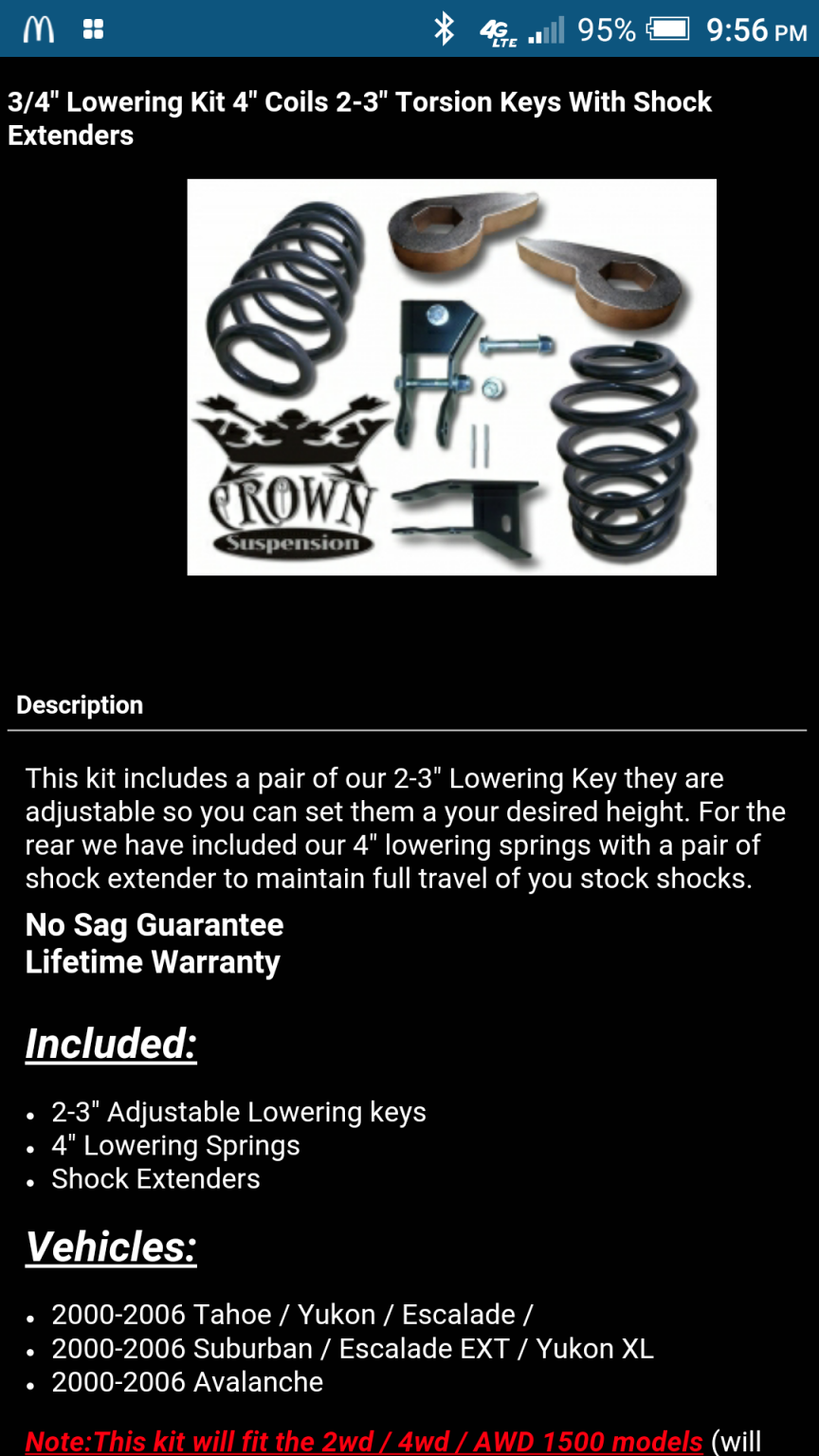

View attachment 76615 Doesn't come with spindles tho. After all the money I've spent on the motor mods, gotta stay on a budget. Seems pretty reasonable.
You are gonna be upset with that kit imo. Did you read the reviews? My buddy bought a kit for the rear 3" . It did absolutely nothing and took forever to get his money back.
