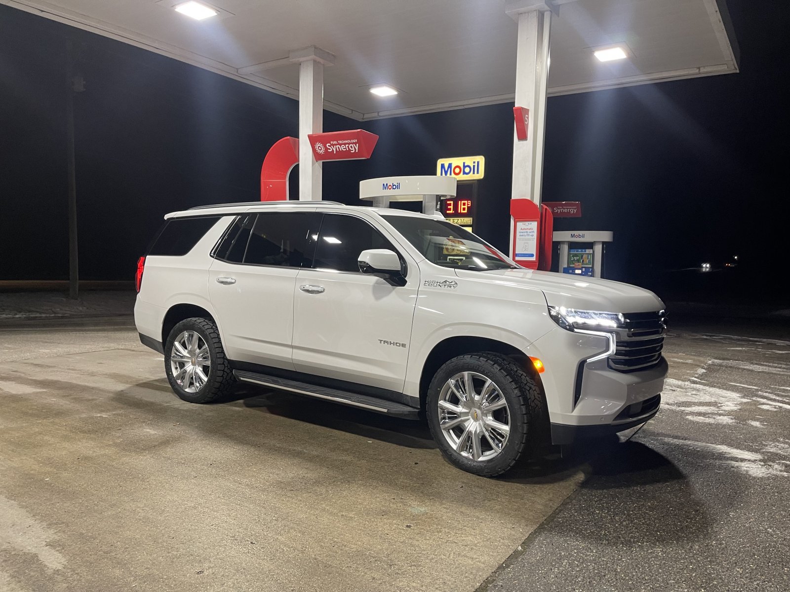

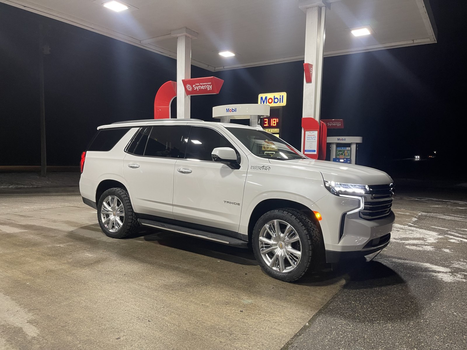

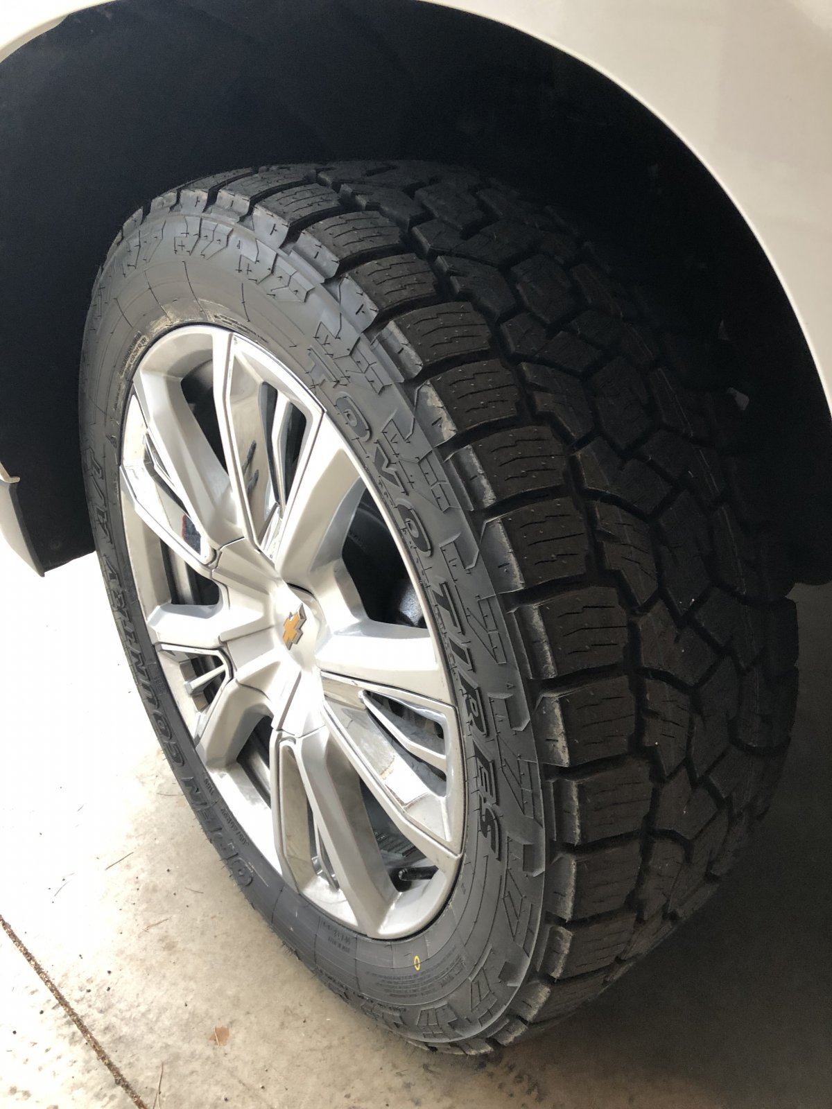

They should fit, they are only about an inch taller, so if you have a half inch or more of clearance with the current tires you should be good. 305/45/22 fit well with no rubbing, and there are several at’s in that size.
olyelr
Mar 19, 2011
1,779
898
Elk Rapids, MI
I put the toyo at3’s on my wifes high country. 305/45/22.
