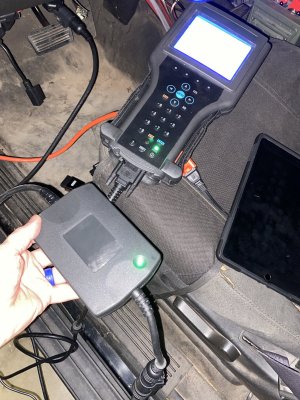

My tech2 does that too. I found its the connector between it and the longer cable. I have to work it together really hard.
Which one, right connector right at the unit, or the one on the right side of the candi twit in this pic.
