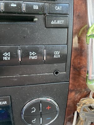

Put what will it attach the phone to?
From the aux jack to the right of the radio to the headphone jack on your phone or using a headphone to lightning cord adapter if your phone doesn't have one. (I am assuming you have an iPhone.)
No aux jack by stereo. Only sockets and a headphone jack for middle console radio for 2nd seat (behind me, so not sure how that would work and not sure if headphone jack same)

do you get any response? Mine had the fuse pulled. added fuse, paired it, noticed clipping, unpaired it.
Yeah it responds, just won't let me do the "pair" option. Just asks for a phone number to call.
