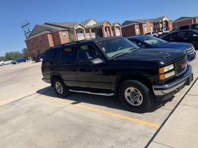

Hey guys! Newbie here! Had my ol reliable 99 Yukon for a few years now. And found this forum! New to tinkering on cars, usually able to do mechanics myself if it needs it! Any suggestions on a Yukon with 245K on the clock?

Welcome to the forum from Oregon. As has been asked, pics. Where is Derby, Kansas?
