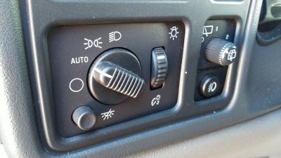

Last night I had a hard time seeing the dimly lit switches on the door. ( window & seat adjust panels)...
Also the panel for the headlight switches on dash are dark. Common sense tells me they should be lit.

It appears the headlight switch box has just a bulb.....( I need to learn how to remove it)

You know directly to the right of the headlight switch there is a dimmer for all of your interior lights, right?
That's a great common sense question...... My answer is..... yea... other little lights are bright.....
Armrest/window switches are very dim. Headlight component is not lit ( I think it's just a bulb replacement)

In the rear wiper / fog light switch I think there are two bulbs. One for backlighting and maybe another for the fog light button. I may not be recalling that right, though, it's been a while since I had mine apart.
EDIT:
I once bought some replacement bulbs from this place:
https://carradiobulbs.com/products/...kon-suburban-led-headlight-switch-light-bulb/
I did a couple of 4x4 switches and either the headlight or rear wiper switch.

Its a common problem for the plug to get loose at the headlight switch which cause dim or no back lights once the sensor on the dash detects "Night time".
