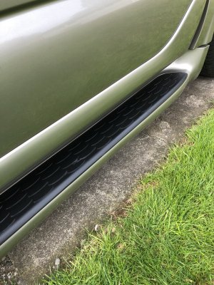

You could paint the running boards satin black with Krylon Fusion, I used it on all my black plastic parts. Holds up really well.
Might try that. I used some black trim dye on the bumpers but I am concerned about it holding up on the running boards. Also might use it as an excuse to buy some black powder coated tube steps!
52,949
Here’s my running boards after 3 years with Krylon Fusion. I just treated them with Chemical Guys trim gel and they still look new. The paint has help up real good.
