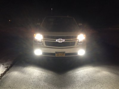

So I just installed an illuminated bow tie in the front grill of our suburban, just like this one:
Saw a few tutorials online before tackling it to make sure I didn’t have to tear the whole front end apart. This one video was very helpful, except it was done on a Silverado:
The part number for the black illuminated front and black rear 2015+ Chevy Tahoe and suburban is: 84518368.
The kit was around $250 and took me an hour to install with a flat head screw driver, 10mm socket, and a tapered drill bit to run the wires through the front grill. The kit came with the wiring harness to plug and play into the drivers side headlight. Just had to zip tie it to the front end and route it up to the front emblem.
I got a quick picture this AM, but I will put more up once the truck is clean and It is dark out. It’s kind of hard to see in my garage because of the background light. It looks sharp though!

I have an illuminated bow tie as well, but an having issues finding tutorials for a 2018 Z71 install. Plenty out there for Silverados, but my grill setup is not the same at all. Best I can figure is that I have to remove the whole front bumper assembly as opposed to just the grill, due to the differences in the way it is mounted. Anyone have experience with this?

Was wondering what year your ride is. I have a 2018 Z71, and I can't figure out how to remove the grill as opposed to the entire front end.

Can't remove the grill on these things without removing the entire front bumper cover unfortunately.

I didn’t remove my bumper at all. The large front cover plate once you open the hood is all you have to remove to get access. Just remove the dozen or so push clips and remove the plastic cover. It is a little tight sticking your arm down in between the grill and the hood latch assembly, but it is totally doable. You can reach down and release the stock emblem, then drill out the hole needed for the wire on the illuminated one, then feed the wire through the hole and snap the new bow tie in place. I zip tied the wire every 10” or so and routed the wire over to the drivers side headlight area where it is a plug and play setup online with the drivers headlight assembly.
Good luck!
