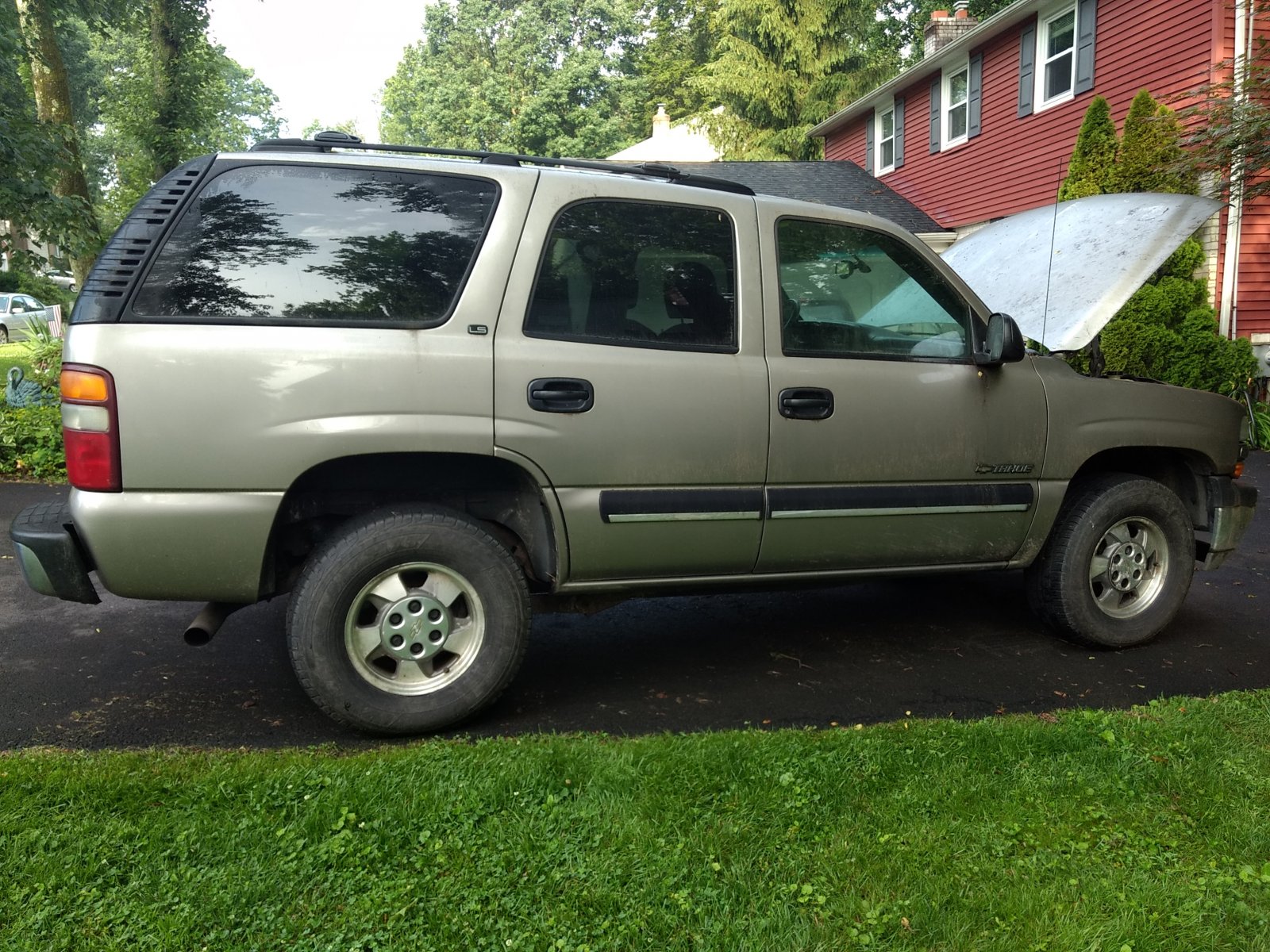

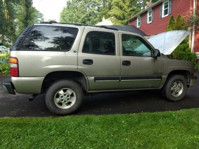

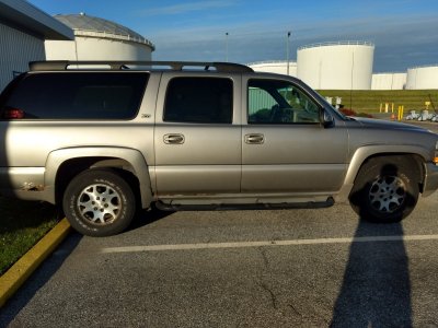

Wow duh. Until I posted these pictures I didn't realize the difference in the rear doors. guess that answers my door panel question. I don't have the Tahoe home yet so couldn't compare.

Your roof racks will not switch over either. They are too long for the tahoe. Also the mid row and third row seats I believe are not interchangeable as well. I know for sure the third row isn’t because it is different design. The third row seats in the tahoe are split and fold separately where the third row in the burb is a bench and folds all together. It also mounts to the floor differently. Your front seats will switch however I’m not sure there are wires for the powered and heated seats from your burb.

aa you noticed with the doors with your pictures and the previous comment made about mounting points and vehicle length alot of the interior past the front wont be a direct swap. some of it can me made to fit aside from the passenger door panels. but how far are you willing to go to make a smaller Tahoe feel like your suburban. if you pulled out the headliner in the Tahoe and punched new holes in the roof and sealed the old roof rack holes you could swap that. same idea with seats but if your not handy with semi serious body work it wont come out as nice as you want. you could just end up with leaks and spots rusting faster than they should. swap your engine and part out the rest of the suburban and use those funds to get some of the things you want on the tahoe.
