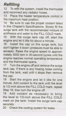

@Matahoe, this purge sequence worked great for me when I replaced my water pump, thermostat, and some hoses. I did it on level ground, although I have heard that having the radiator higher helps to purge air.
