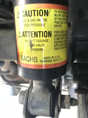

Thanks Tony,
Been trying to upload pics to IMGUR, but IMGUR isn't working(>)
Anyway...there's a big yellow label on the shock that says "SACHS" and what looks like a part # TXU and then 15029588. So...that can't be the right shock, can it?
So...they may have tried using these shocks without changing the springs (maybe they didn't know from ZW7)...or they may have changed springs and shocks too?
When I got the tires, the guy said the rear shocks were shot...and it is a bit bouncy on the road...doesn't feel like a firm, secure ride.

I think those are the Nivomat shocks--ZW7. They have internal springs. Really stiff, that's why the ZW7 springs are soft. I swapped mine out when I lowered my 03 with around 275,000 on it. I don't know if they were ever swapped out, but I weigh 240 lbs and I couldn't compress them at all. I originally swapped just the shocks with regular KYB shocks and left the stock springs. At highway speeds it was a scary ride. The rear swayed side to side. If you swap the shocks, do the springs too.

Found a pic of mine, from my 03 Tahoe with ZW7.
Same part number as yours.

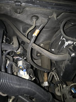

And there’s this wire, attached to the firewall, that isn’t connected to anything. Just kind of hanging there, Any idea what it is?

Steve - that's a ground wire. The other end connects to a screw in the hood. You should see it just about directly above the end that's already connected in the picture. Sometimes those wires get brittle because of all the hood openings and closings, but yours looks like it just came unscrewed from the top. You might find that the nut that holds it onto the hood is missing, too, since it was just dangling there. You'll have to pick up a new nut from the hardware store if that's the case.
