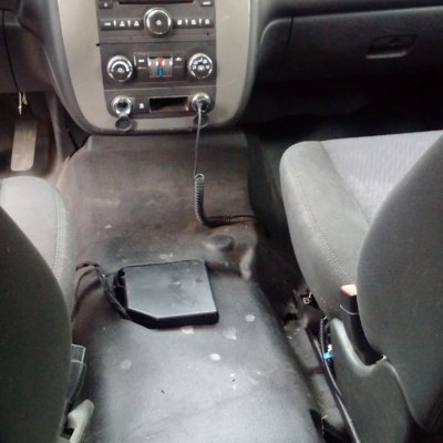

The Ppv/ssv units are not wired for a center console. In mine I just powered up the 12 volt outlets using a fused battery feed
There is a pig tail that is left there at the factory. It is for the power to the center console. You have to fish it out from underneath the flooring, which is easy. It's located around where the roll over sensor is on the floor board, directly underneath the center console. Just fish around, you'll find it.
I noodled around for that harness TWICE and came up empty-handed. I'm guessing it was rolled up with the upfitter's harness when they retired the truck, so it's a batch of cut wires up behind the radio now.

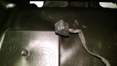

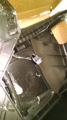

Here's what I found under the rubber "carpet" when I installed my console. It is hiding somewhere near the roll over sensor, I suspect it to run back to the front "somewhere". I also attached a pic of the connector that I found in my console, and.... it does not power the cigarette lighters.
Also: Does anyone know if it is easy to take the tray out of the center console after the console is installed? I want to try and see if I can disconnect the first part of the wiring harness, that connects the rear (in my case the harness was actually cut).

So the top plug is the one I fished out from under the mat. The bottom plug is the one from the harness. Which would be the correct male plug for the female with the red n black wires? I figure I would just get the correct plug to this one and make my own harness to power the cigs...
