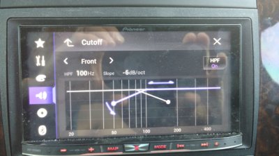

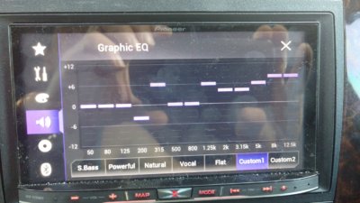

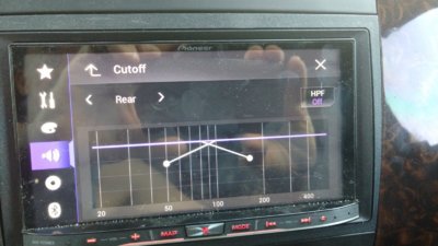

The bluetooth connects in and out for like half second while playing music through bluetooth.the eq isnt the best but it works. Im running it through the stock amp so idk if thats what i have to change to get it to sound better. thats about my only gripes at the moment. Ive had it for 2 weeks.connected it to my google it has connects to wifi. But im thinking of getting a internet plan just for it. In order for it to have internet all the time for navigation,music and in case one day if the truck is ever stolen i could locate it with that too if possible. i use google maps. It came with igo. But i downloaded google offline maps. Not using igo.. i seen people root the android radios not trying to do that at the moment. Let me enjoy it before messing with it.
if your head unit gives you these options try these settings and see how it sounds with the stock amp, mine sounds decent with these settings on the stock bose amp

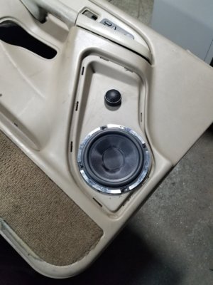

I did a system in my 05 Denali that I think you might be interested in. I bought a new double din head unit (a Dual, which I would seriously not recommend) and a scosche kit to interface with the existing Lux system for my stock speakers. I added a separate Boss monoblock amp to power an infiniti reference 8" sub I had been given for father's day. I added a backup camera and steering wheel controls. If/when the stock speakers give up, I'll look for a replacement 2 ohm set. The stock amp is fine for the stock speakers, and the sub bumps impressively enough to make my mirrors unusable at half volume. Now I have a head unit with bluetooth for my phone and music, a bumping sub that goes lower and louder than my stock sup, and backup camera.
If I were doing it again, I'd do the same for everything except the head unit. It's a serious piece of garbage that is getting replaced when I make up my mind about it's replacement.
