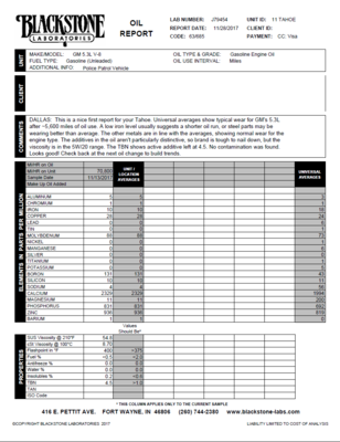

The Blackstone oil report just came in for the year-old oil we drained from the Tahoe after picking it up from auction. Good news!
P.S. I know that there is very little fuel present in the oil, but I wonder why the viscosity is so low? Perhaps this is an indication of a leaking fuel injector?
Edit: From Landline mag-
"A typical sample will not show positive fuel in the oil unless it is excessive, such as 4 percent or more. So, some fuel can lower the viscosity but not alert the fuel in the oil parameter and show the sample is normal. I recommend taking the engine in and checking the injectors when you first notice the drop in viscosity instead of waiting for the sample to show positive fuel. By then your viscosity is really low and causing harm to the engine."
Edit 2: I just placed an order for new AC Delco fuel injectors.
http://www.landlinemag.com/Magazine/2010/May/BottomLine/Oil-analysis.aspx
