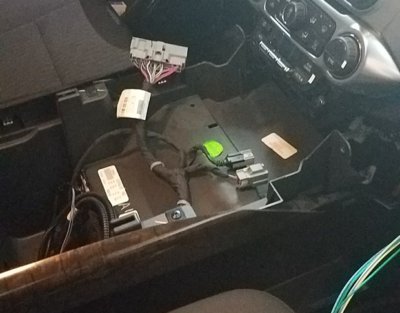

Cleaned up the Tahoe today. Washed and waxed.
Last week I had a friend of mine do some
Body work on removing the spotlight and filling the holes.
And one of the interior

Did you upgrade the steering wheel? (Audio controls)
And did you find the connections for the center console rear climate controls? Because I can't?

Yea it's a steering wheel from an LT.
And for the center console, no the rear climate control I have not hooked up. The harness coming down from the dash in a ppv is different than a civilian one. I have the basics hooked up in the console lighter and USB in front and rear.

How difficult or easy was the steering wheel upgrade? Was there new wiring or a new harness required for the audio controls?

Simple, there's a video on YouTube somewhere on a new Silverado, same steering wheel. It uses factory wiring
