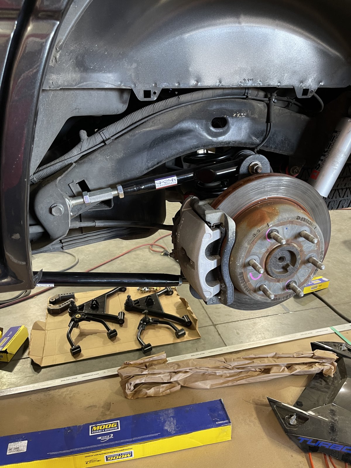

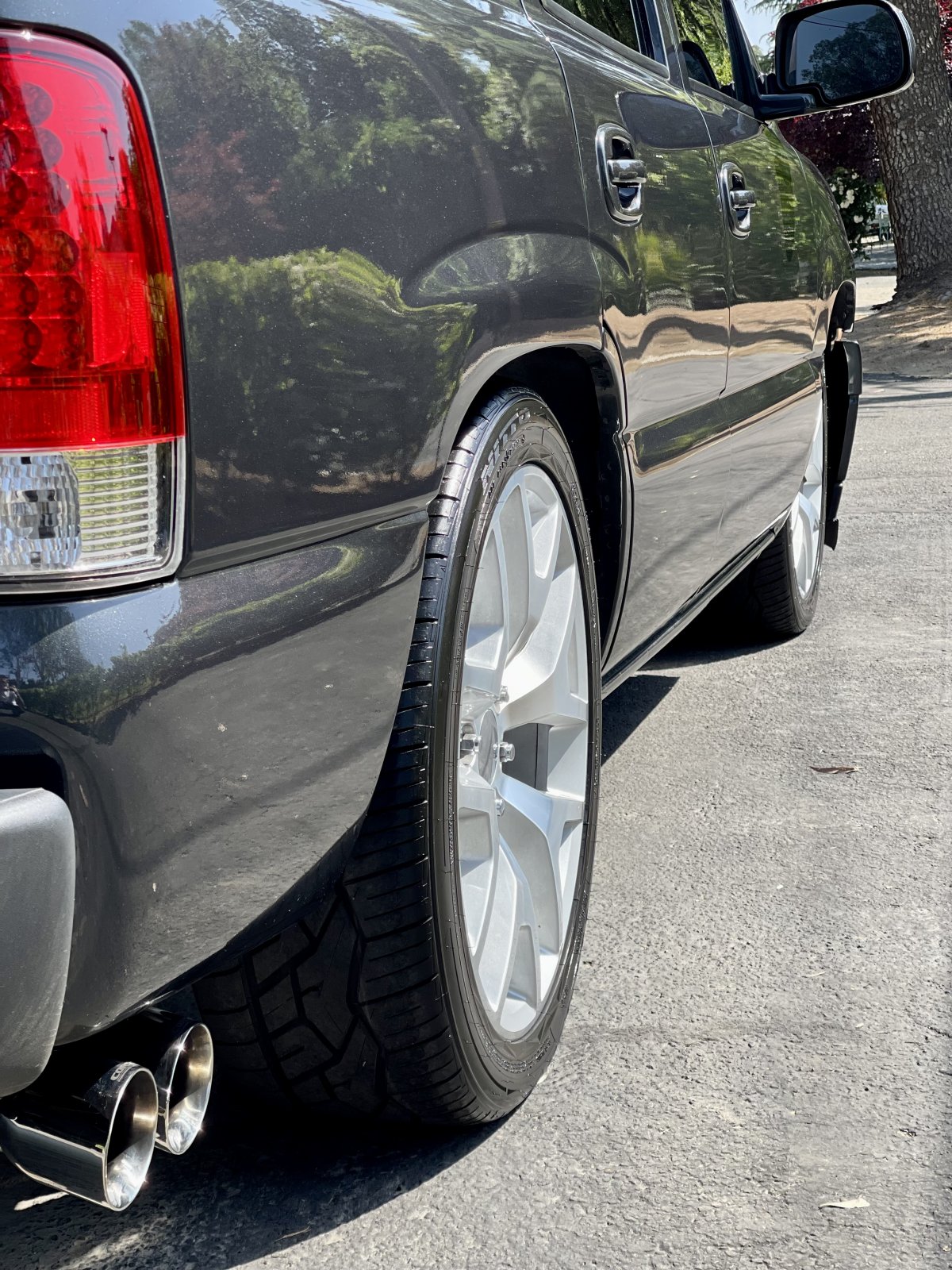

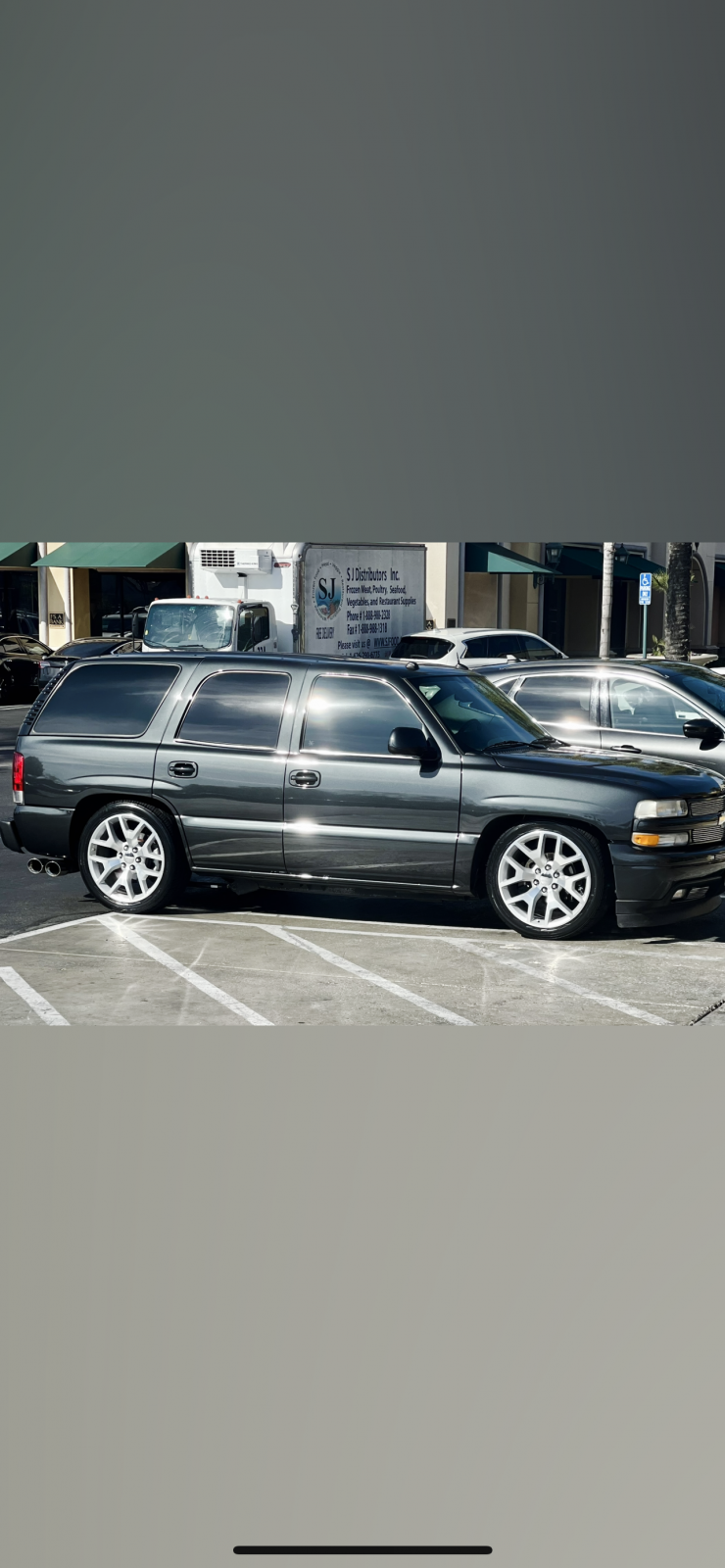

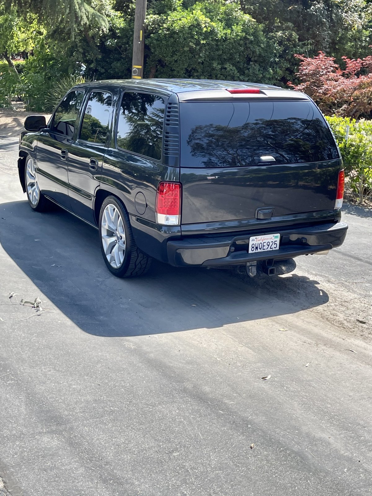

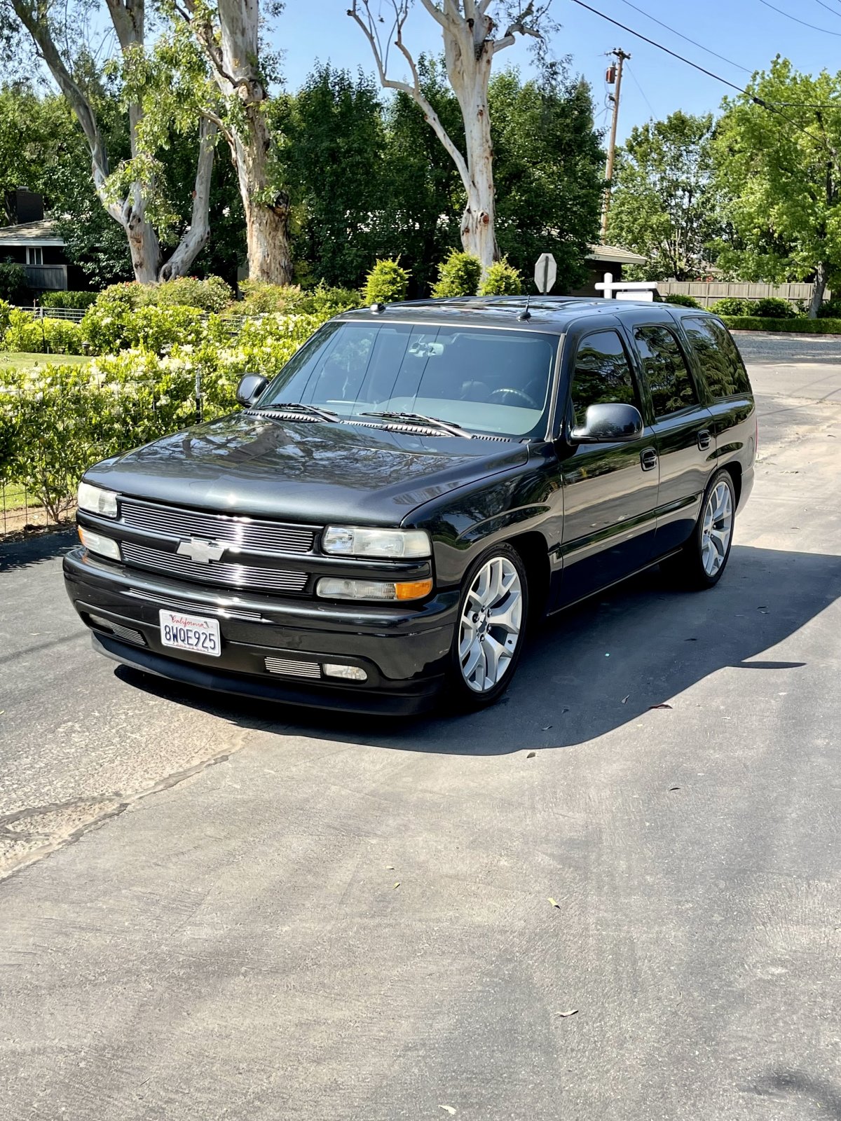

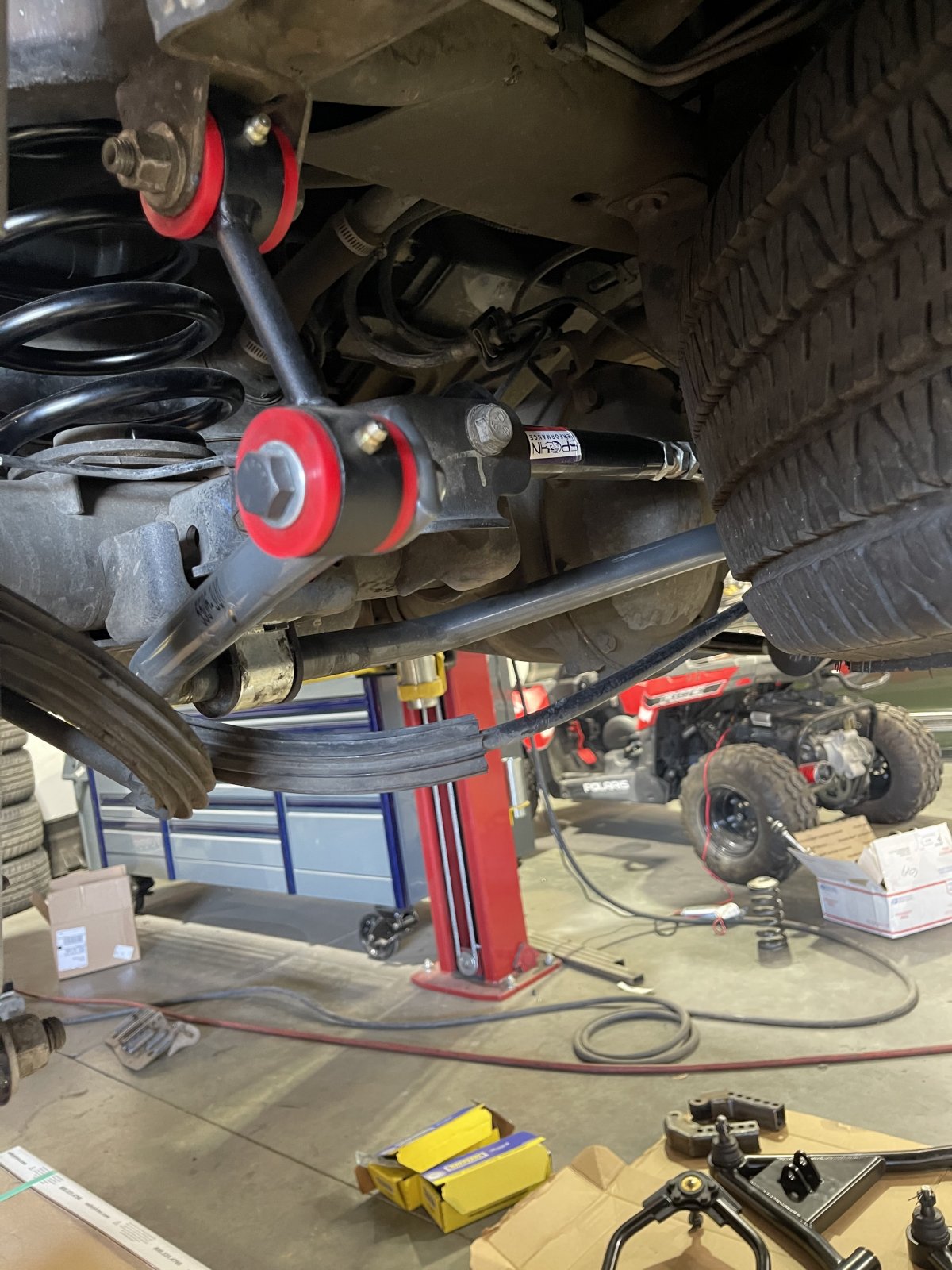

hardluck13
May 18, 2011
85
35

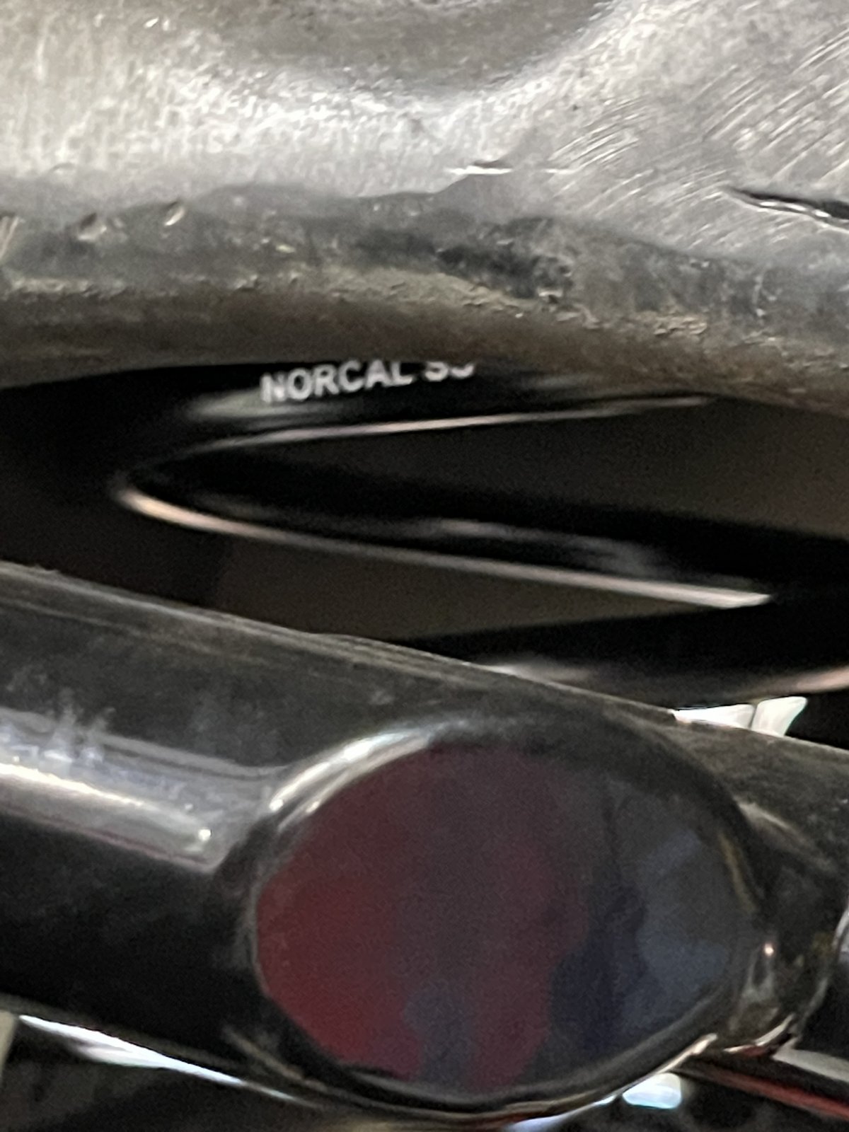

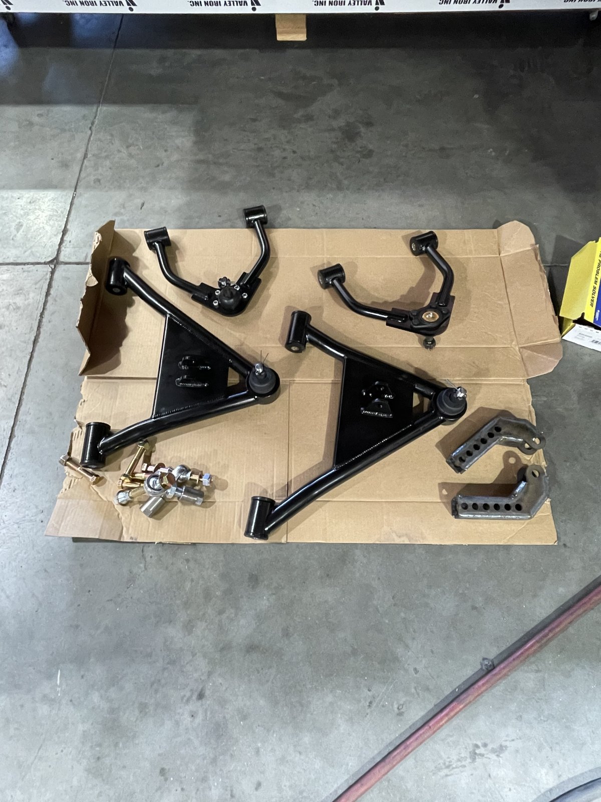

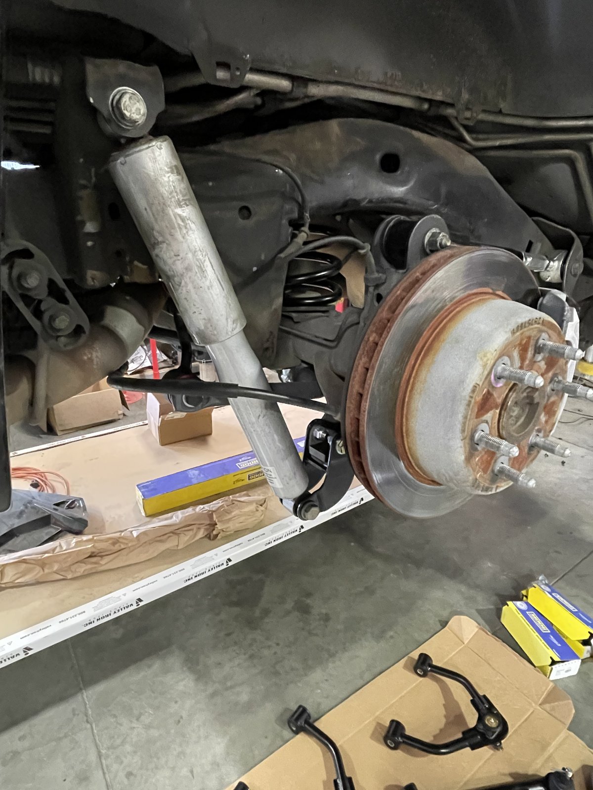

Sucks. I looked through my pictures and I’m missing a bunch like: the coilovers in front installed, these pictures are from running Tony’s springs in the rear and not showing coilovers in rear, doesn’t have the big brake kit on it like it does now. It’s also pictured without the 22x8.5 front billets and the rear 22x10 billets in the rear. I also did the free travel but after the coilovers in the rear I piped notched it so this thirsty Hoe never bottoms out. I hope it helps some.
One of my good friends Jacob (Stone Fab) makes the kit for the front.i was sponsored by Alden American on one of my race trucks so i stayed with them for this Hoe.
The only thing I wanted you to hopefully take away from it. Is the extra money for this is more than night and day. I’ll never go back to anything else. My (2) 2door 2wd Tahoes are on chassis with coilover kit from stone in the front along with four linked rears on coilovers. Only vehicles I don’t have done are like my new mega cab Cummins, my other 4wd pickups etc…. But I am building a reg cab 1500 phantom dually and that has the CO kit in the front it looks pretty cool.
