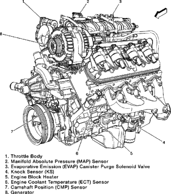

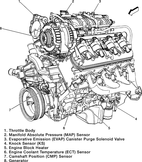

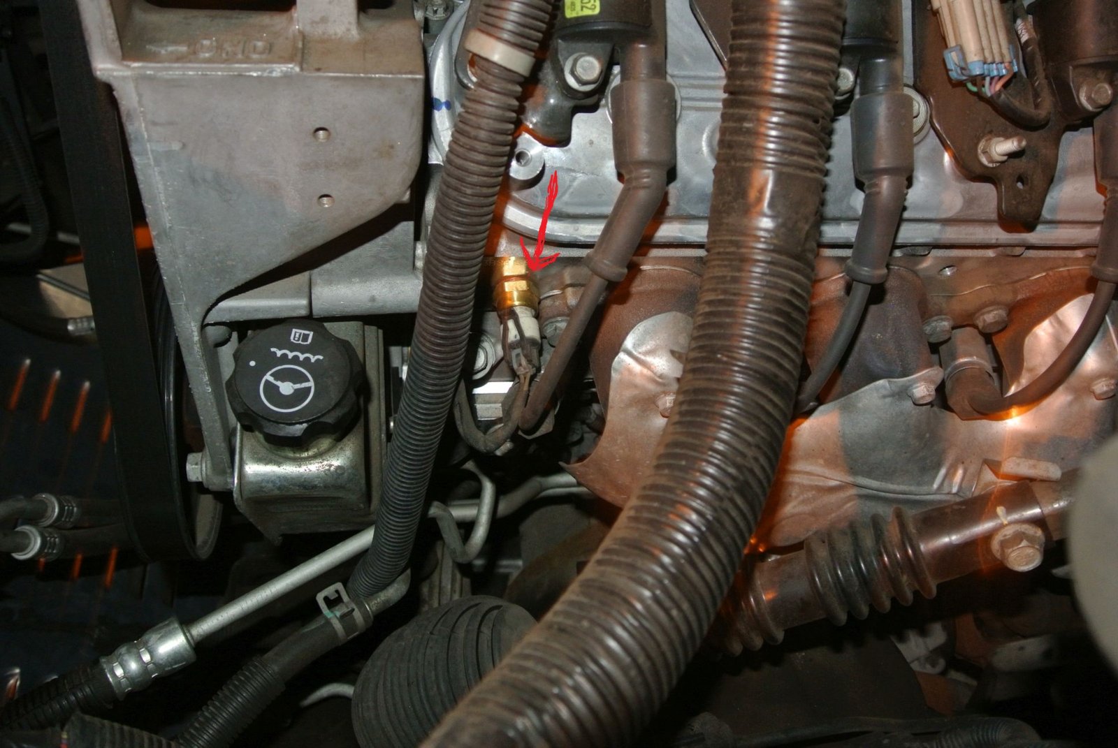

If the coolant sensor has gone bad, would it not read at all? Or just read incorrectly? If it's a cheap and quick thing to do I'd rather do that before pulling the thermostat and flushing my radiator. Looks like the sensor is about 15 dollars on amazon. This morning my heat seemed warm but not sure if that was just in my head since it was 40 degrees out.
