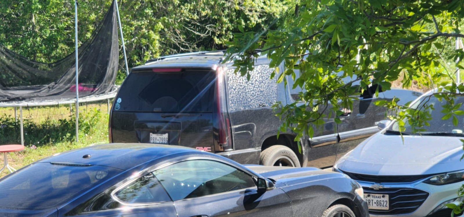

Sisters denali with 6.2 6l80e awd got hot she kept driving -_- had to pick it up from her work, limp mode only 3rd gear, kill it shift to manual it goes through all 6 ok cool get it home pull the codes solenoids sticking on 3-6 if i member right. Fluid burnt metal in pan i realized it was outta my wheelhouse as i dont even have a slab im still very much a lay in the sand n get er done guy but i cant rebuild a trans yet so i call a local guy, he says trans needs rebuilt and transfer case needs new gears as theyre shot 4200 with labor, he has it 3 weeks and we get it back with this,"now any trans shop is gonna tell you they dont cover electrical and i dont either". Red flag spotted. He does give me a 3000 mile or 3 month warranty though so im feelin better, 3 days later she calls its back in limp mode, have her limp it home as trans temp read 175 ran the codes same one 3-6 solenoid malfunction, and now crankshaft position circut malfunction(replaced sensor like 100 miles ago but didnt do relearn as im not a millionaire) cleared em fired it up and she took it from san antonio to coprus no issues that i know of, sorry but thats where im at and shes 13000 into this truck now, what should i do? And did he just get the clutch pack and **** me on the other internals? Id say yes thats how the 5600 job cost 4200 but he seemed like a decent enough guy need some advice lol pic of said shitbox for reference
