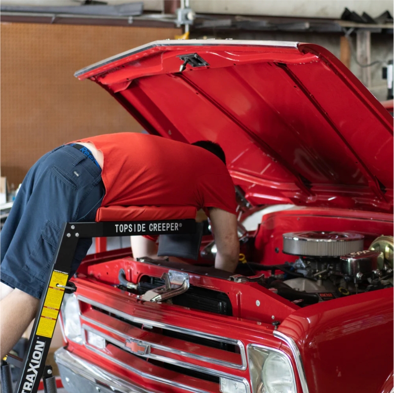

you guys need to invest in a top side creeper. it's way cheaper than surgeries. crap.

So I have a decent creeper, but you're gonna have elaborate on what an overhead creeper is. That's a new one for me, but a dang welcome one considering this circus! LOL

top side creeper I couldn't live without working on trucks/suv. you can find them for about 150$ from time to time..

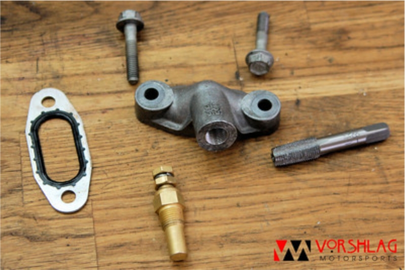

I'm dang tempted to put an NPT to compression adapter back in that hole and run a 1/4" copper tube around to the front of the engine with a custom bracket bolted to the driver's side valve cover to mount the stupid sender up there.

I've 100% wondered why they put it up there. there's at least 2 other places you could put a oil pressure gauge. the ls2 c5 had it above the oil filter I believe. but I guess with the afm being so oil dependent, it was the best place for it. I just wish they would have sourced better quality sensors. no other manufacturer I've ever been around has as many oil pressure sensor failures than a gm. and not just ls stuff, all the way back to the 90s gm struggled with failing sensors.. annoying at best.
