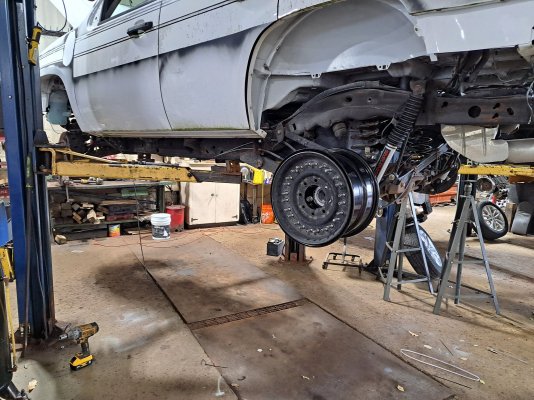

I have always collected and liked military vehicles. Most of which are not fun to drive daily. So i picked up a 2013 police vehicle out of florida with abot 40k on it and in the process of making look like a USMC type police veh.
I will post some pics and ex[lain how i did stuff as i go.
I statred with a 3 inch body lift and a 3.5 inch suspension lift.

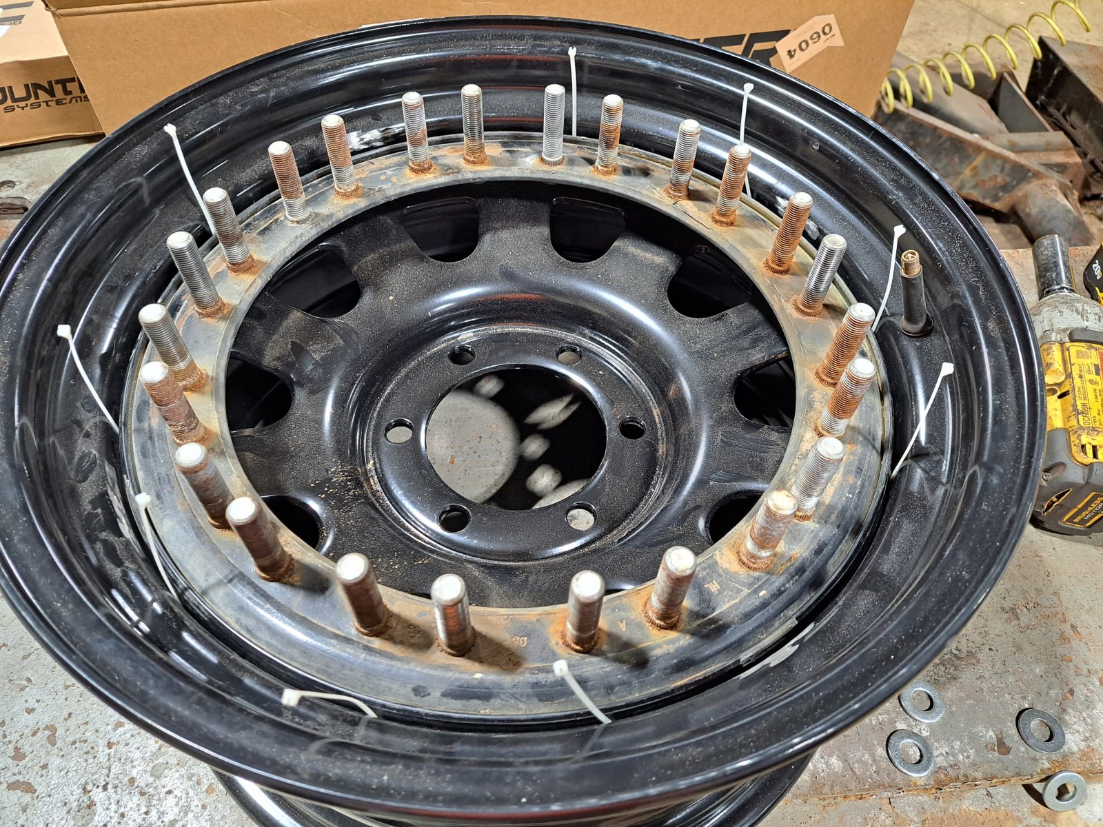

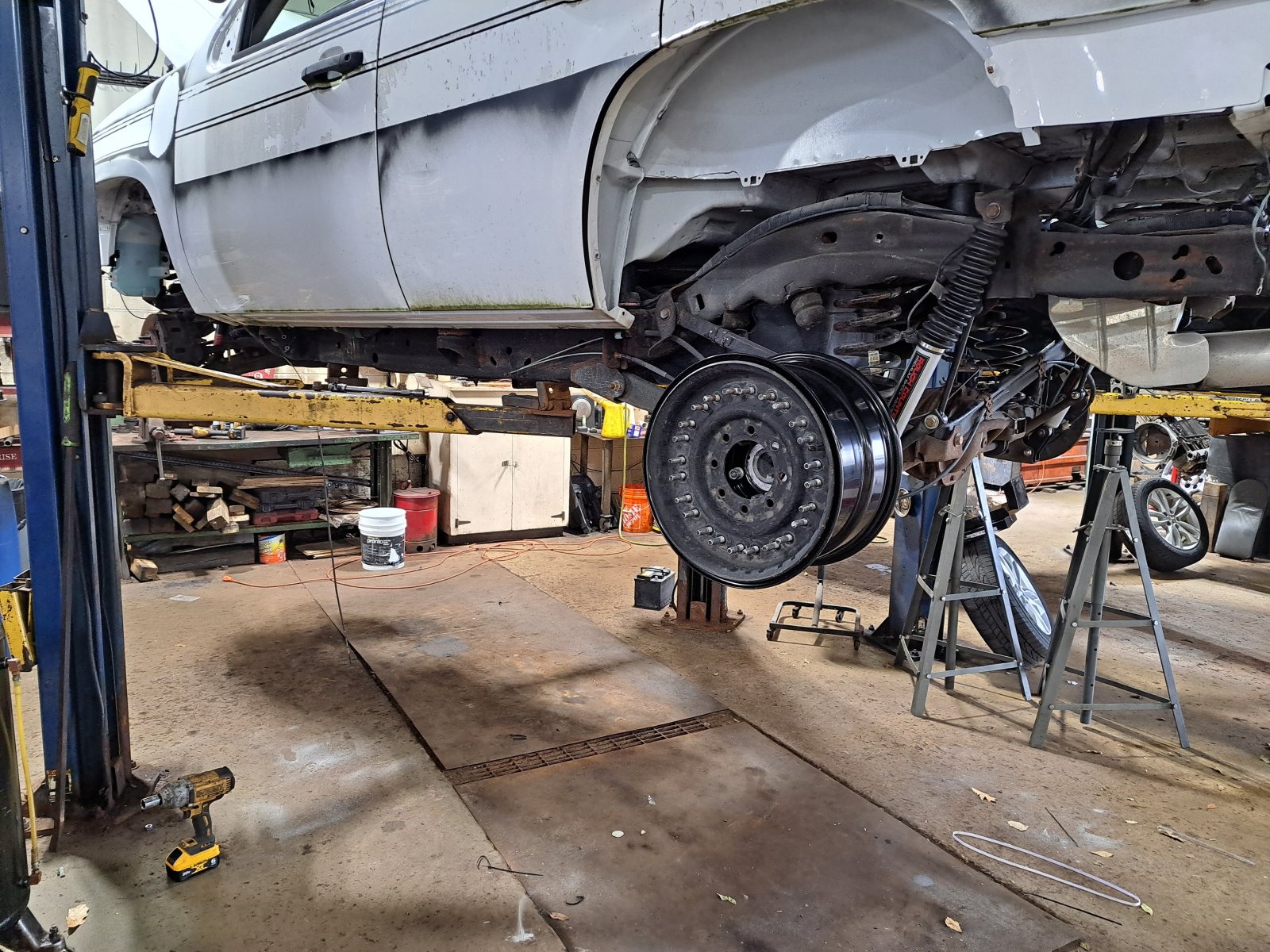

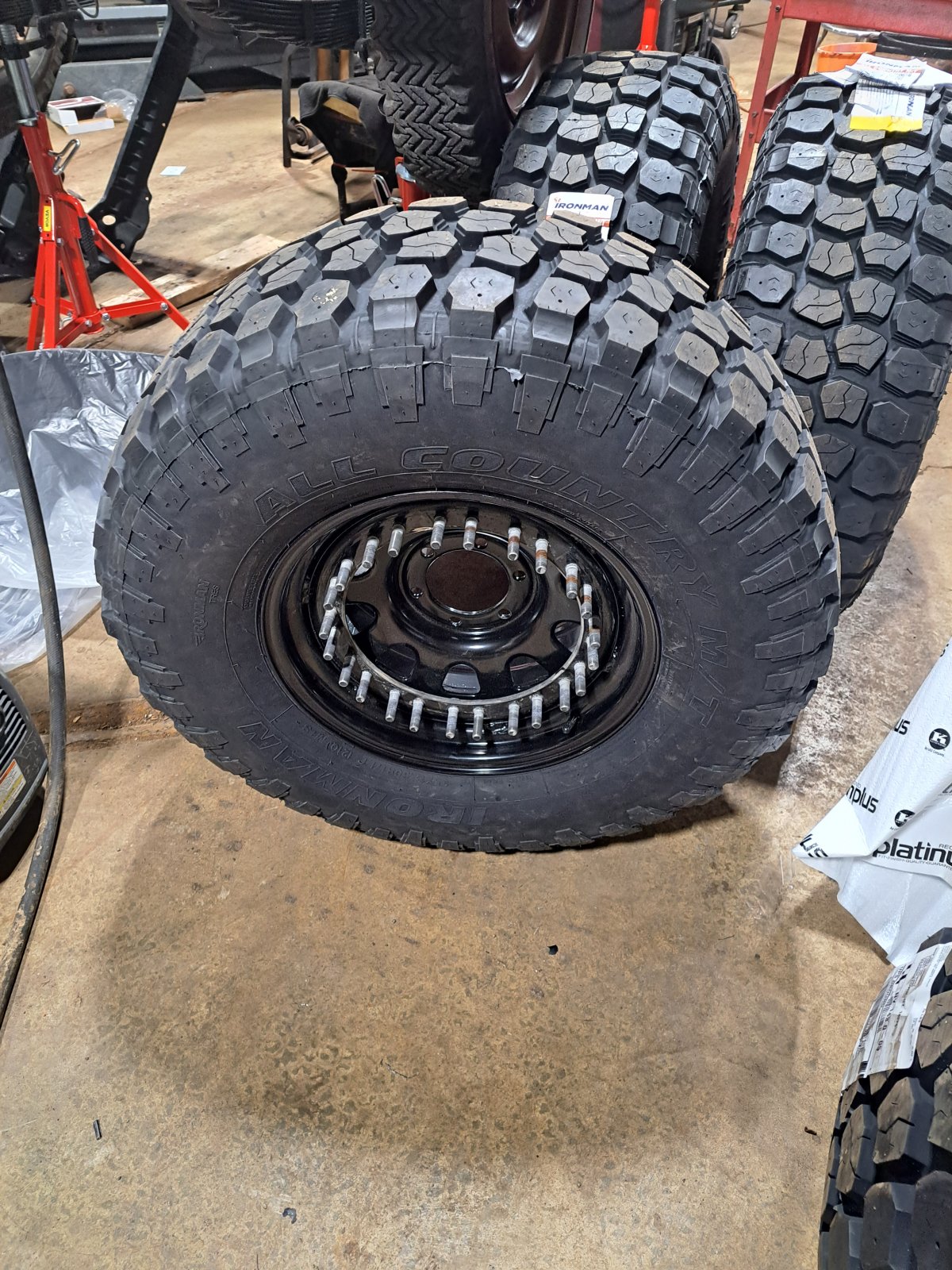

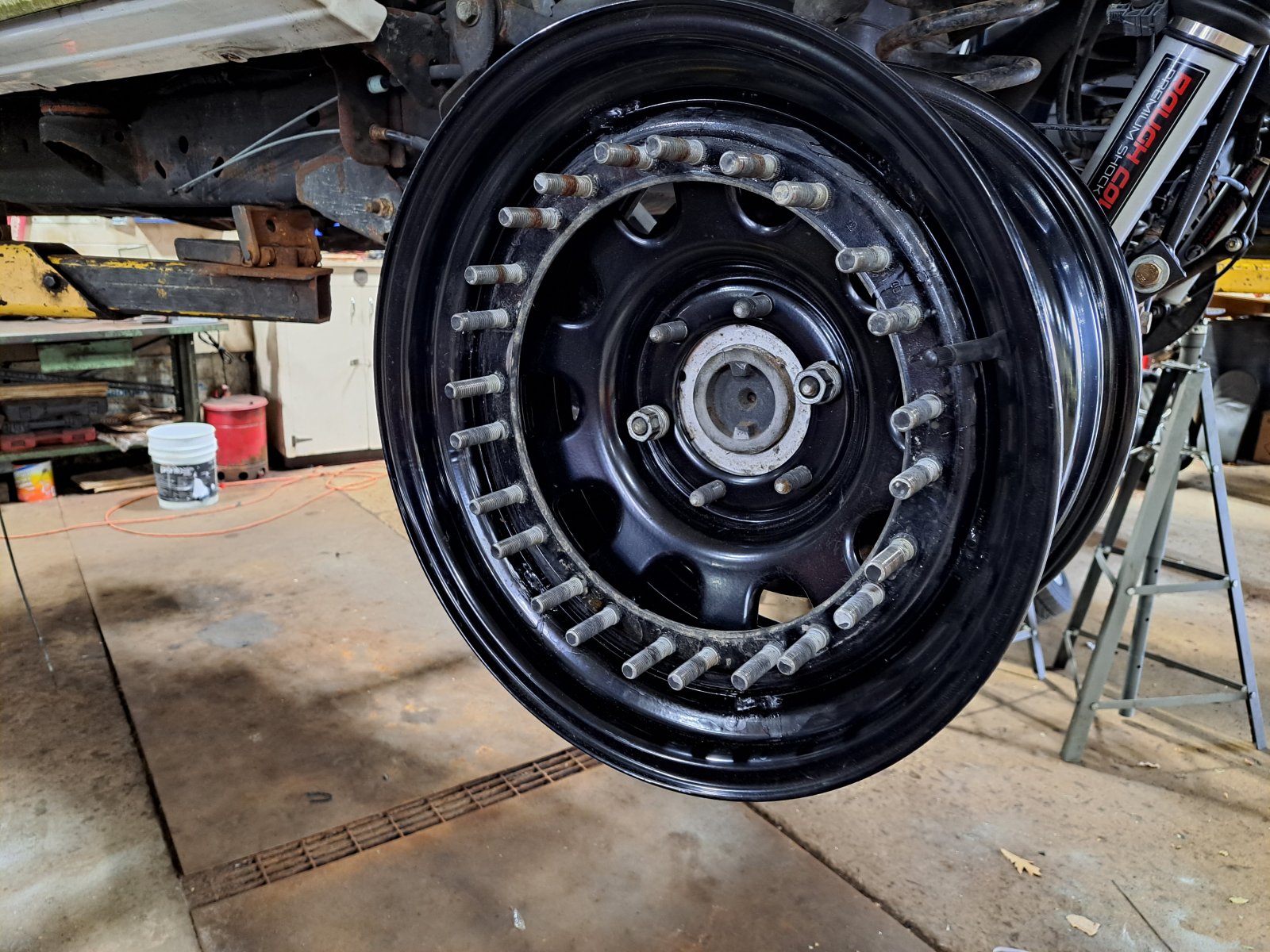

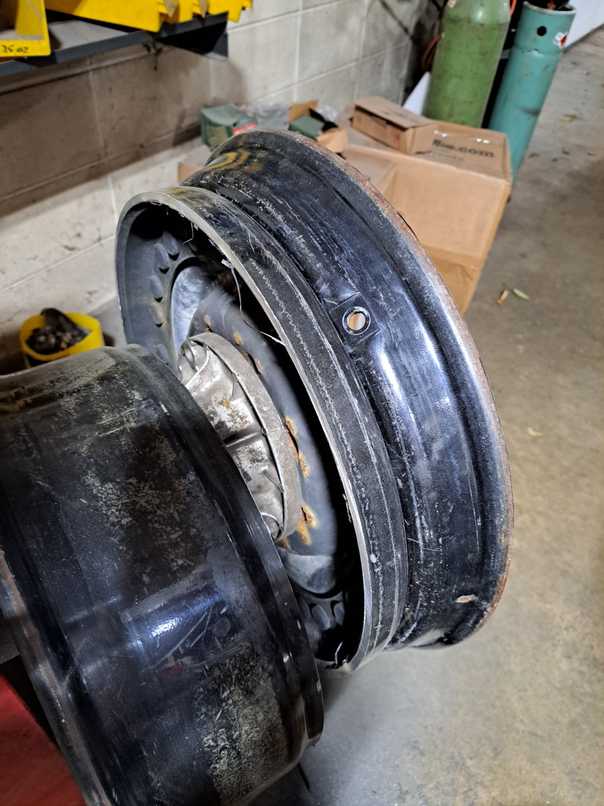

I converted RC steel rims to Hummer type it involved cutting and welding. I will utilize center caps and put bolts in the 8 pattern so it appears proper.

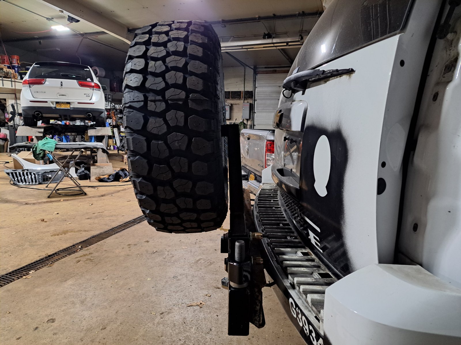

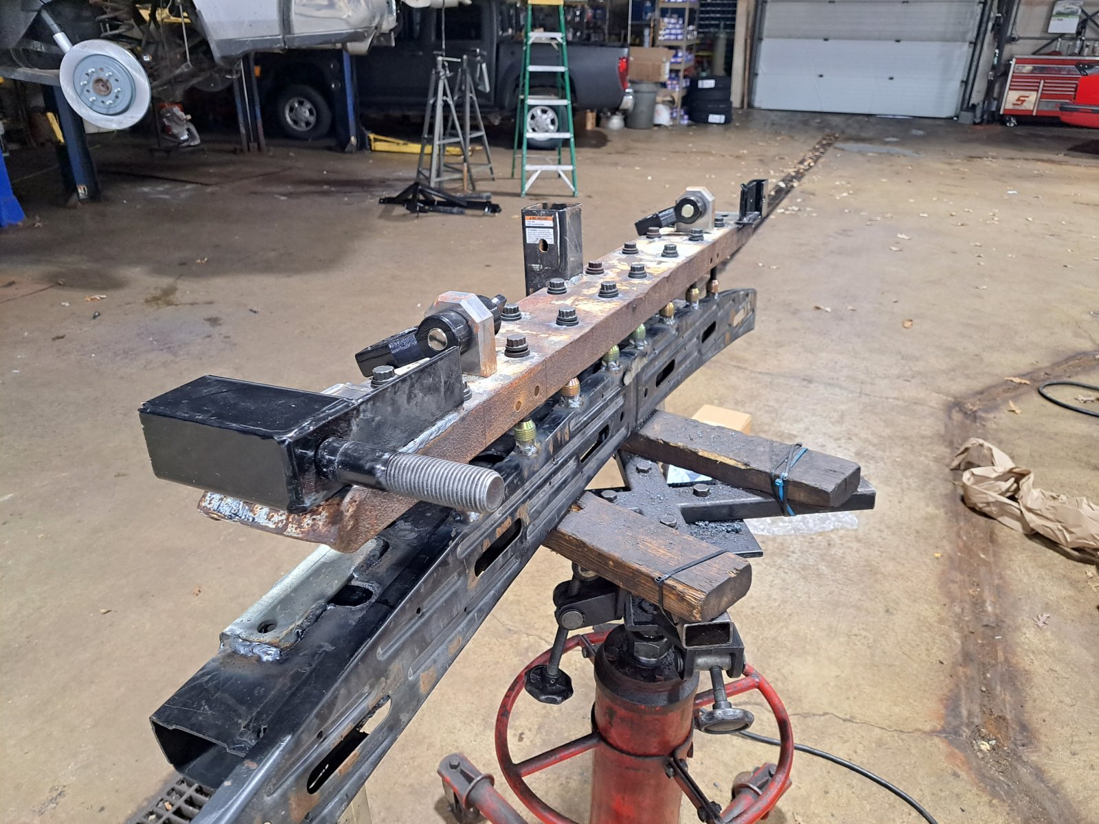

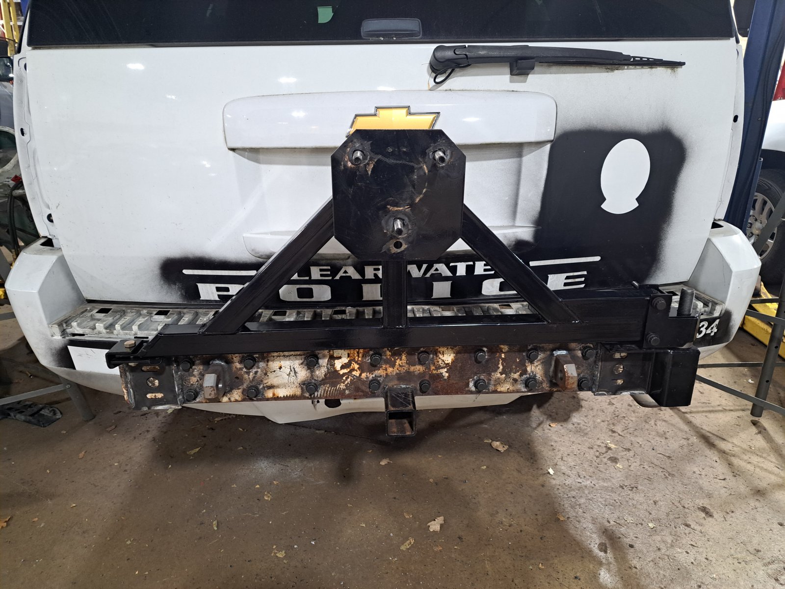

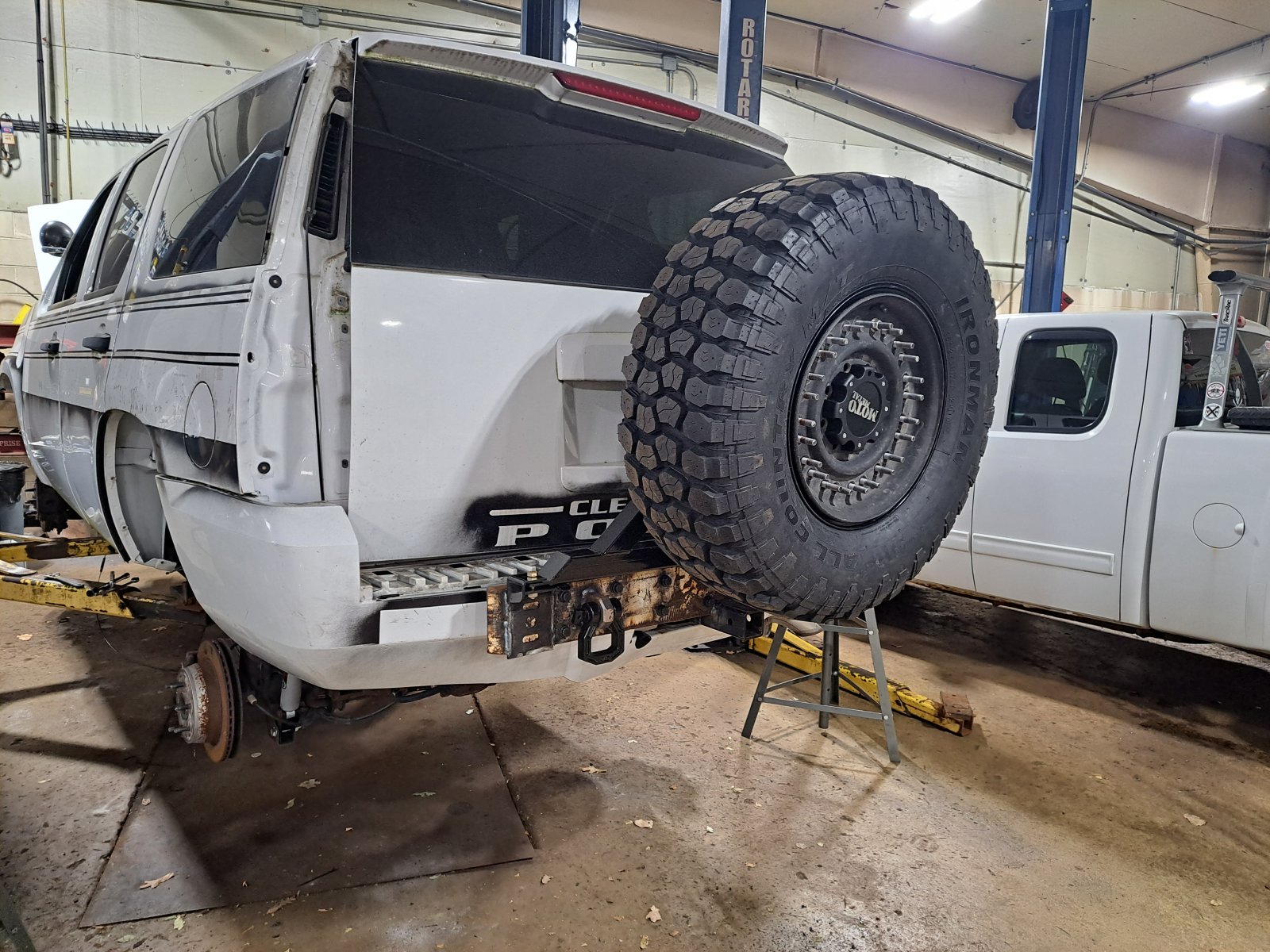

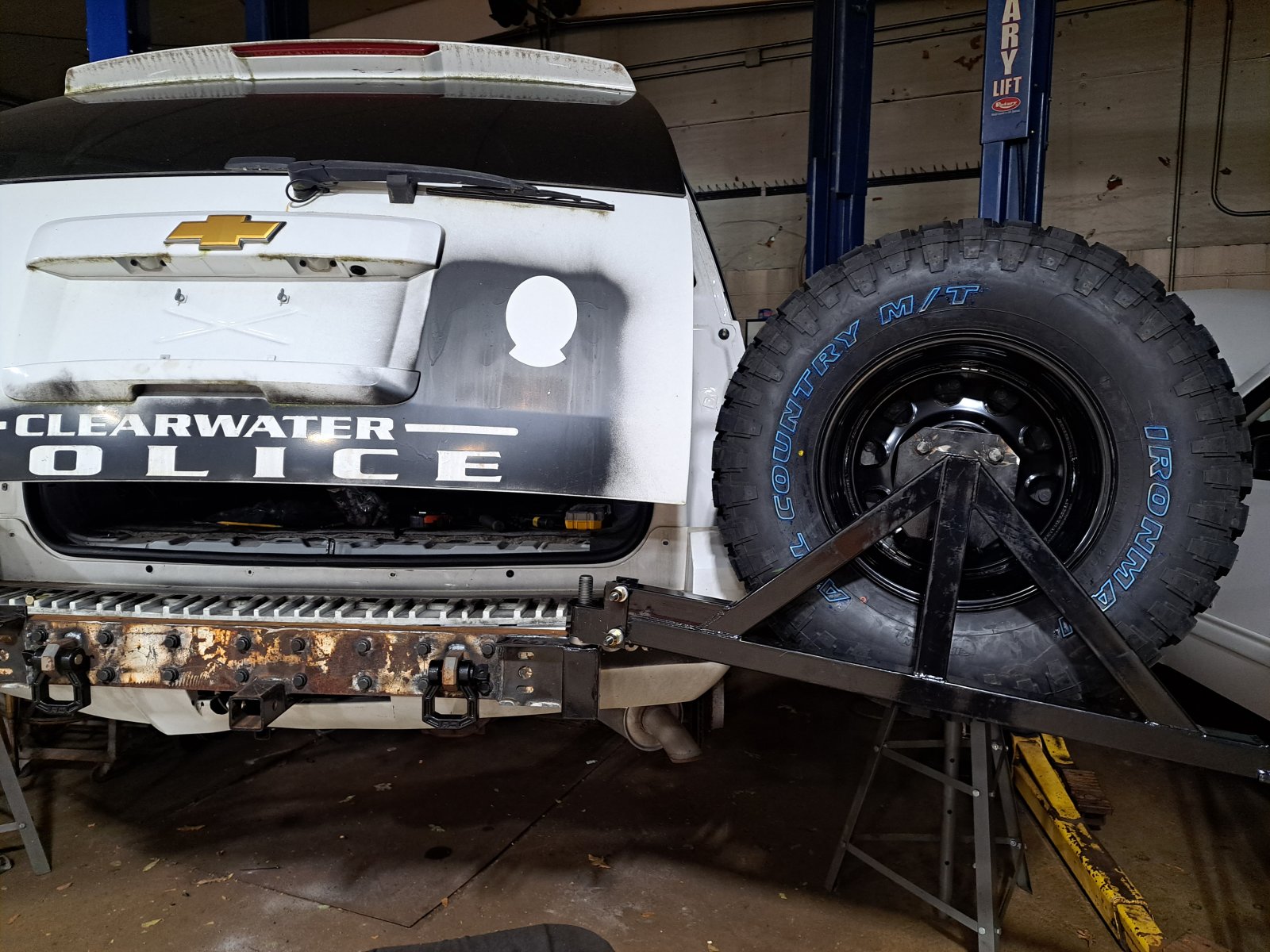

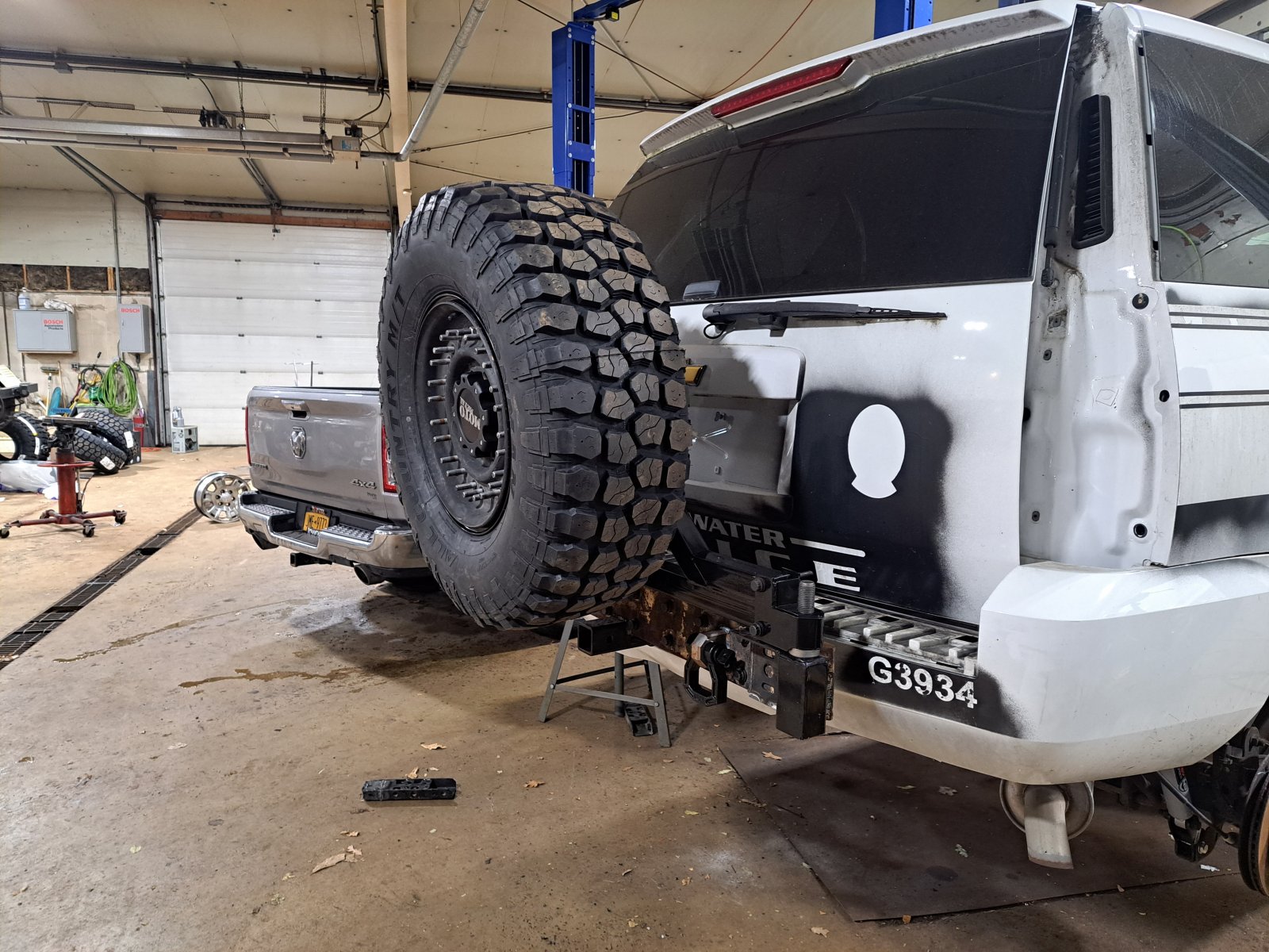

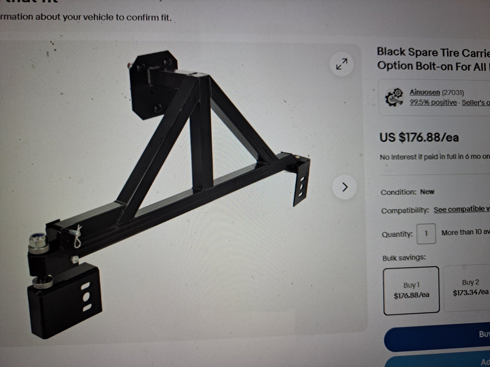

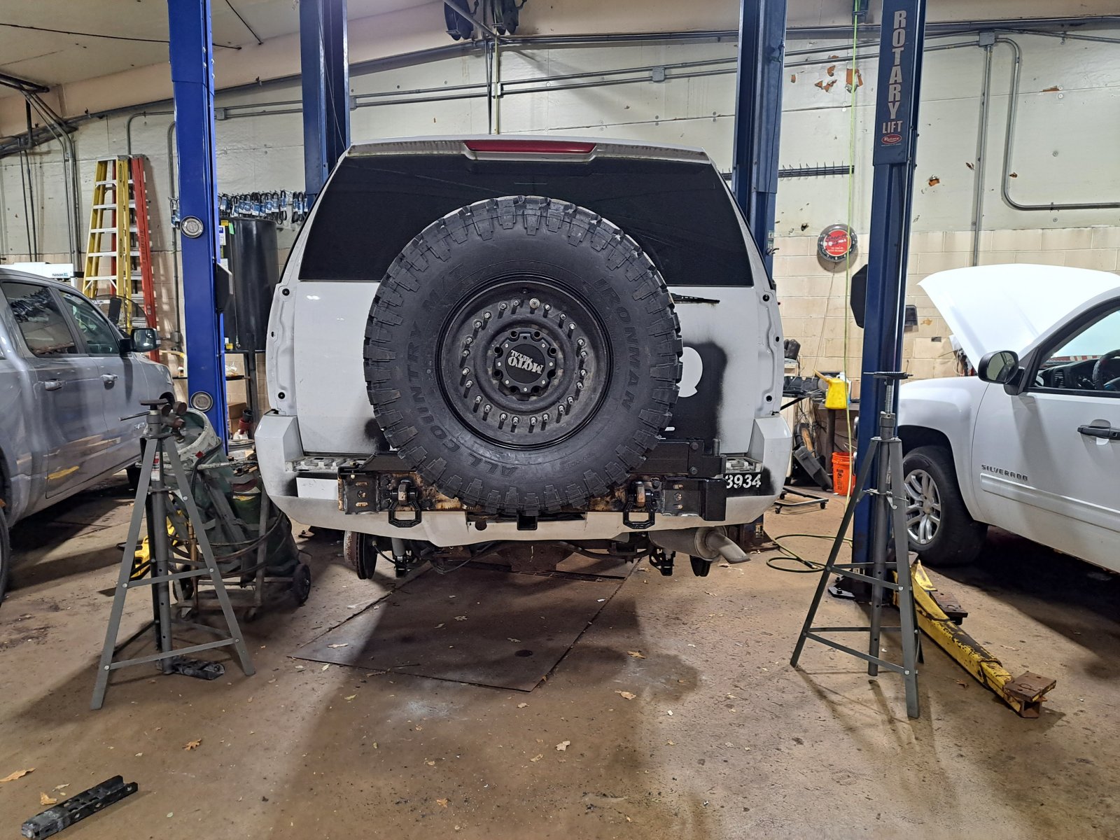

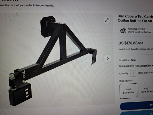

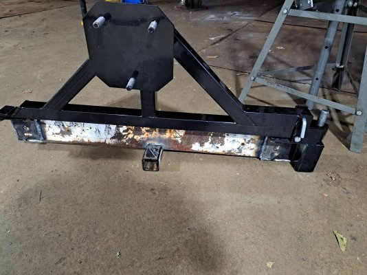

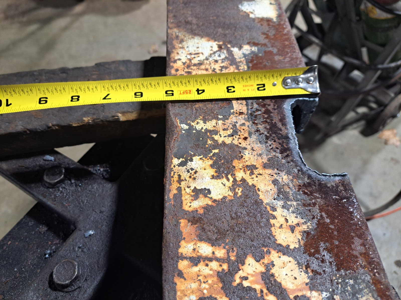

Today i worked on the rear tire mount. I started with a hummer rear tire mount off ebay 179 very cost effective.

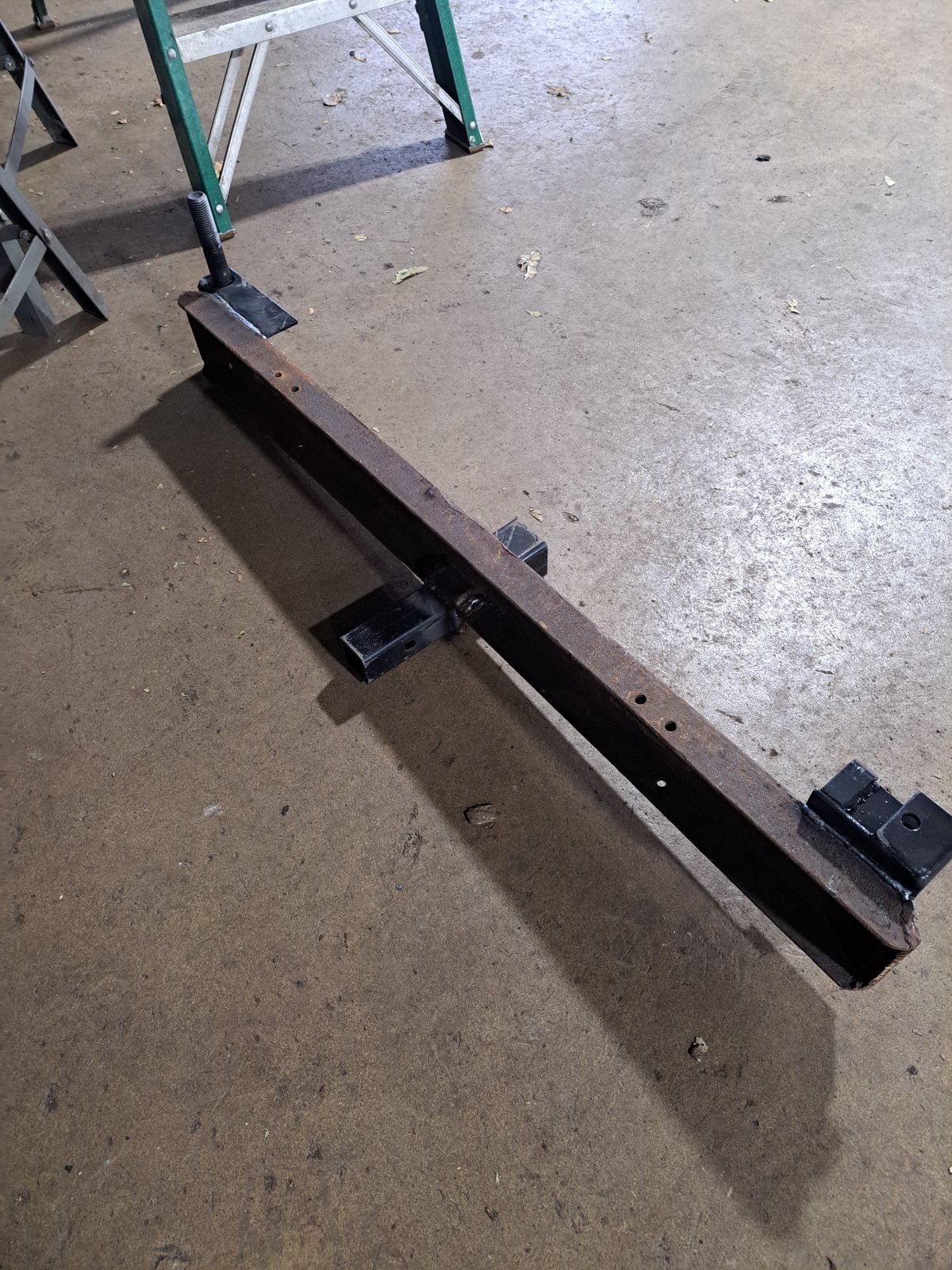

I used a 1.5 x 5 inch c hannel x 48 inches to mount it to the tahoe. I will add left and right fasteners to the reinforcement to hold it better tomorrow.
It slides into the hitch but has another on the outside so i can still tow.
I mounted a tire today and slid it onto my 07 to see if the gate would open and clear and also how close it is to the cover once on,
tomorrow ill work on it and post.
