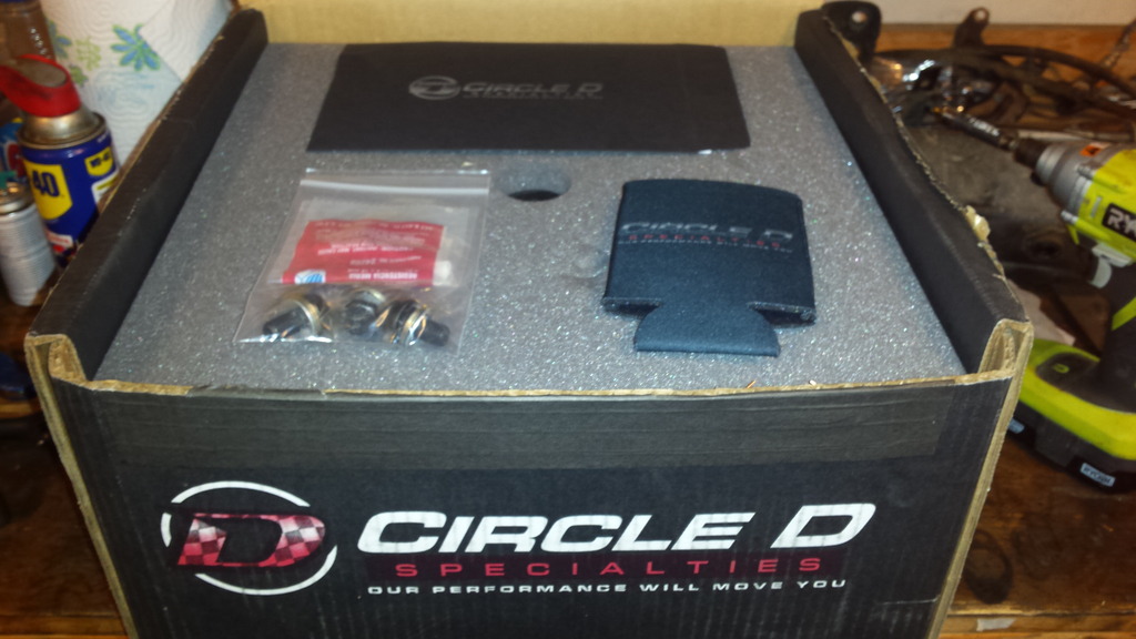

That's funny he linked that thread as I was going to recommend the Vinci Trucker cam. I like how the torque comes on with this cam it feels like a big block but doesn't run out of breath up top. It did shift my power band up slightly but that why I did the 2800 stall and with the 6.0..she gets out the hole nice and I spun the tires once but didn't like the sound my posi made. I have 3.42 gears and will probably go 4.10 and a better locker.
I think the rule on stalls is to stall 500rpm above where the cam starts making power. 2 things I've heard guys reget is going too small on their cam or too big on the stall..I think I'm borderline on what I would want in a dd stall, but the cam is great dd and weekend warrior..
