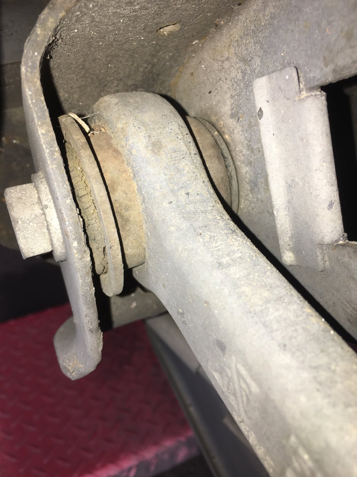

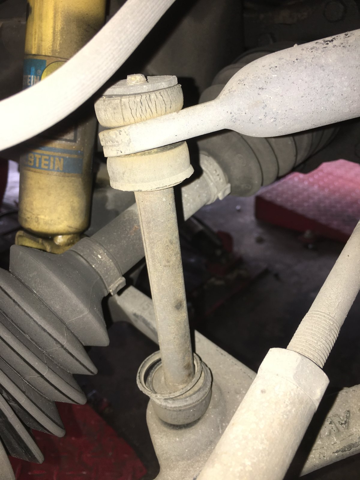

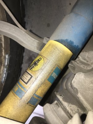

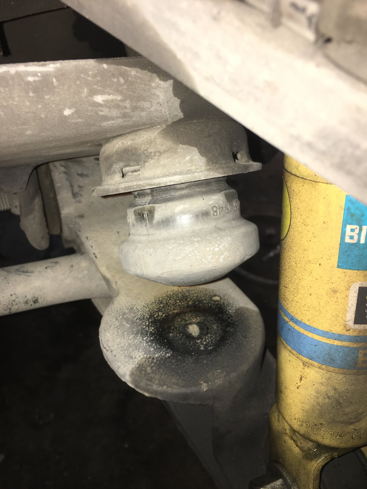

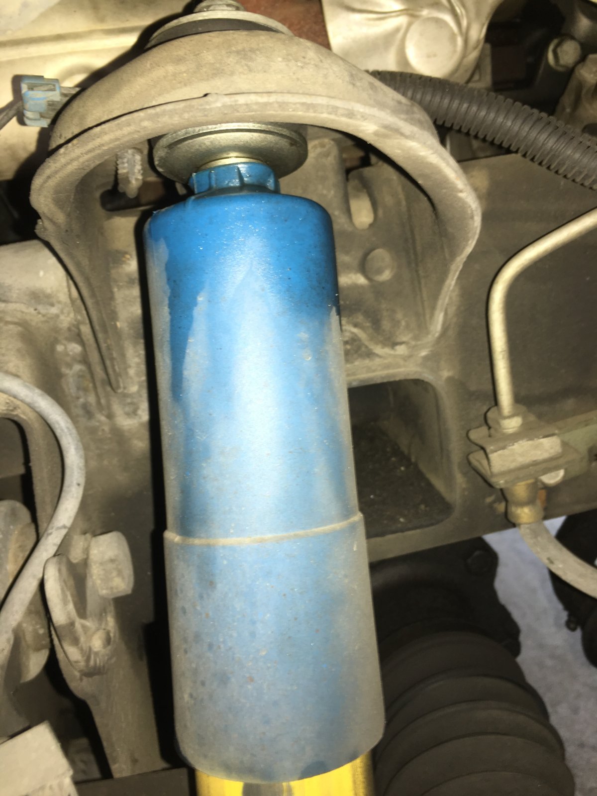

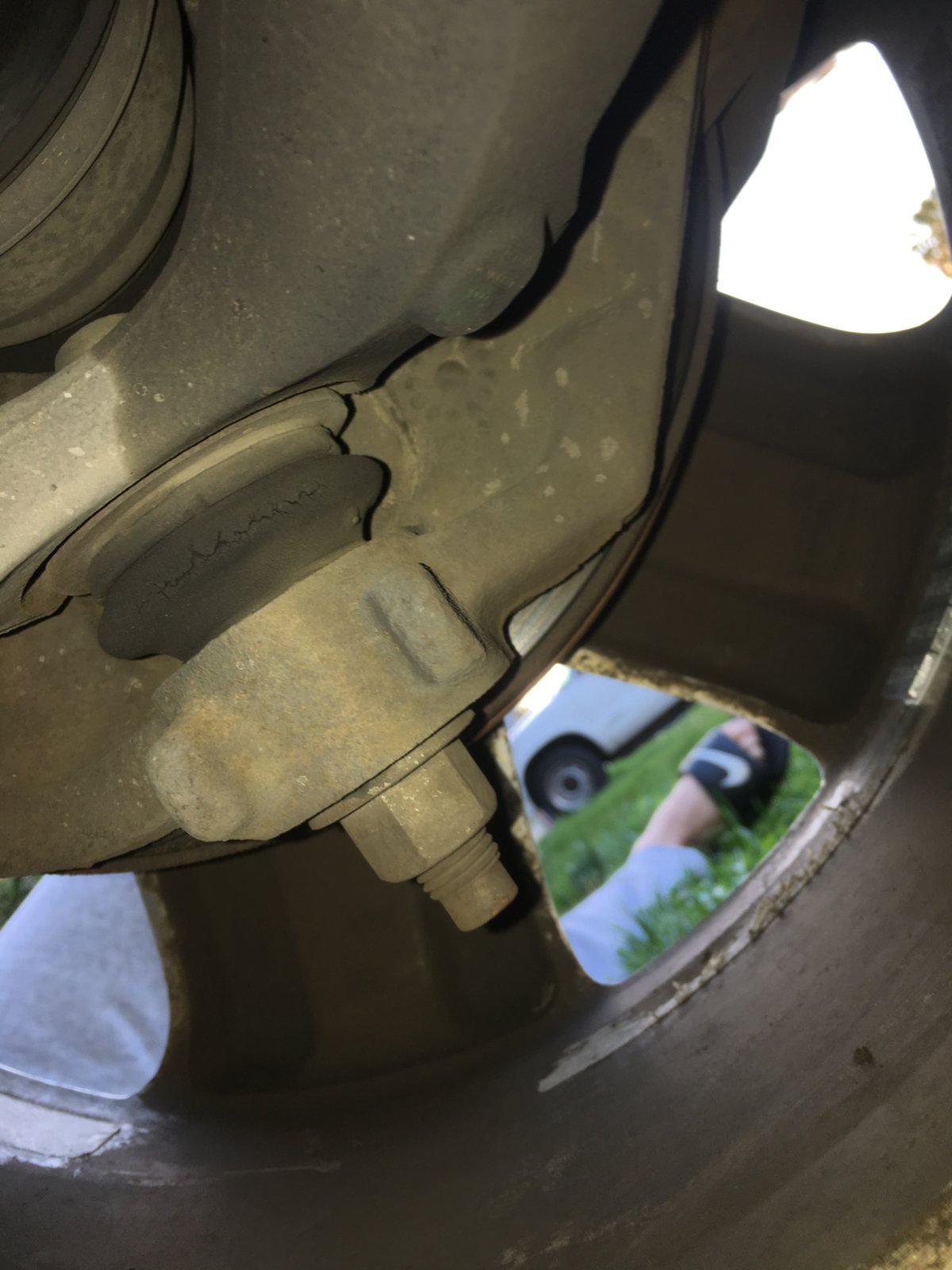

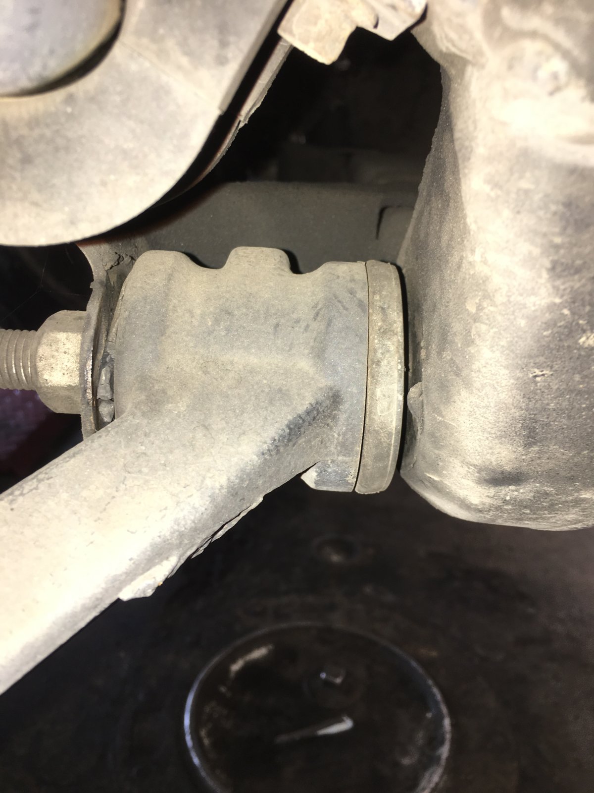

Here a Are a few pics I was able to capture while the tires were being installed today. I keep hearing that everything looks really surprisingly great underneath for such high miles, but it certainly doesn’t feel that way on the road to me. I want it to ride like as new as possible.

dont have any advice on the steering other than check your ball joints. but make sure you get the steering all fixed before you crank up your keys

Thanks! Yeah, I’m not altering anything until I figure out what is making these noises, creaks, knocks etc. I know most of the play is probably the steering box, but there’s gotta be more worn out at 262k than only what can be seen visually?

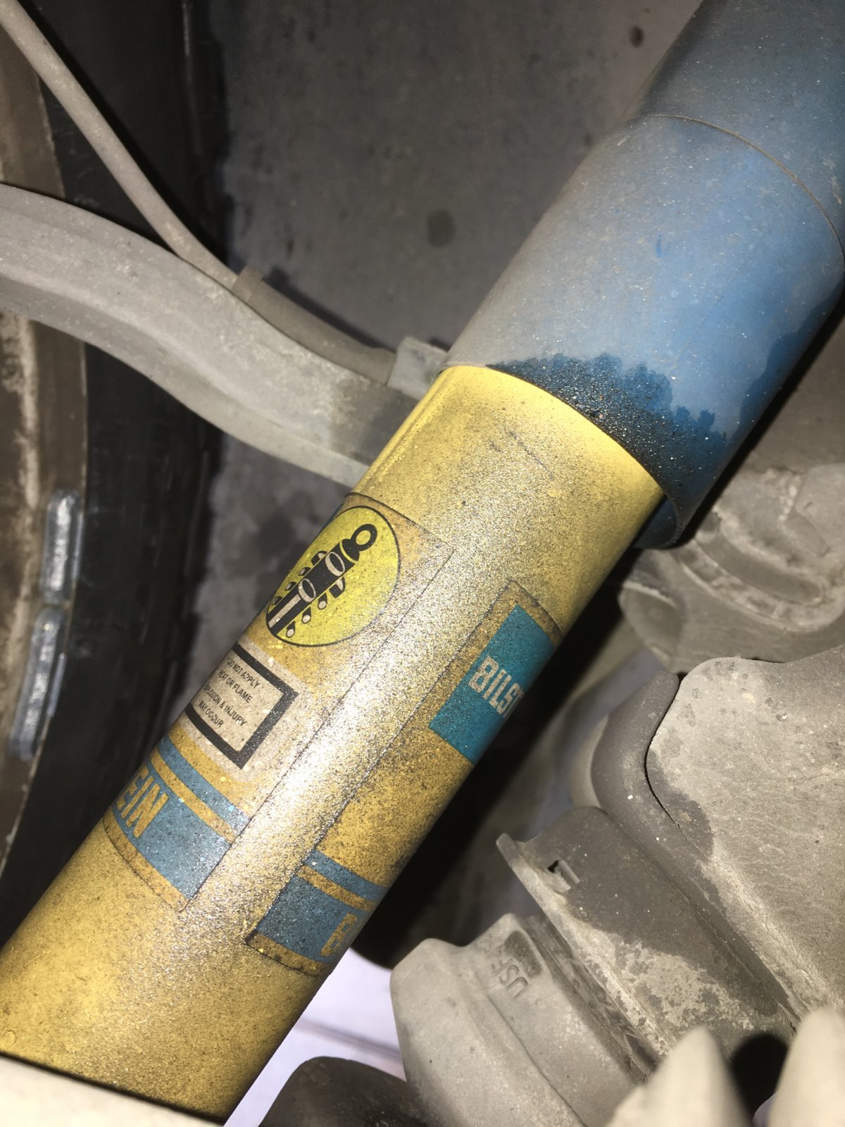

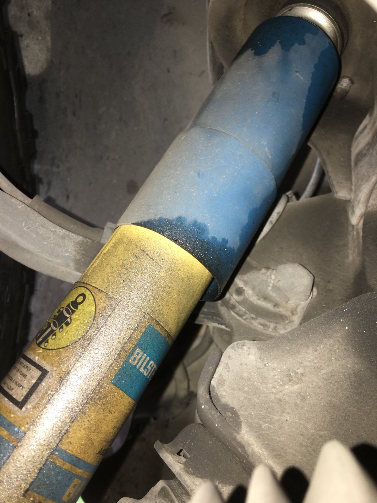

I just posted about doing the ebay front end kit on my '04 with 195K miles. I had the 4600 shocks you had and went to 5100s as the old ones had done 100K miles and owed me nothing. See my post but overall I am thrilled with the $120 ebay kit.
