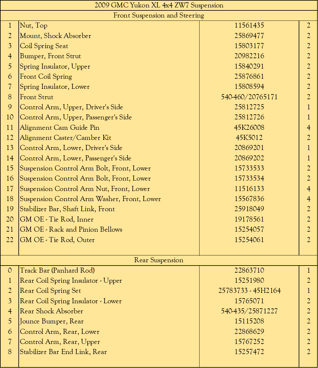

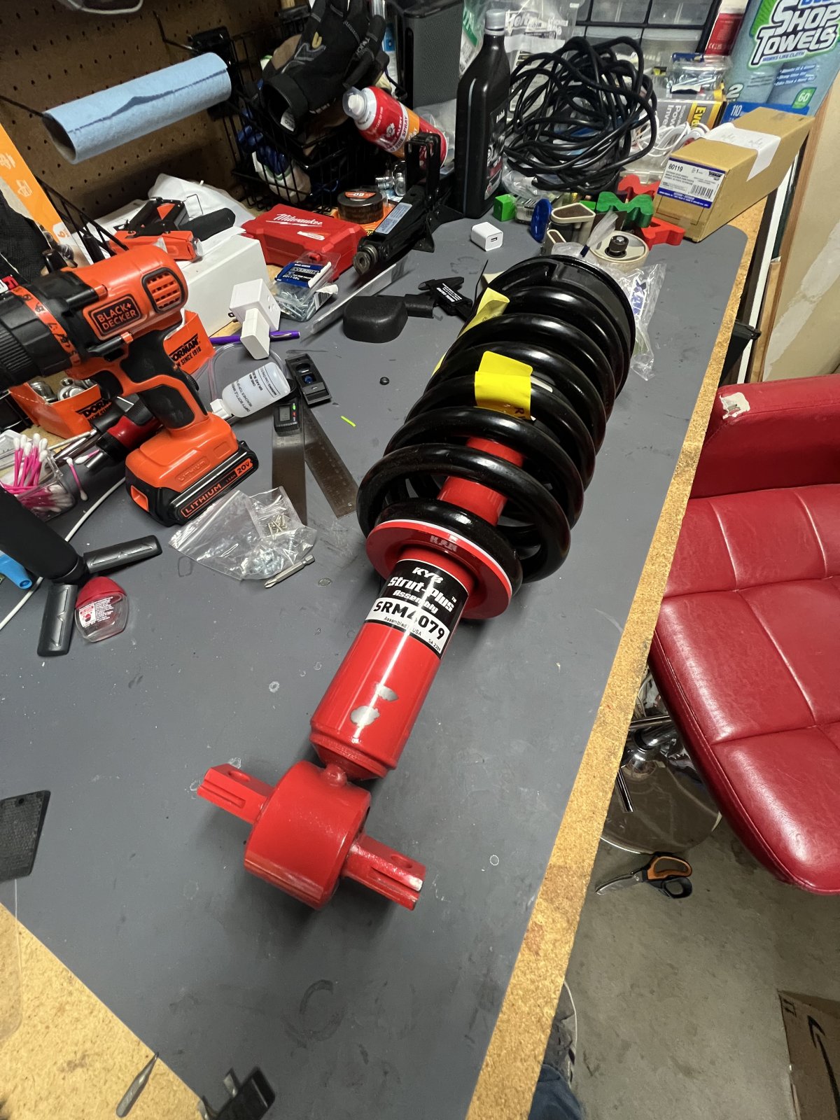

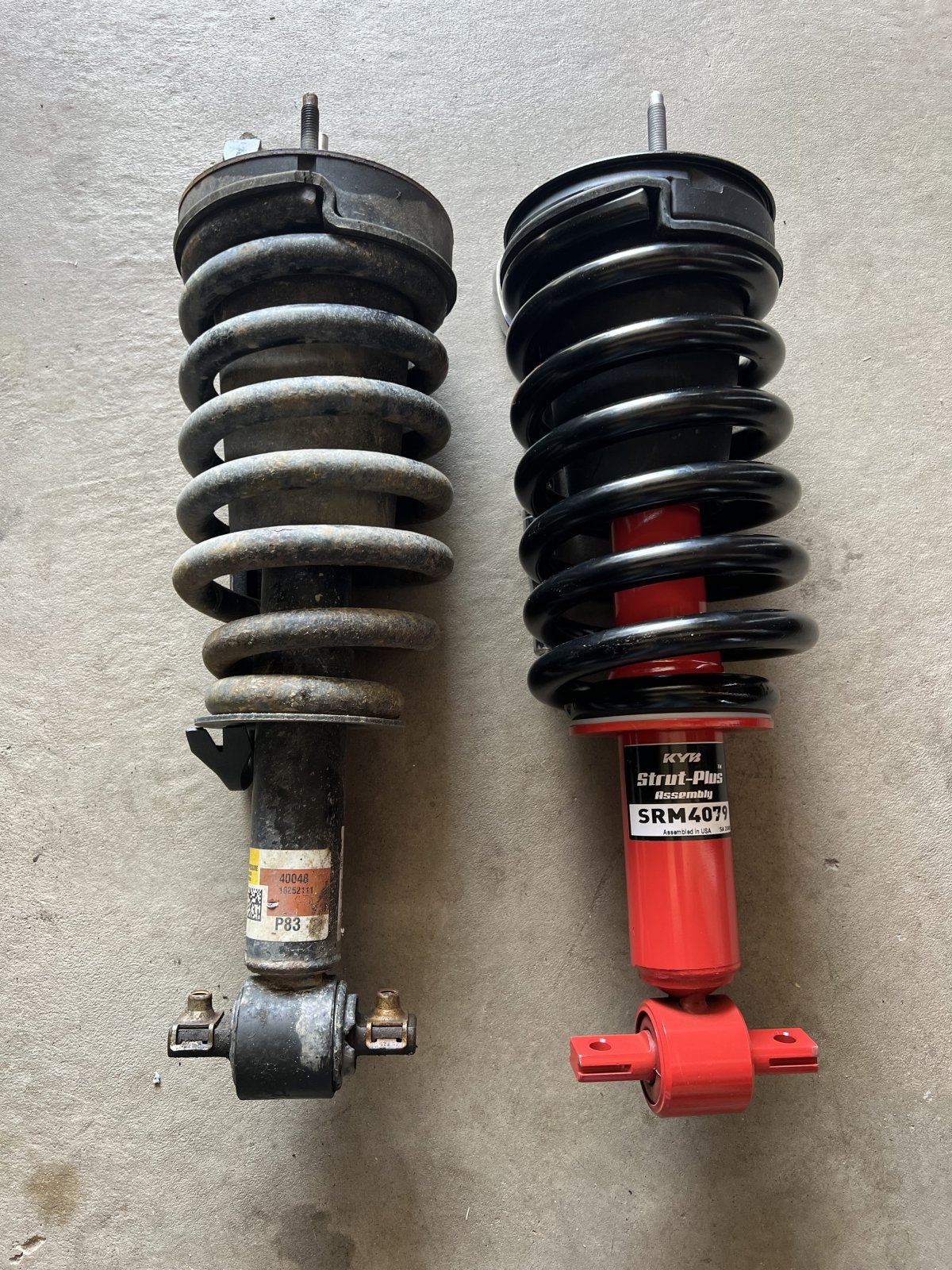

Hello all, I have a 2009 Yukon XL Denali that I’m looking to do some suspension upgrades on. I’m in the process of ordering the following parts for my front and rear suspension. My main question revolves around what front shock / strut assemblies I should go with if I’m looking to do away with Z55 AutoRide in the front? I’m currently considering either the KYB Truck-Plus or KYB Strut-Plus strut and shock assembles because they seem decent and are affordable at $175-$250 / piece vs. Z55 compatible shocks ~$500 / piece. I’m also deleting the air ride in the back and going with regular Bilstein gas shocks.
Front :
- Or -
In addition to:
Rear :

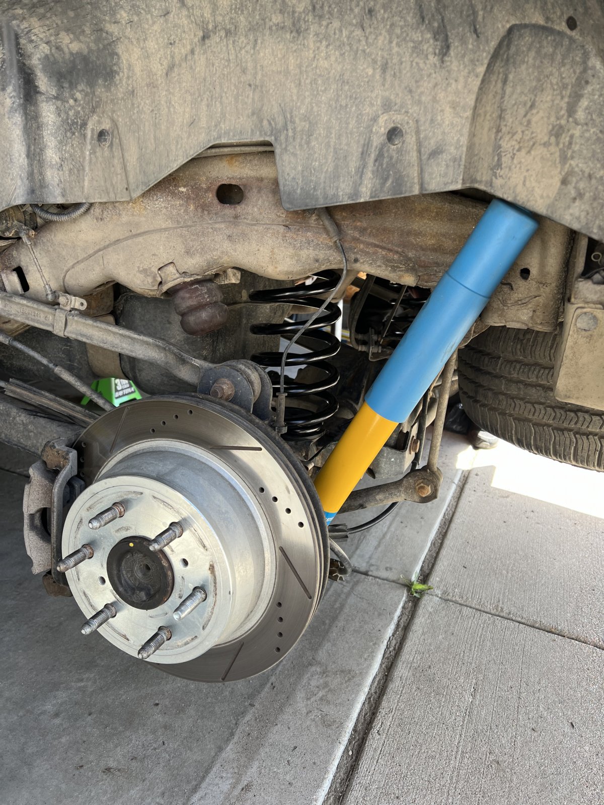

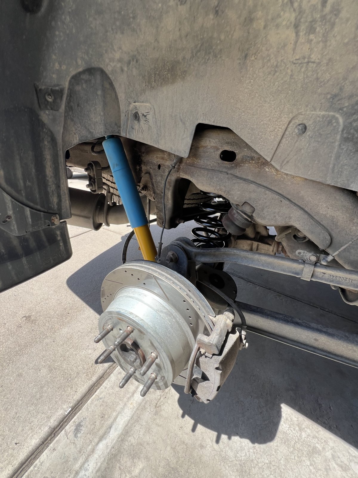

I went back and forth over whether to go with Bilstein 5100 or 4600 shocks in the rear. I’m not planning on installing a lift or towing so I figured 4600s would be the best option.
M&P Active MagnaRide / AirRide Delete resistors will be used on all four corners to ensure I don’t get any suspension dash lights or codes. I also have new sway bar bushings going in all around as well.
I have all the parts listed except the front shock / strut assemblies which I haven’t ordered yet. Anyone else used KYB’s on their GMT-900’s, especially in the front? Looking for any tips and suggestions. Thanks!

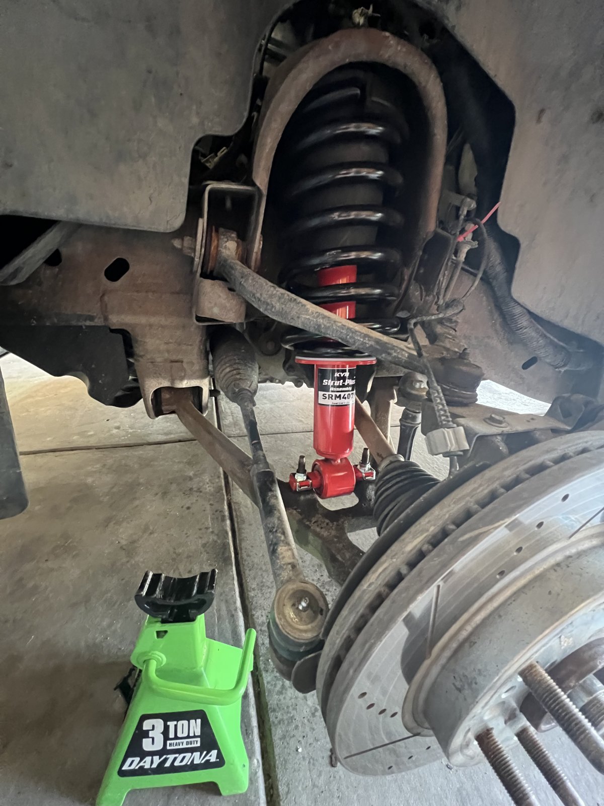

I replaced my front Z55 struts with KYB ASR4080's and installed Vigor air shocks and compressor in the rear. Truck rides great! 2008 Yukon SLT. It rides even better after installing 22" wheels.
