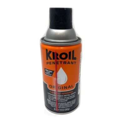

Best I have used:

Kroil was the 1st one that popped into mind for me. That’s the ship that broke a bond on a crank bolt for me. It took two weeks, occasional heat and a 6 foot cheater bar.
