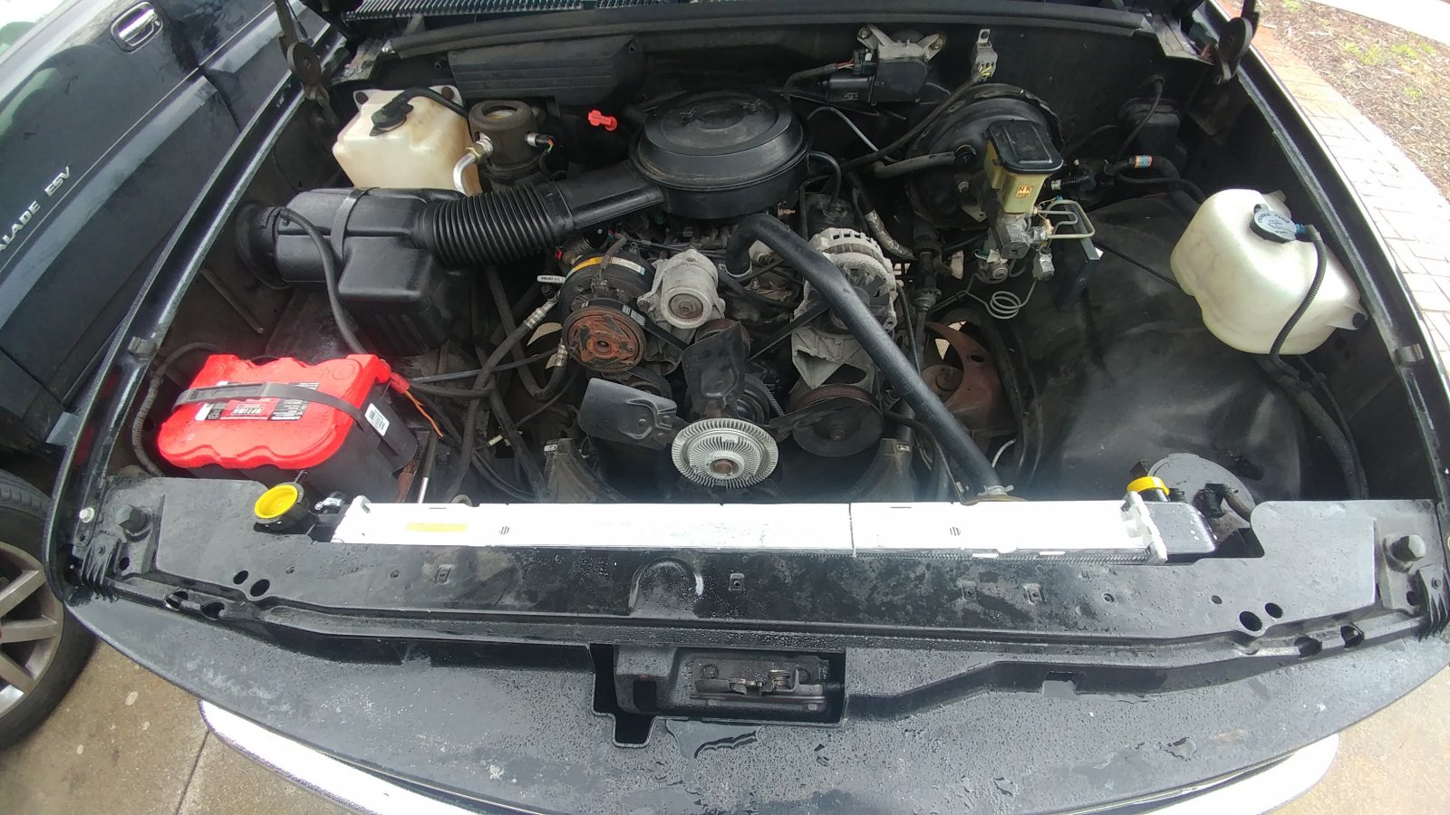

I'm replacing my radiator due to a leak. I was planning on just swapping in an OEM AC Delco replacement but figured I'd ask here first. I have a '97 K1500 Suburban and I tow a camper in the mountains. The truck runs cool when driving under normal everyday conditions. However, when towing in the mountains, it'll heat up quite a bit on extended uphill climbs. I really don't want to get an additional cooler but (since I'm replacing it anyway) I'm wondering if there's a better option than the OEM unit that could help.
Thanks for your help in advance!

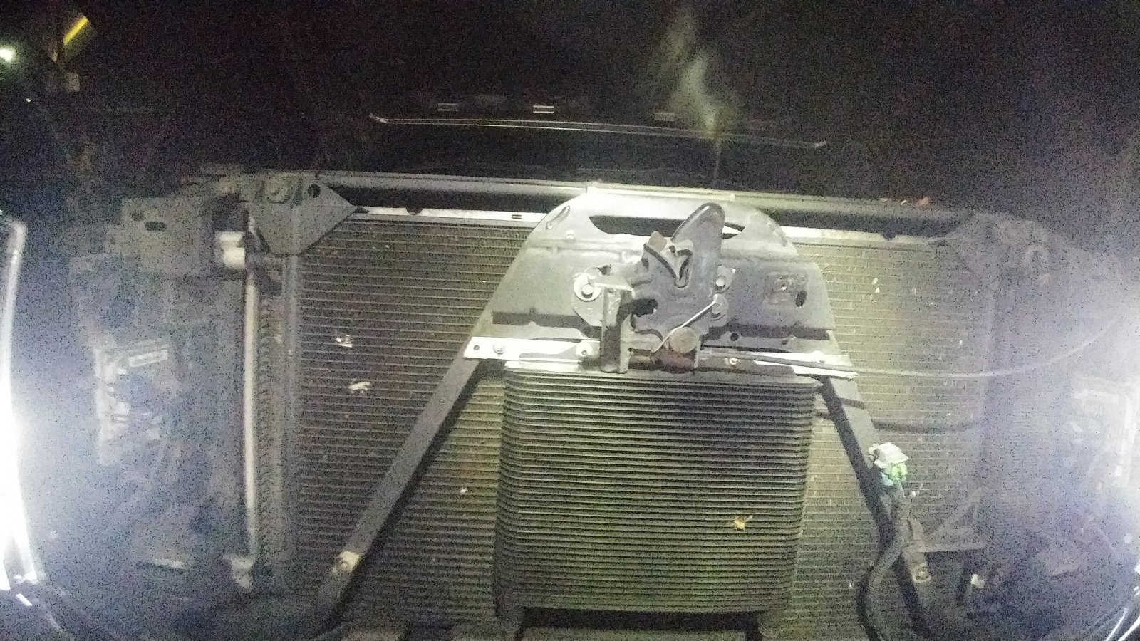

tru cool 40k is likely the best bang for buck.
https://www.performancetrucks.net/f...vw-transmission-cooler-install-thread-470284/
But really anything would be an improvement. I ran a Hayden 679 on my old (nbs) Denali
https://www.amazon.com/Hayden-Autom...ocphy=9032188&hvtargid=pla-450735795993&psc=1
And installed an acdelco 89022577 on my nbs escalade because I got a great deal on one. IIRC this is oem replacement for an OBS 3500 truck. Should be a pretty easy install.
https://www.amazon.com/ACDelco-89022577-Equipment-Automatic-Transmission/dp/B000C9TRWG
