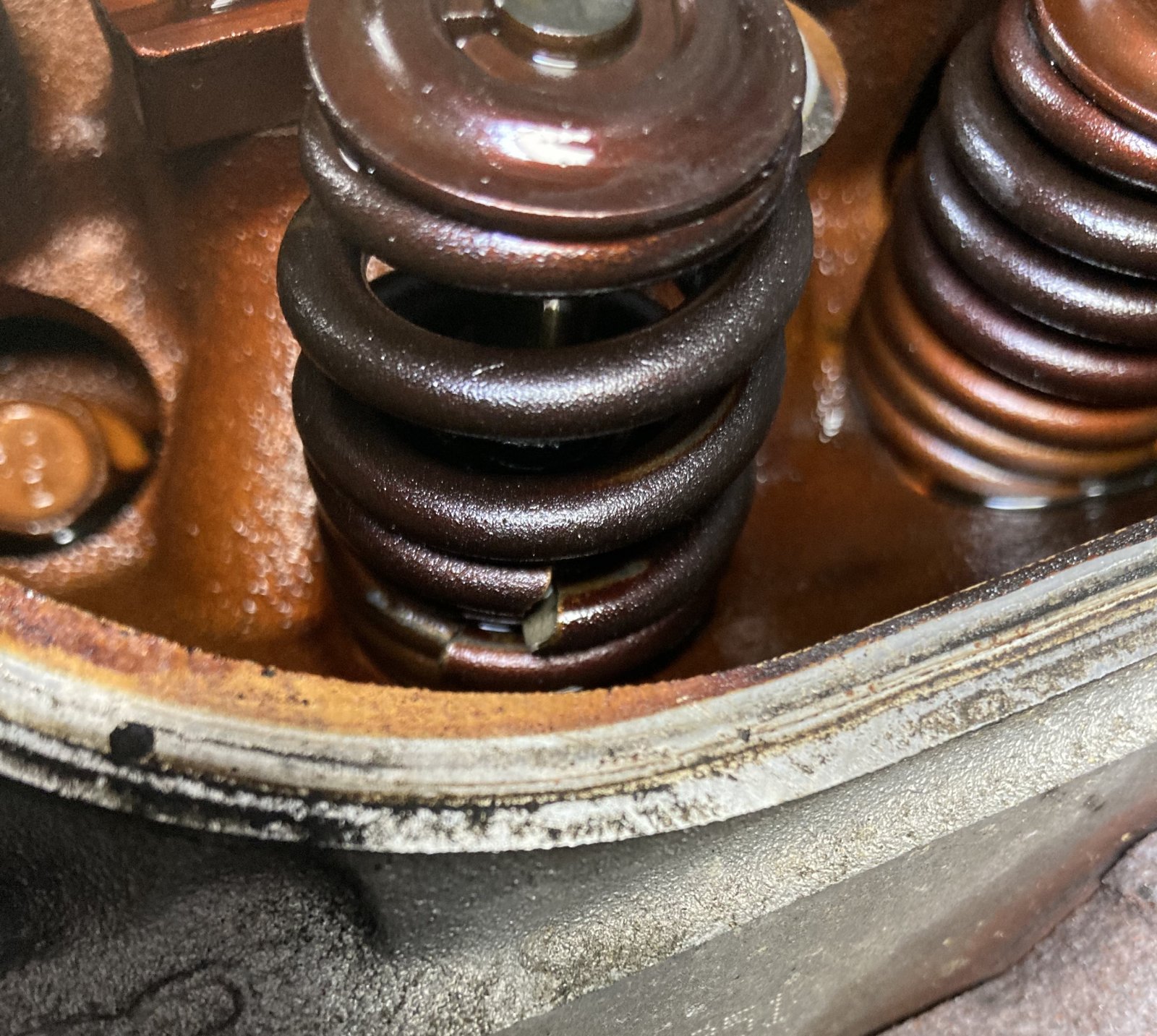

My friend is looking for a used truck to replace his tired 2003 Ford F150 with something safer, but not too new that he is afraid for his 15 year old to drive it to school. Late 2022, he brings me a 2013 Silverado from the Northeast. Aside from the rust, I am pretty impressed overall with the platform. At $20K, I tell him he can do better, so I am scouring the internet for owner listed Silverados. I see a 2011 Yukon Denali pop up on Facebook with 214K miles for $6K, listed as a mechanics special that has a failed lifter that has an estimated replacement cost of about $2.5K. So I do the research into the AFM/DOD lifter colllapse problem, and put it on the back burner. Well 2 weeks later the listing is still up, so curiosity gets the best of me and I arrange to go take a look. My friend has already found a local NC owned 2015 F150 for $15k, so he is happy, but this Denali is still on my mind. The vehicle has good bones so to speak, and nothing seems to be wrong other than the missing cylinder, so I tell them they should fix it since it would be better to invest a small amount in an otherwise good vehicle. But they have already bought another Yukon, so I think for a minute and offer them $5K, which they are happy with.
I bring it home and order the crazed performance lifter tool and DOD delete ring full prepared to try and unlock a stuck lifter without removing the heads. I am fully ok with removing the heads and replacing the lifters, but the idea of unsticking a lifter to have a potentially longer operational life without DOD for pennies, really intrigues me for some reason. There was active misfires on several cylinders as well as misfire codes plus an open circuit code for injector #2. So I start digging in with the ignition parts off and the intake removed, fully ready to unstick a lifter.
After I pull the valve covers, I find this:
I'm sure you can all spot the problem. A $4 valve spring. The previous owner was quoted $2400 to fix the problem. The open circuit on the injector was not a wiring problem, but just a diagnostic removal of the connector during previous troubleshooting. I guess it is also partly a miracle the spring broke on the lower section and didn't allow valve to piston contact. Crazily, I actually drove it about 15 miles home at low speed.
So long story short, the original lifters are still there. New valvesprings and a good injector cleaning and the engine runs like a champ.

So a little backstory....

That really sucks the previous owner got hosed by their shop. That shop probably ordered a new valve spring and spray paint for new looking heads that were never intended to be pulled.
The GMT900 are really predictable and owners tend to not maintain them. That’s a testament to their longevity because they tolerate the lack of maintenance and get sold on when they break. Kinda like you ran into :)
That is very true. I think the increased reliability can breed a lack of concern for maintenance. I also feel like some of these computerized maintenance minders imply that 8,000 miles is ok for oil change and maybe some will just think the yellow/orange light is more like a suggestion. It also makes it hard to determine true value for a used one.
I don't really blame the shop for quoting lifter replacement. It was a believable possibility to me, and I would probably give a quote for the most costly probably as well. Of course, if a shop charged for new lifters and simply replaced a valve spring and spray painted the heads, that would be very sad.
