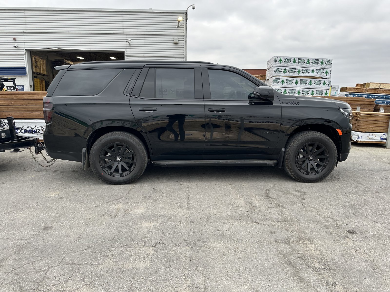

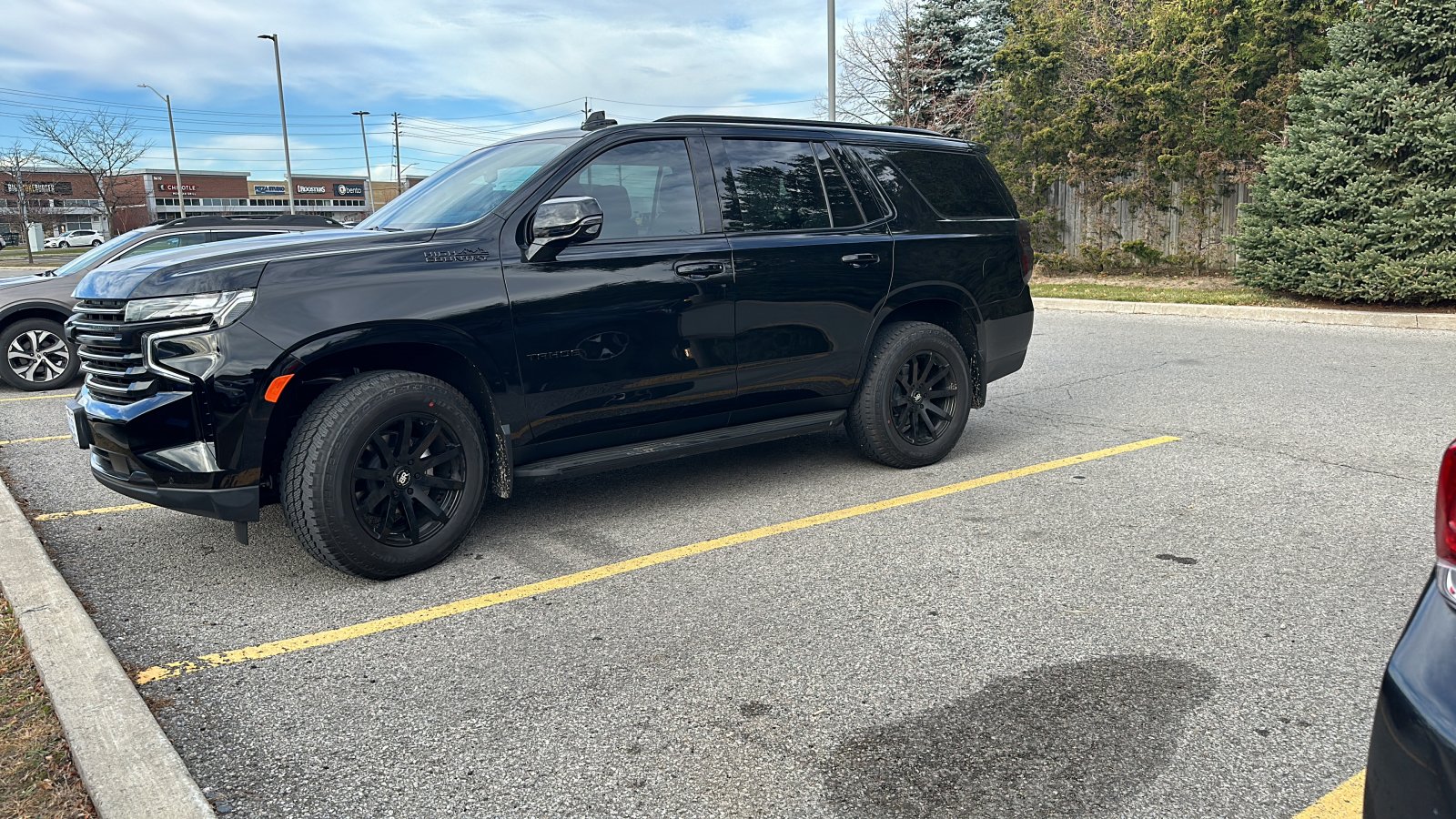

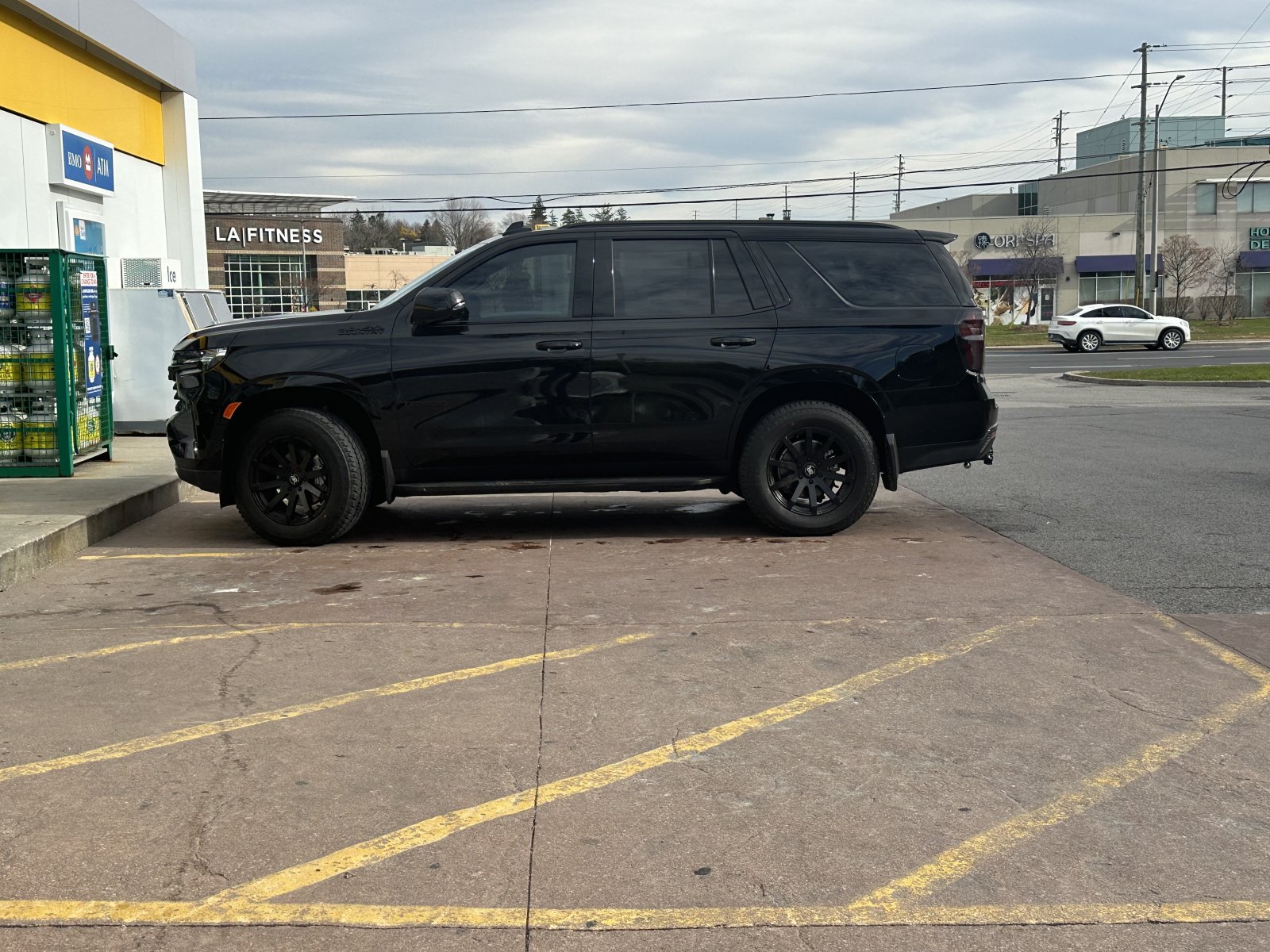

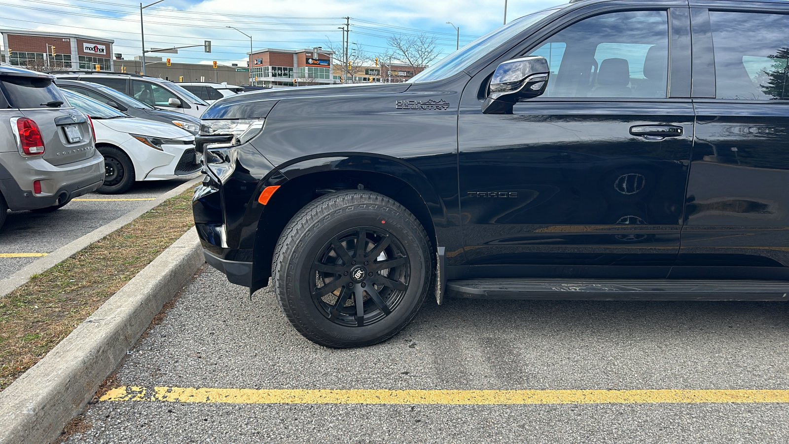

I ended up getting all train Bridgestone to try and see if it works or not . It rubs. Not much but it does ,
So on a full turn if there is a bump it sounds harsh , more on the right side than the left side. Also, winter time with the ice and snow built up then there is absolutely no room , so I decided to go 275 60 20 micheline x ice for the winter . In terms of look, it is not a huge difference either but overall everything make more sense. I don’t think I can say the 65 was a better ride in the bumps either. These are the photos of 275 65 20
