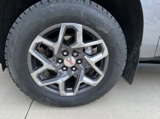

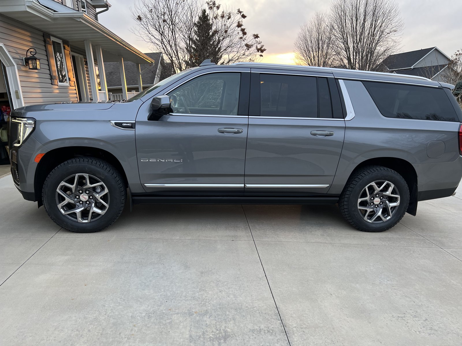

I’d stick to the stock 275/60R20, there are a plethora of 20” Silverado and Sierra takeoff options, and it’s a supported Stock Size.
I’m running the Sierra SLT 20” takeoffs for winter on my Denali that came stock wearing 275/50R22 and it’s been great
I scored these wheels on FB Marketplace for $900. Bought 4 TPMS using GM Rewards Points, and the tires were $910 at Discount Tire w/ an Instant Rebate.
