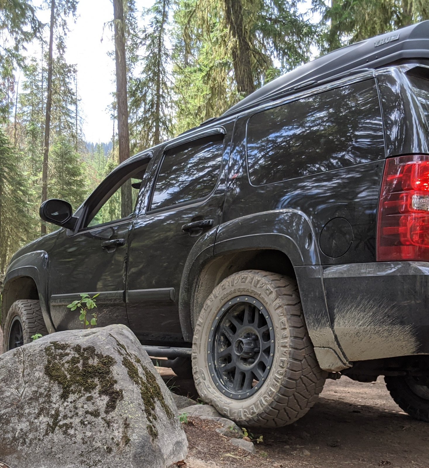

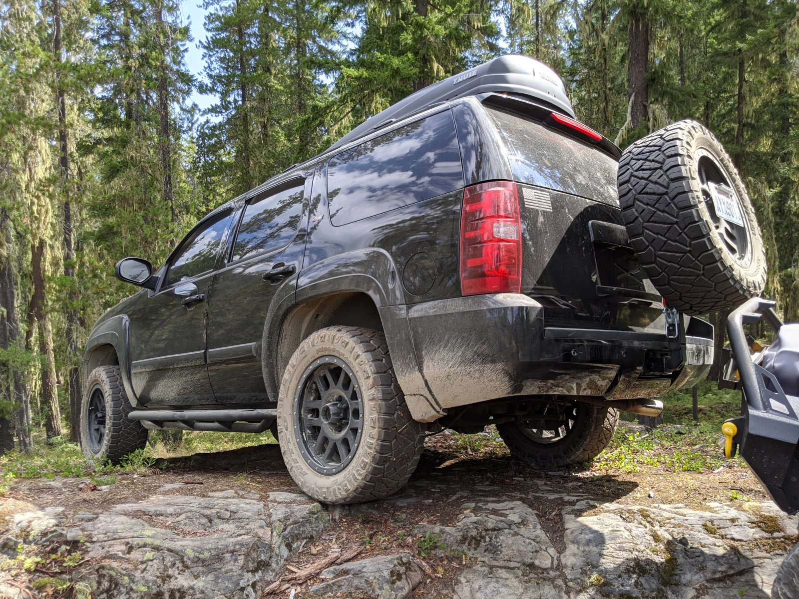

jcsswix - How do you like those Nitto grapplers? I have been eye balling those. Do those 20" rims leave you enough sidewall when you air down?
PS. Ive only see a few Z71 07 and up.
jcsswix
May 8, 2011
24
33
Love the Nitto Ridge Grapplers. They're great on and off-road. I have plenty of sidewall when aired down. They are 10ply so they're very stout. I haven't ran them less than 15psi. It required extensive trimming of the inner fender well to fit the wheel/tire setup without rubbing even with the few inches of lift from my suspension setup. Also yeah I have seen very few z71's 07 and up too... They're not very common it seems.
