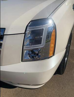

I have a 2009 Yukon Denali and I am looking to replace the headlights. However, I cannot find a Yukon Headlight unit that peaks my interest. Then I thought, well its all the same as a Tahoe or Escalade, so I looked under those categories and found one I love under the Escalade category, picture below. There is one slight problem. I quickly learned the Escalade comes stock with HID's and a Yukon Denali does not. Therefore, this headlight would not be exactly plug and play.
I was looking to see if anyone had experience in this area and knew how to tackle this project? I believe I would have to change the plugs on my headlight wires to connect to a ballast for the HID and the other bulb connector. If anyone had pictures of their Escalade wiring connections for the headlights that would be helpful as well!

I don't think the housings are shaped the same. I edges of the hood, fender, and front facia are shaped differently between the Escalade and Yukon.
Here's a pic of my Yukon headlight. You can see the shape of the housing difference.

Well, there goes that idea. Thank you for the help!!

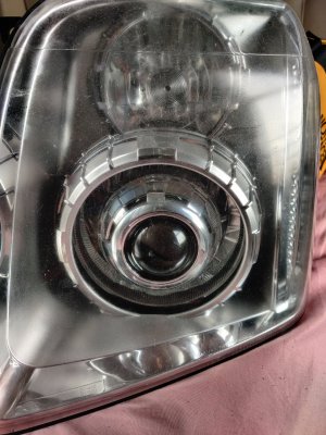

you should do a projector retrofit. could cost you as little as 300 and that's for parts and new lights

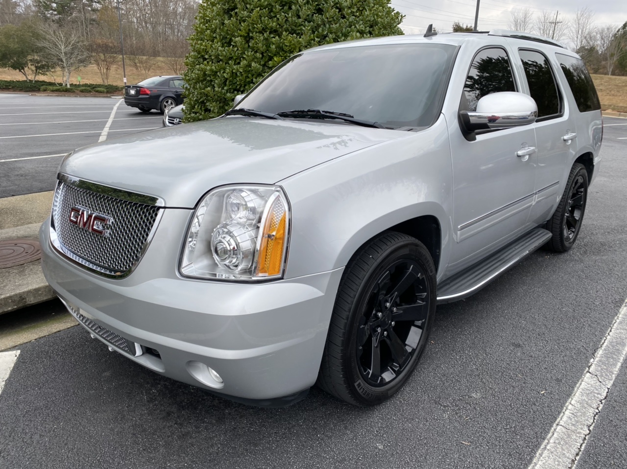

Escalade lights are not the same shape as a Yukon. I haven’t seen an aftermarket headlight that didn’t look goofy, they all look like they’re trying way too hard to me. The projector retrofit is where it’s at though. I did the retrofit myself and it wasn’t terribly difficult just fiddly but there is a company that will do them for you. I bought the Eagle Eyes factory style Denali headlights and so far the lenses seem to be holding up. I was going to buy new GM headlamps but I didn’t want to risk breaking them for my first attempt at a retrofit.

this is a set I'm doing now as a budget build. I only spent 300 for everything even the lights
