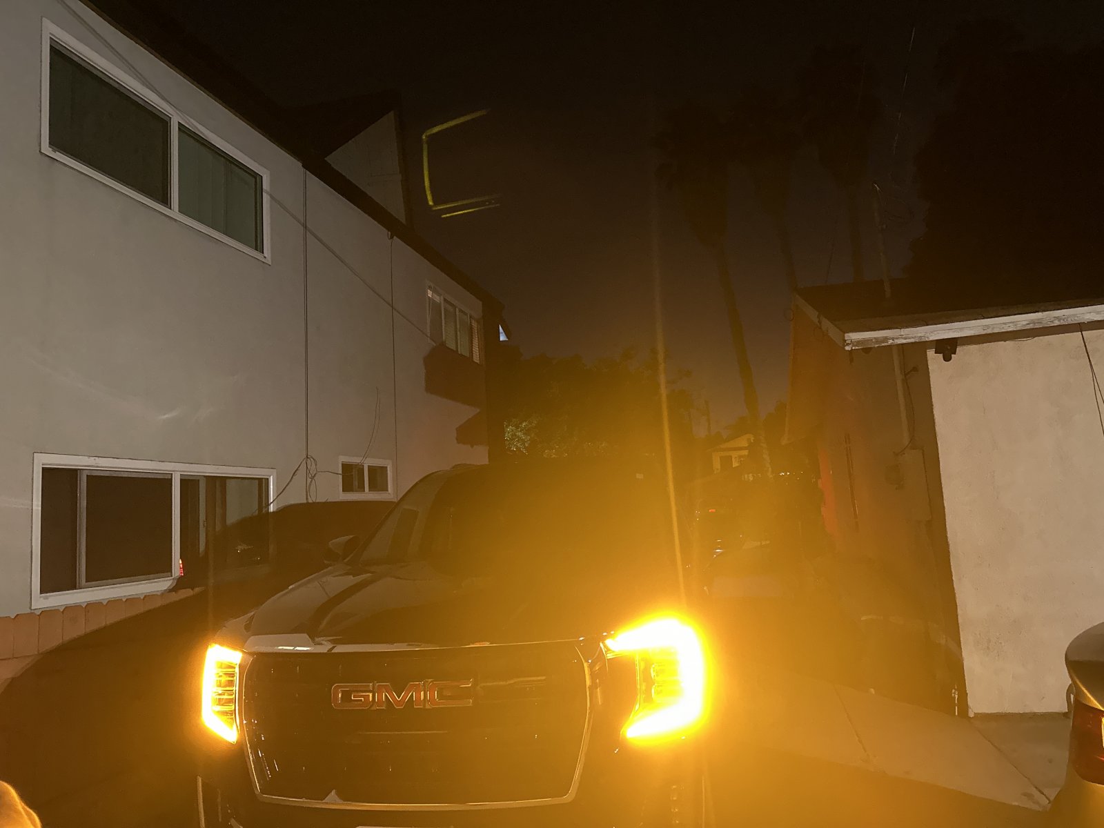

Yukon led/ emery by flashing while off does anyone know what to doo

Need a little more detail. Are you saying the lights are staying on and flashing after the ignition is switched off? Is the horn honking too or just the lights are flashing. The hazard (emergency lights) may be on, check the push button switch on the top of the steering column……. Or if that’s not it ….
Try using the remote to lock and unlock the doors a few times. Make sure all doors are fully closed including the rear hatch. Start the truck put it in drive then back to park and turn it off normally….. see where these things get you.

If they are flashing like the hazard ligths are supposed to work, it appears as you hit the hazard flashers button on the dash. It is iver by the passenger side of dash and kinda awkward to reach so its possible someone or something pressed it accidentally. Otherwise try unhooking the battery for about 10 minutes and then reconnect. Might be a system glitch.
