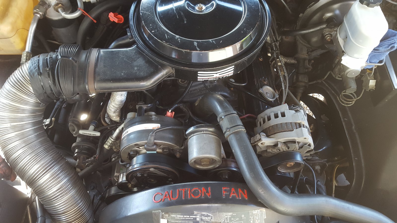

My '88 ..... I found a stainless steel 4" duct. Figured a location to cut a 4" hole, a 90 degree turn behind my right-side headlight, to a 4"x12" air scoop behind the grill. Kinda like a ram air on the highway.
