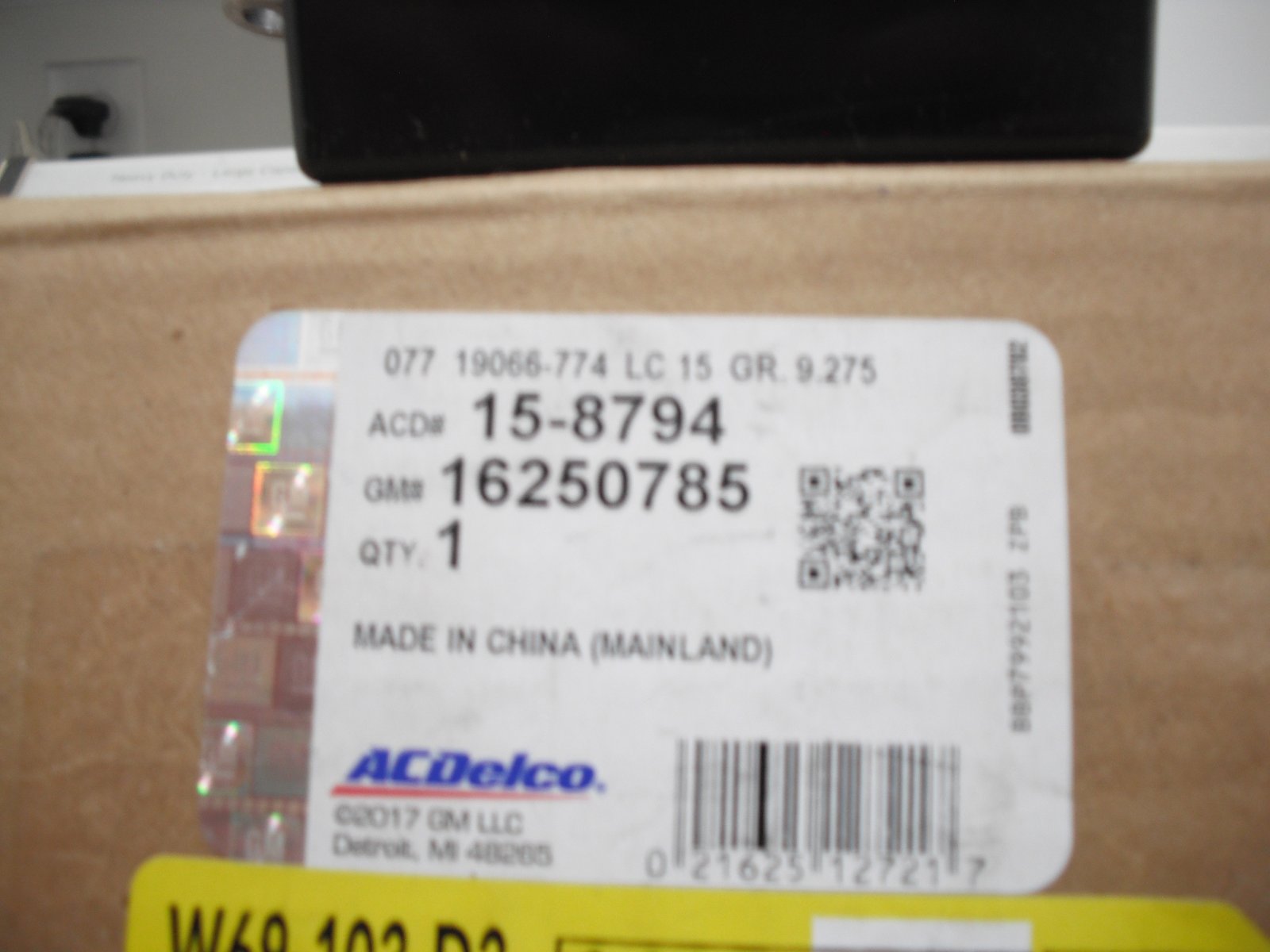

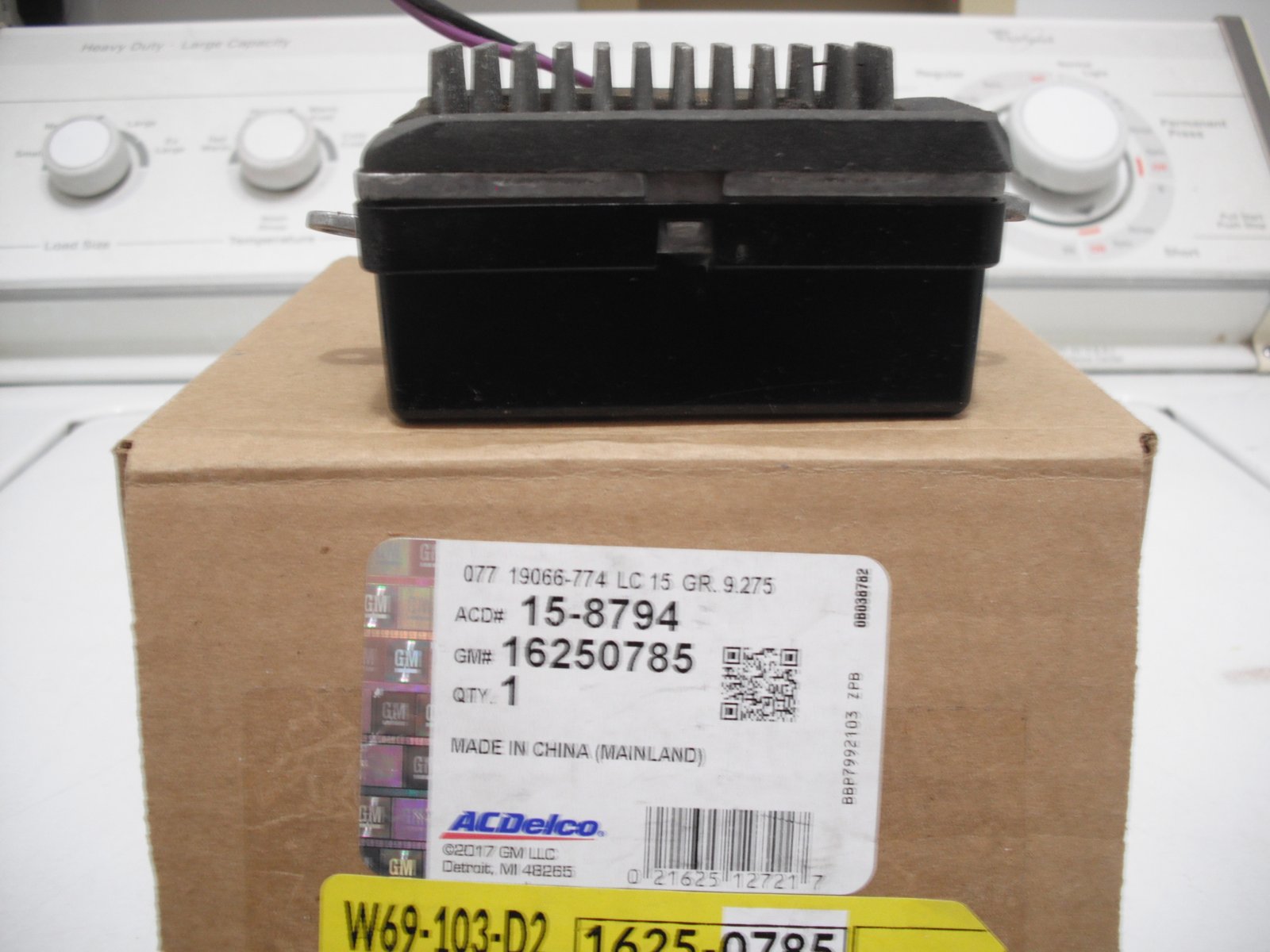

Negative, that's the one for the 2nd row that mounts to the back of the console. I attached an image of what mine looks like for the front.
ETA: it posted at the bottom of my reply. I'm still on mobile so formatting is a bit tricky haha.
Thanks for the photos man, looks like we do have different ones. I do wish I had those though, they seem a lot less prone to failure. As to your comment on the junkyard module, I hear you on that, and normally I am the same way. However, unfortunately I'm finding it impossible to find an Acdelco for sale (new) so my assumption is it's no longer produced so i have little choice unless I want to go Dorman or another aftermarket brand.
