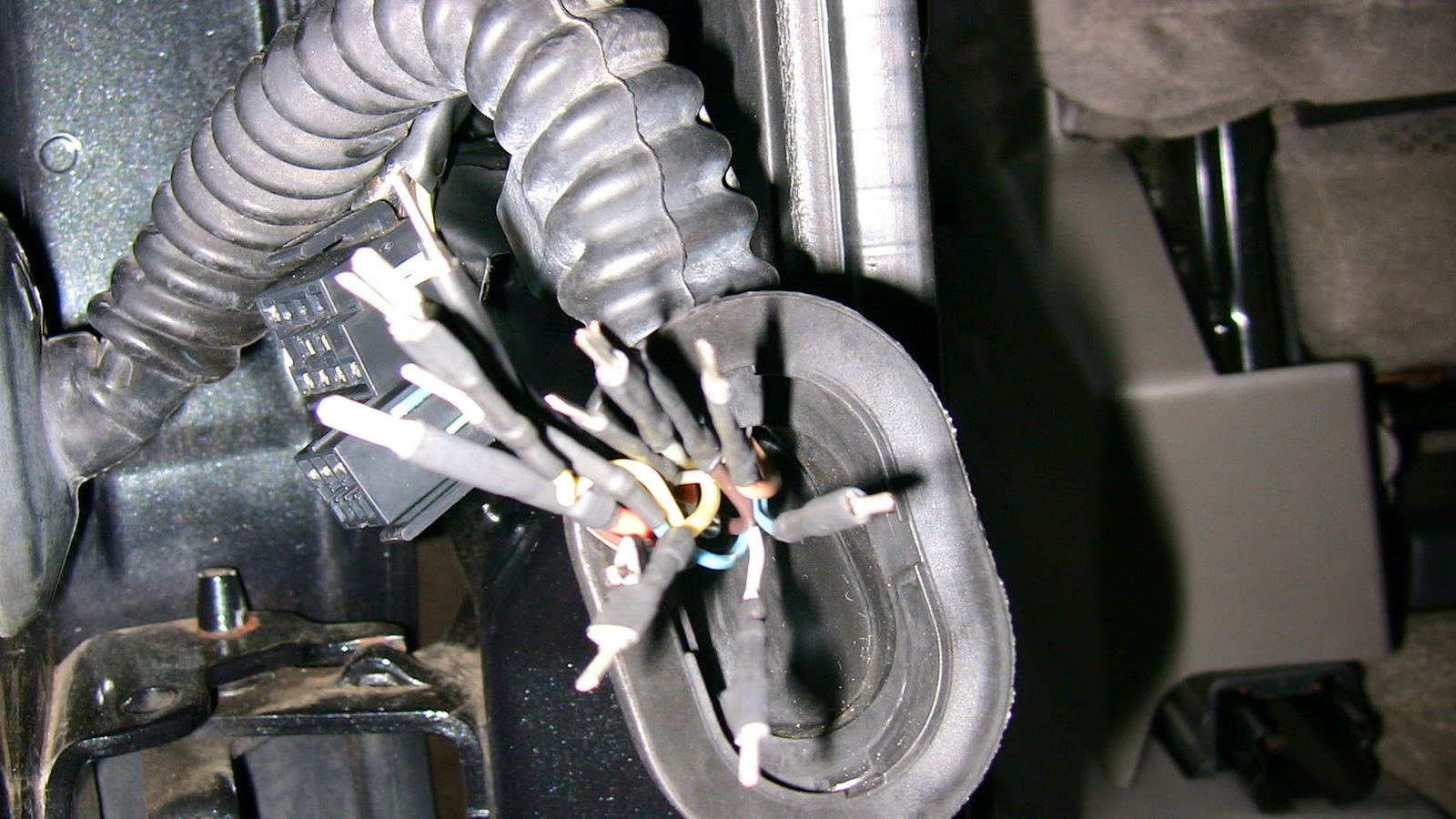

took each and every individual pin out of the plug put some heatshrink over each plug so they don't short out on each other and plugged the little pins into the smaller clips. only problem is the grommet doesn't really seal up its just in the hole.

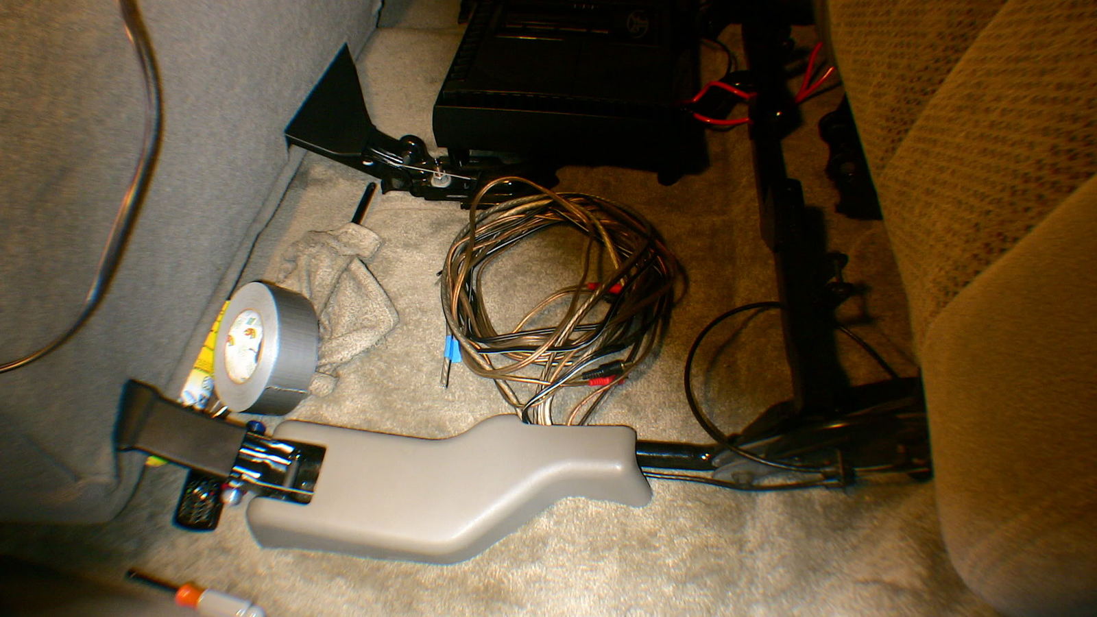

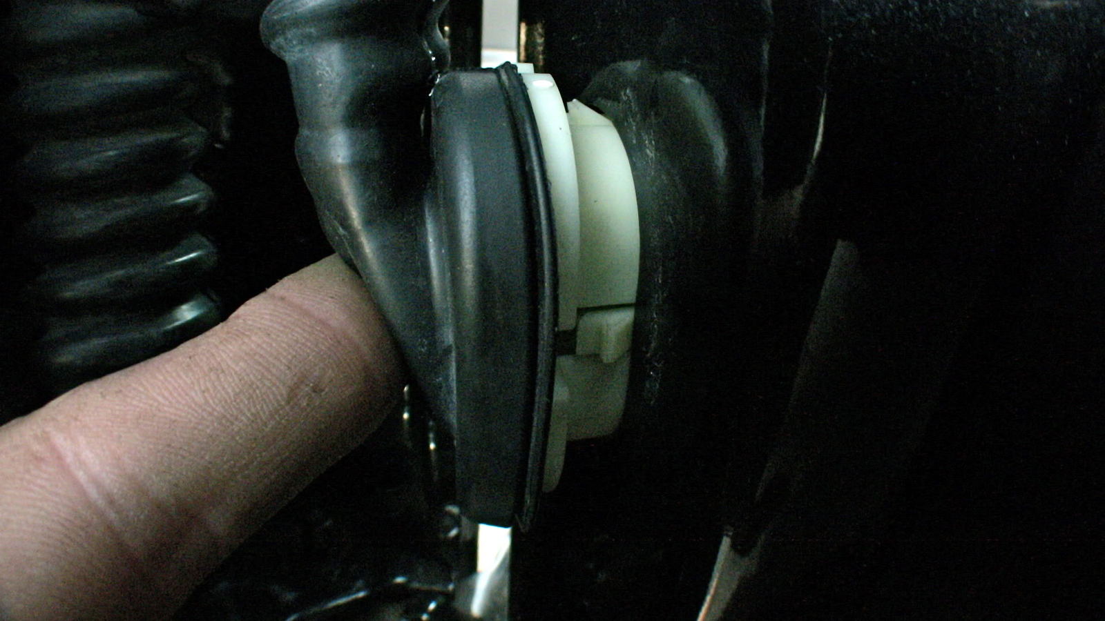

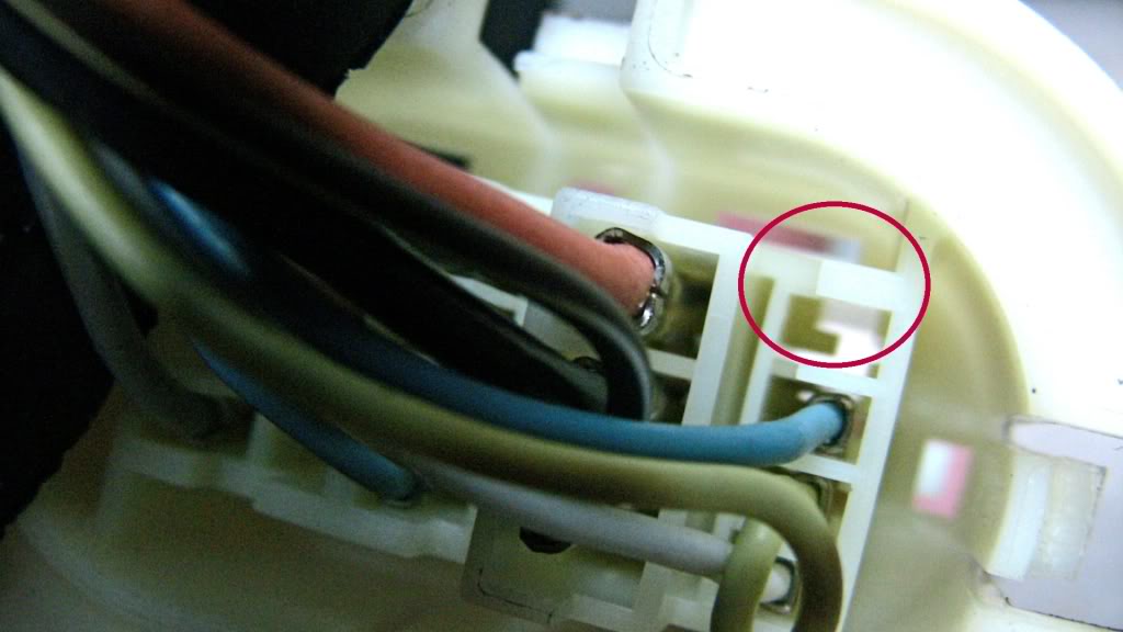

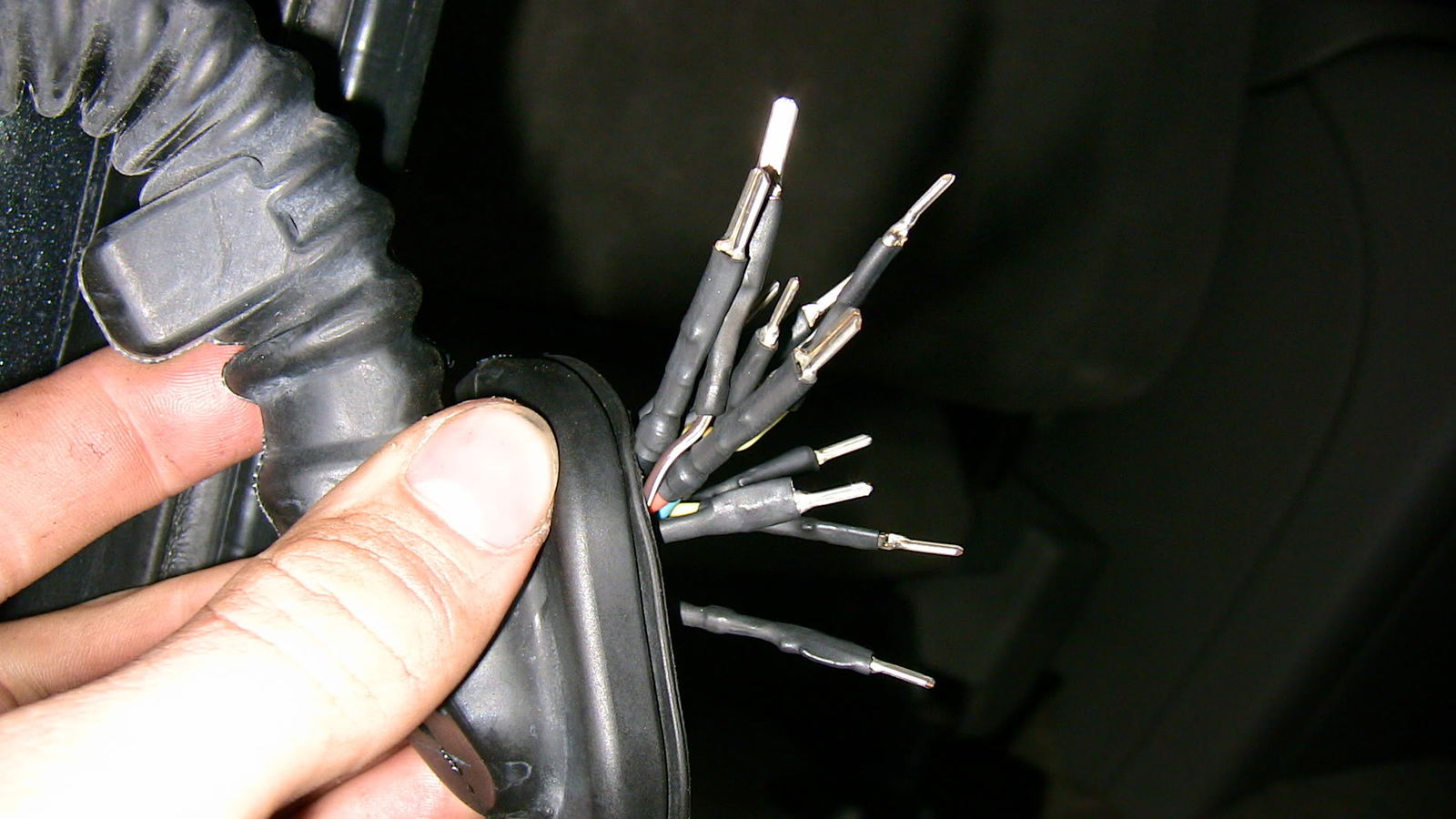

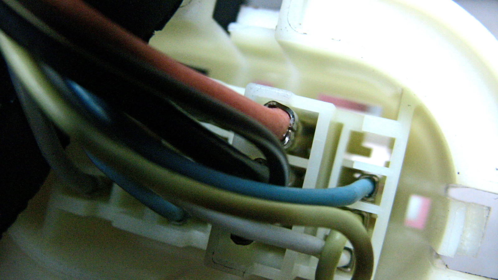

so here is my way of wiring up '03+ Tahoe rear doors :)

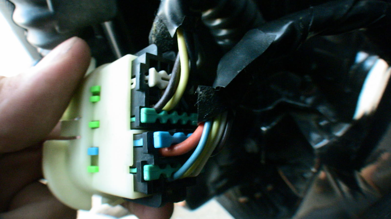

you've got the plug aka the problem
just big enough to snap in to the door frame so that means no running after market speaker wire

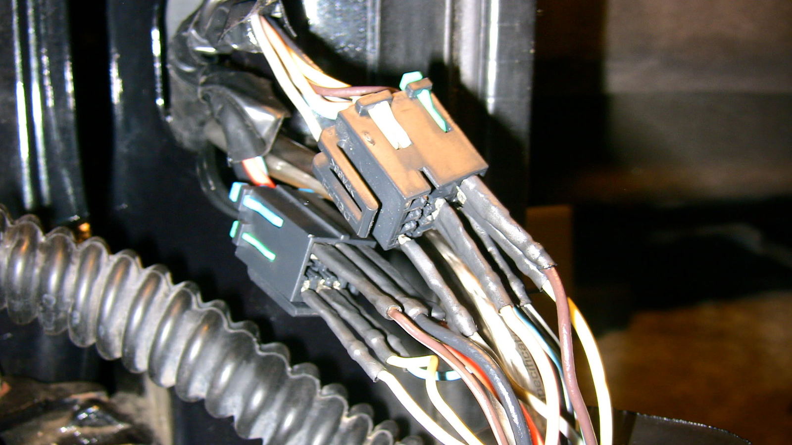

and not really any room in the plug for 12 gauge connections

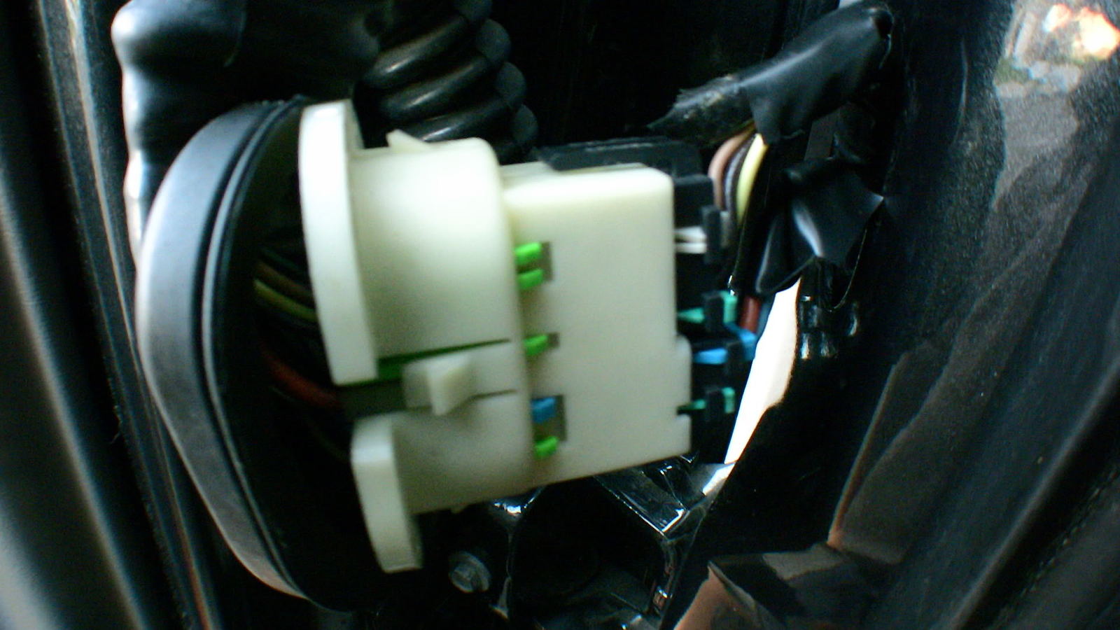

but there is room if just the black clips are connected since they are smaller than the actual plug

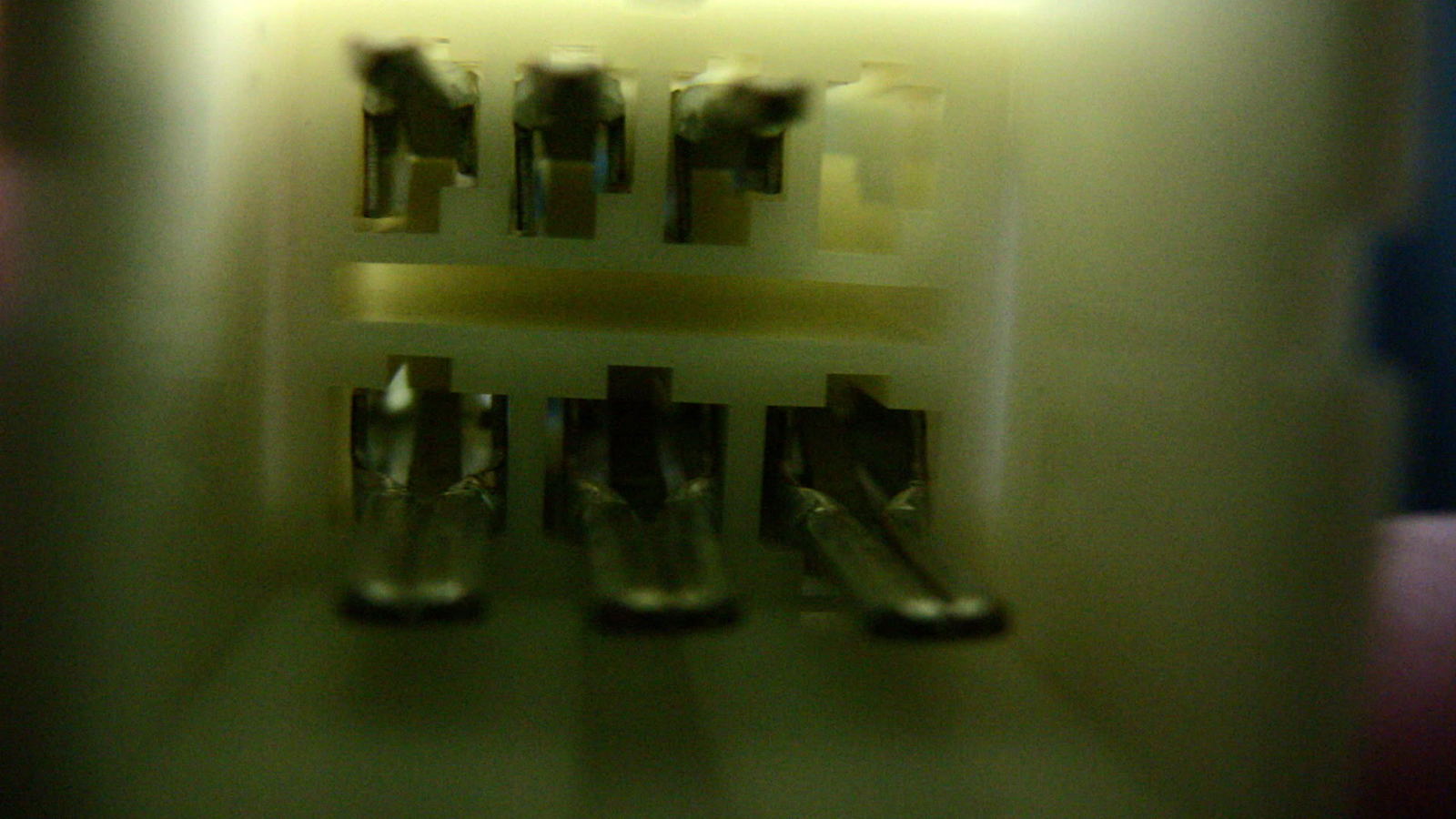

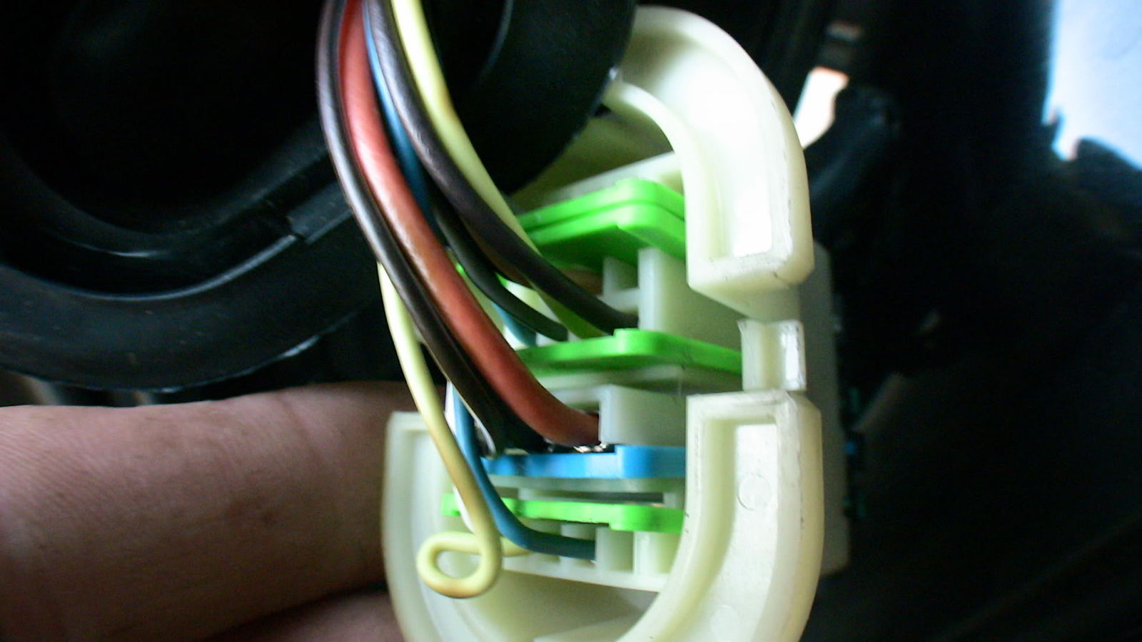

the pins that need to be pulled out
notice the tabs...

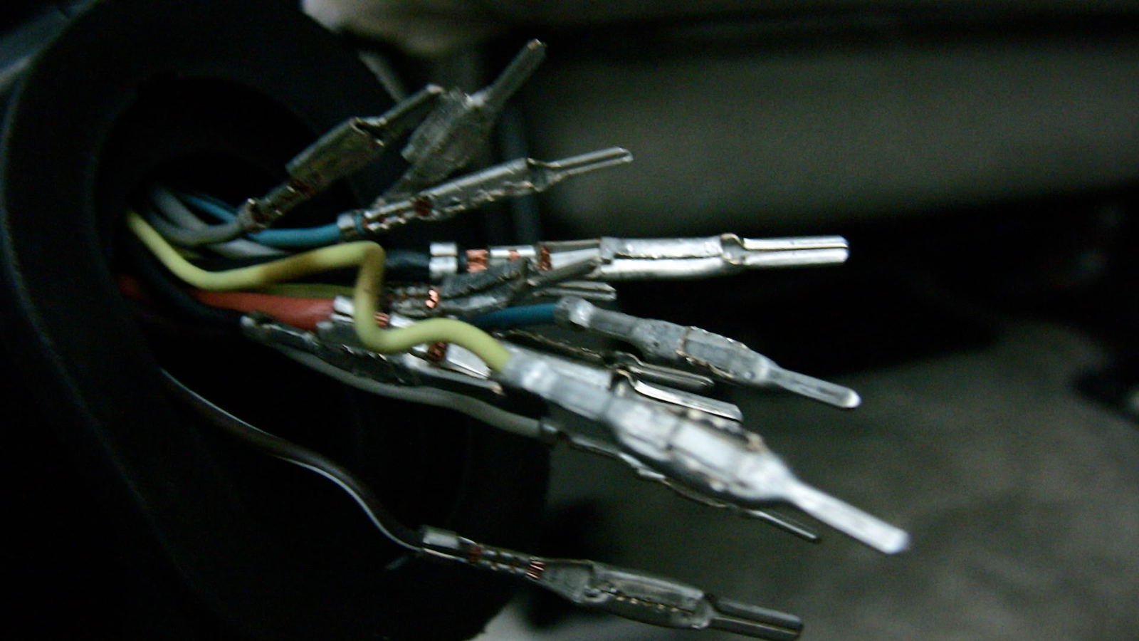

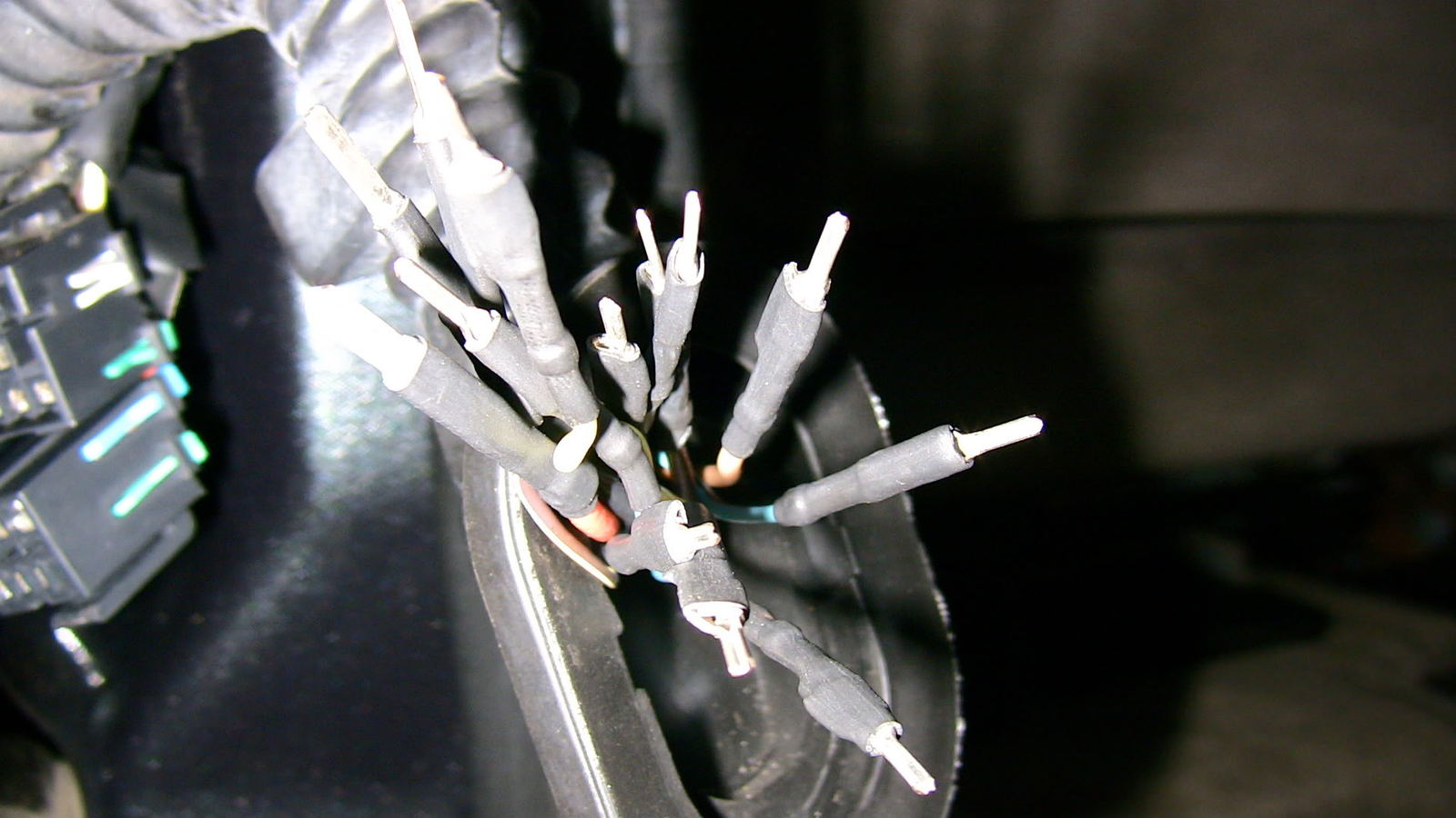

bent them over so some heat shrink would slip over
each pin heat shrunk so nothing can short or ground out

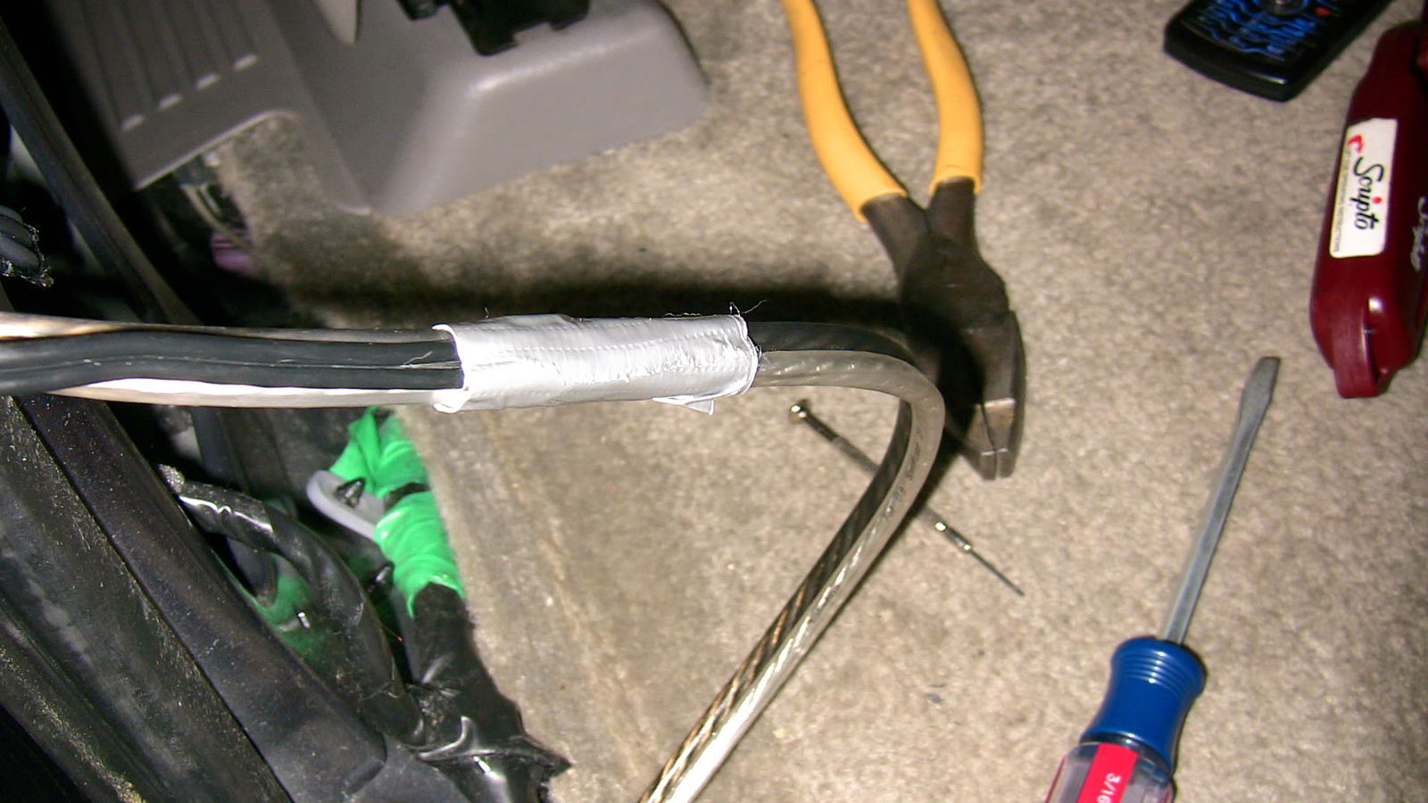

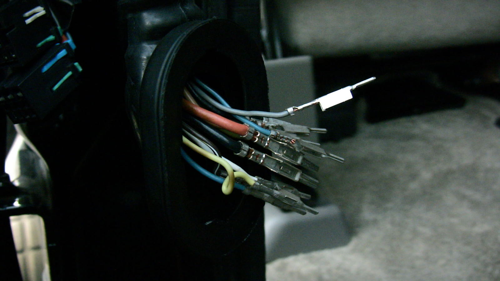

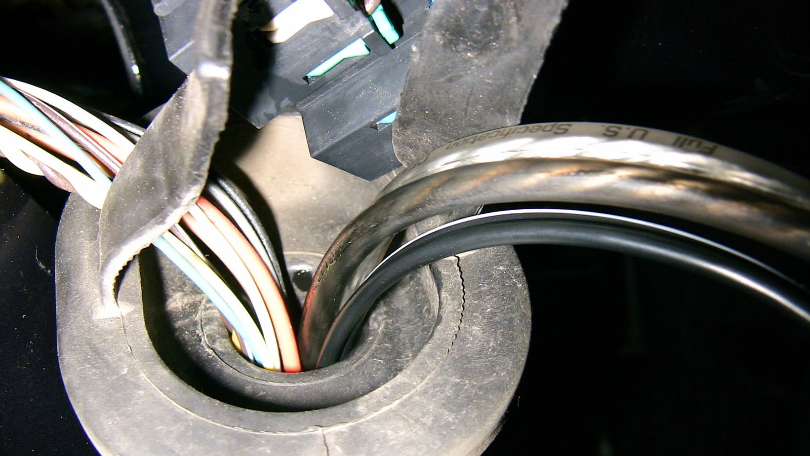

silicone lube and duct tape is your friend for pushing wires through grommets

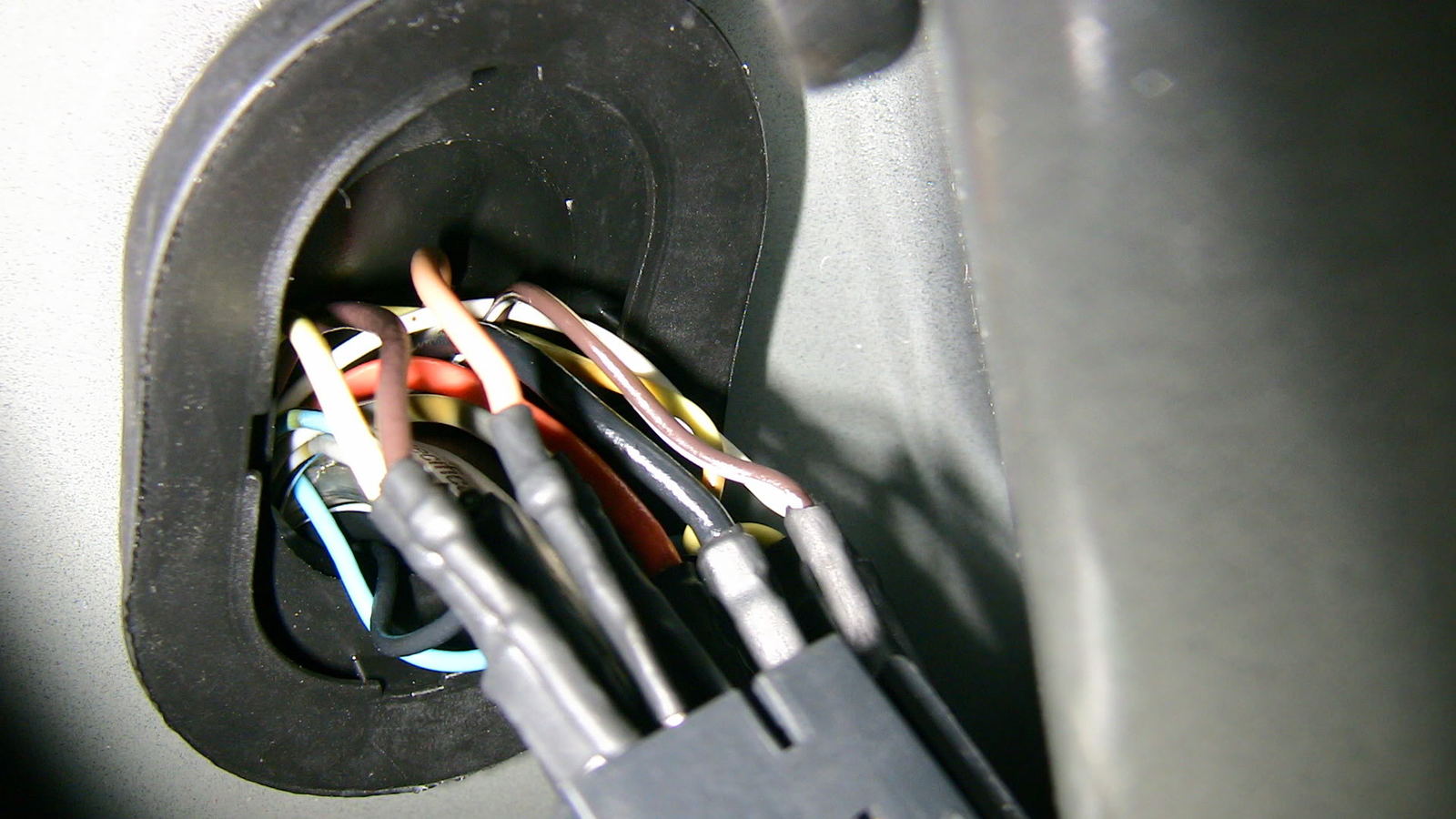

black plugs all wired up

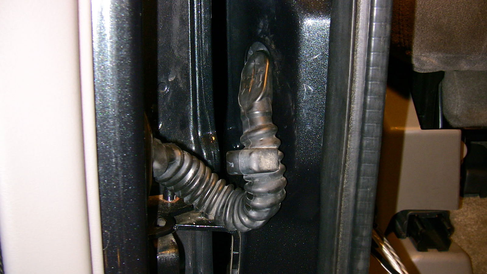

not exactly water proof but I'll be thinking of a solution soon
the boot was only meant to wrap around the white plug not fit in between the door frame
RCA's, speaker wire, and Rockford Fosgate bass knob
waiting for a home :D
kinda messy but I still need to mount the crossovers so it will get cleaned up

Not to bad, you not worried about the terminals seperating when opening the door, or vibration? I've been trying to think of a way to wire the doors so i dont have to use the existing wires, but not sure if this is the way.

opening the door won't rip them out because there is no tension its just suspended there.
vibration isn't a problem because when I close the door it kind of seals it together and makes it solid in between the door frame and the plug is floating in the b-pillar so it can't vibrate on anything.

You definitely went the extra mile!
Here is how I did mine; I just drilled out the top 3 empty slots, and the bottom one, (which you have a lot of pics of) - I just drilled that out, and aimed away from the other pins. As you can see, you have ALOT of room to work with if you do it that way.
Only added about 15 mins to the job. I posted earlier that I ran (2) 12ga wires, but I think it was 10ga than I ran for my 530t's.

yup I considered that after you said thats what you did but IMO it was easier for me to do what I did because now I can run a lot more wires if needed.
