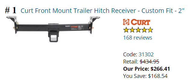

I recently purchased a 2021 Yukon Denali and I want a front 2" receiver so I can use a winch mounted on a shank and also with a hitch to push my camp trailer into parking position.
I see you can't buy one so it'll have to be custom. I know a guy that can weld and fabricate but if I could find something close it would make it easier.
Does anyone know of a 2020 (or earlier) receiver kit that would be close? I see styles that are 1 piece like this
but I've also seen styles that have frame mounting brackets and then the receiver body attaches to these.

I would talk to the guy you know who would do the fabrication. He will likely make the decision if it is easier for him to use one of those premade ones (that will still require fabrication) or if he should just start from scratch all together.
