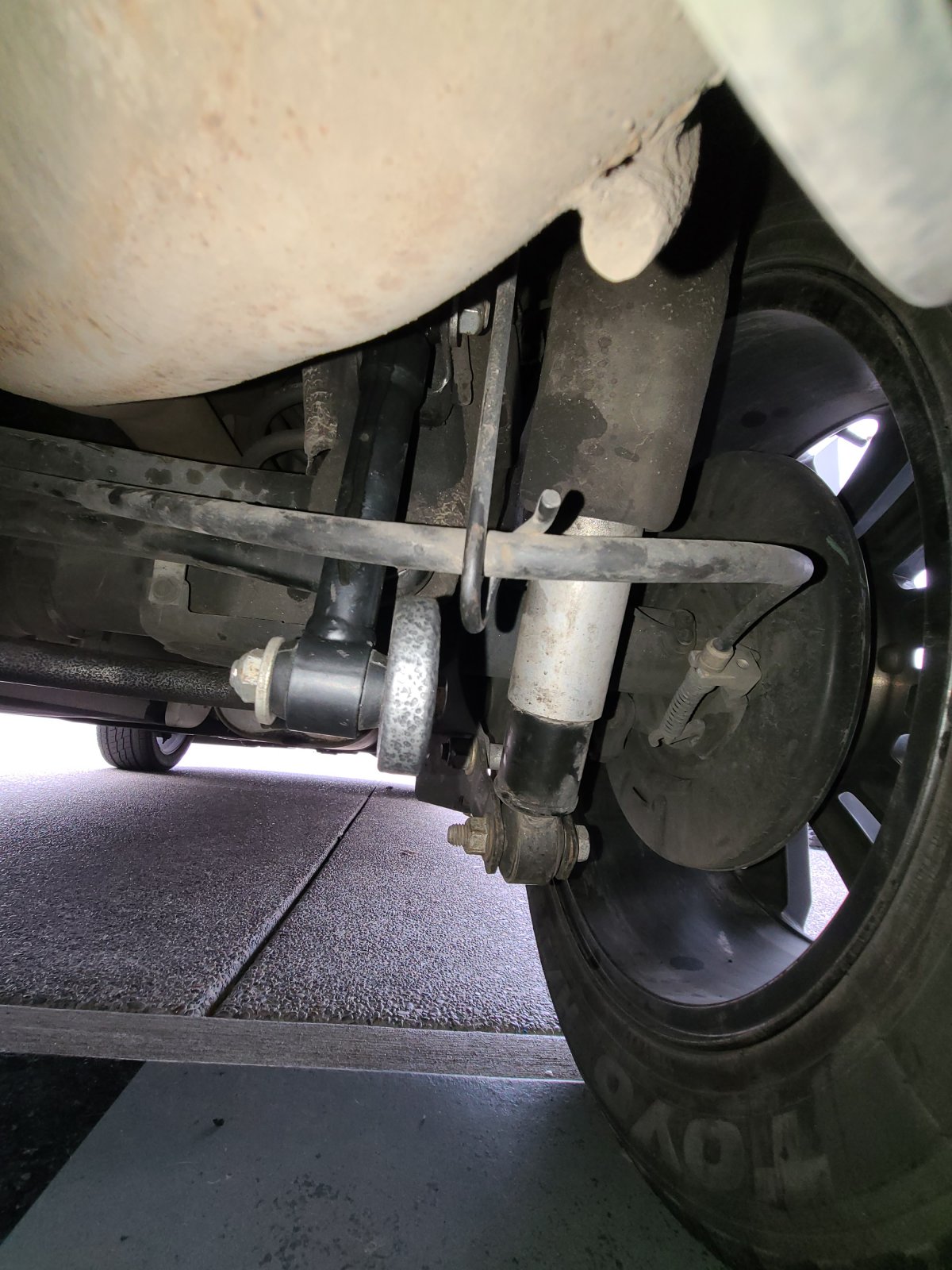

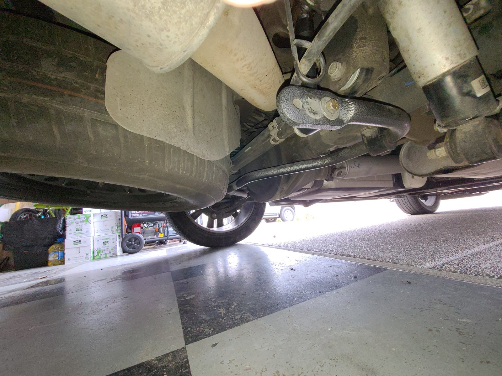

I have already put 5,000 miles on my lowered + Hellwig swaybar setup and still loving the transformation. No rubbing/noise from the swaybars so far.
Here are some pics after I adjusted the supplied endlinks to the rear Hellwig swaybar. I ended up removing the lock nut and making the rear links as short as possible and the rear swaybar is close enough to being parallel to the ground for me. I did spray some WD40 on the endlinks to make the adjustment of those long treads go easier + I just hit the 80K mile mark on my Yukon underside is well passed due for a detailing.

Looks like you also adjusted the sway bar. How does the new position feel compared to when you had it in the middle?
I had no complains with the middle position but the inner position has a better feel to it. It's still so impressive how well the Yukon handles now and I drive on curvey backroads often.
