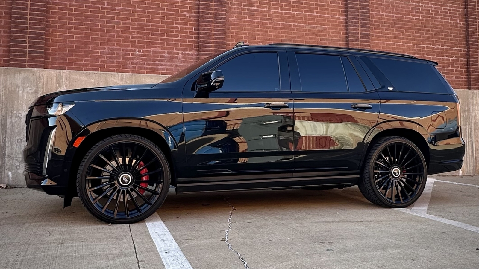

Really wanting to add lowering links but want some feedback on drivability. The wheels dont ride bad currently, but will the links cause the truck to bounce a lot and ride rough?
I want the truck to sit like this in the pic when I'm driving. Currently it lifts up a lot after 5 mph.
Who has added lowering links and what is your feedback?

I have installed. Set it up to be lower 1 inch from factory Front and Back. I like it, I installed for fuel mileage. Have I noticed a difference in MPG's - No, not much. When in enty/exit mode up to 10 MPH rides like a lumber wagon. Ride is still the same in "Normal" Mode from Factory links to lowering links. I believe if i went any lower I would notice a ride difference as its nearing the bumper stops within shocks/bags (id assume there is some type of bump stops to protect the bags when hard bumps or terrain hit/happen?). If I'm not mistaken with factory links in at entry/exit mode I'm nearing the ride height measurement I'm at in normal mode with the lowering links in. And with the factory links in at enty/exit mode that 0 to 10 mph ride quality felt like a lumber wagon also. That it why I say much more lower with the lowing links the ride quality would be gone. Ill see if i can find the measurements I took in all modes before and after installed.
