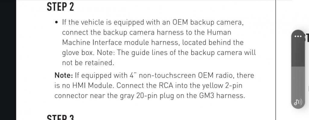

I can't seem to find the HMI module in my 2016 Tahoe PPV. I looked behind the glove box and didn't see anything that looks like a HMi. Does the PPV's not have a HMI? Is there a factory amp on the PPV models?

behind the glove box on all k2's
I have the 4" non touch screen in my Tahoe. According to the maestro install guide, I don't have a HMI.
