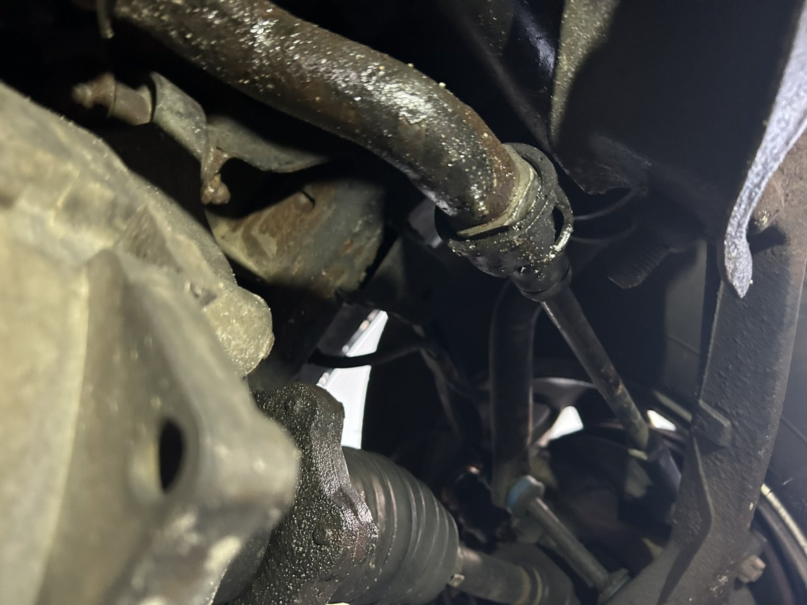

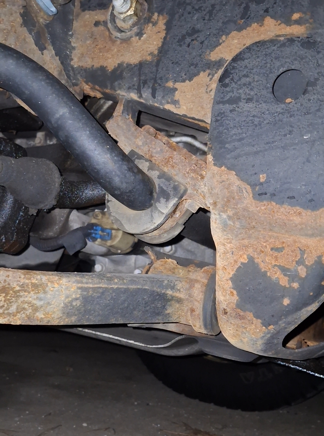

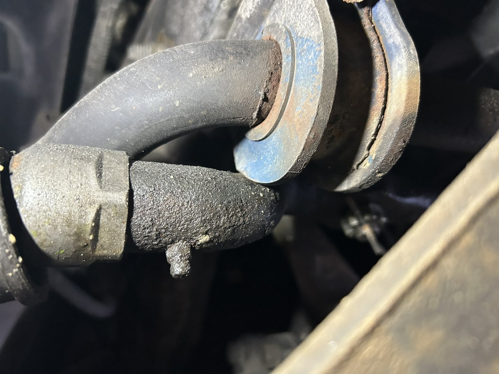

If you look at the ends of the center link they go forward and down twoards the sway bar on yours it looks like.
Mine go backwards and away from the sway bar. And as far as i know, mine is factory.

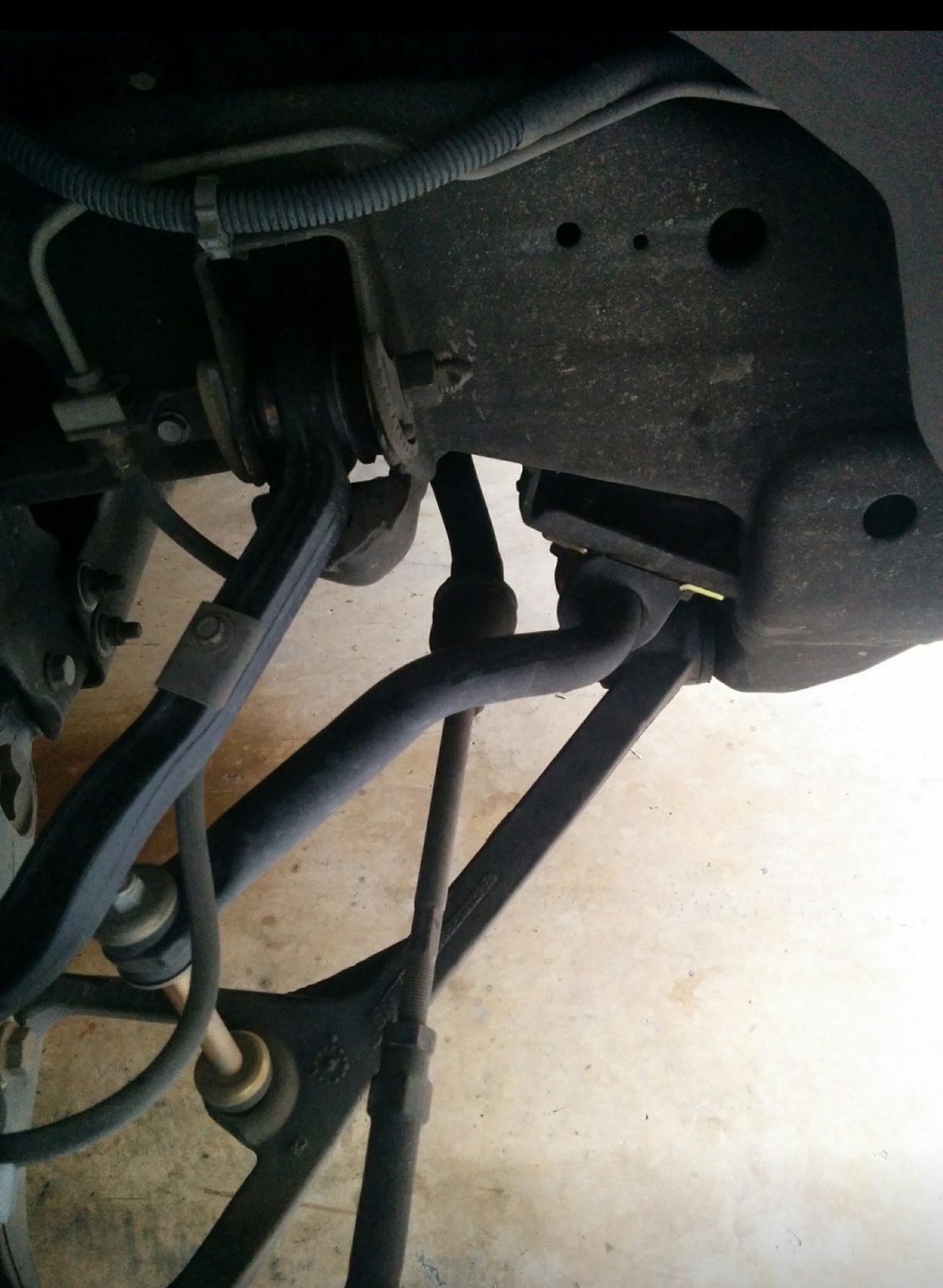

Yes and the third picture shows the centerlink and tie rods out of parallelism. Flip the link 180*. Remove the nuts on the tie rod ends, pitman and idler and rotate right to left. Can leave the tie rods attached to the link.
Probably don’t even need the parts cannon for this, but might look into the shape of the tie rod boots.
I just looked at my Denali it is like the OP and my Tahoe is like your pictures. Now I am wondering if mine is backwards as well. I never heard of a centerlink being able to go on wrong but I can't imagine different steering setups between GMC and Chevy as they are same bodies.
There aren’t different setups AFAIK. I know exactly when mine got inverted and I chased it for years until reading the post @Fless linked and another more in depth thread from @SnowDrifter: https://www.tahoeyukonforum.com/threads/scrubbing-binding-while-turning-at-near-full-lock.86256/
The guys at Firestone that did my tie rod ends and pitman took the whole assembly down and like many of us, did not realize there is an orientation to it that keeps the geometry set correctly. The link can and will install incorrectly.
Mine would never hold an alignment, had to start making 3 point turns into my swing garage, tires squealed embarrassingly when parking, and chewed through front tires in short order.
THIS IS A 2WD WITH LINK INSTALLED INCORRECTLY: (SHOULD POINT REARWARD - see how the tie rods aren’t parallel and look angled?)
