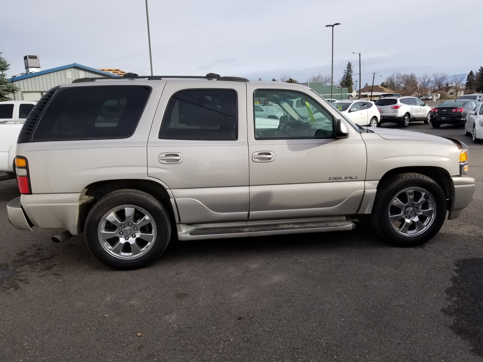

Question: Will my current setup on my '15 Silverado work on an '06 Yukon Denali I am eyeing at a small used dealer?

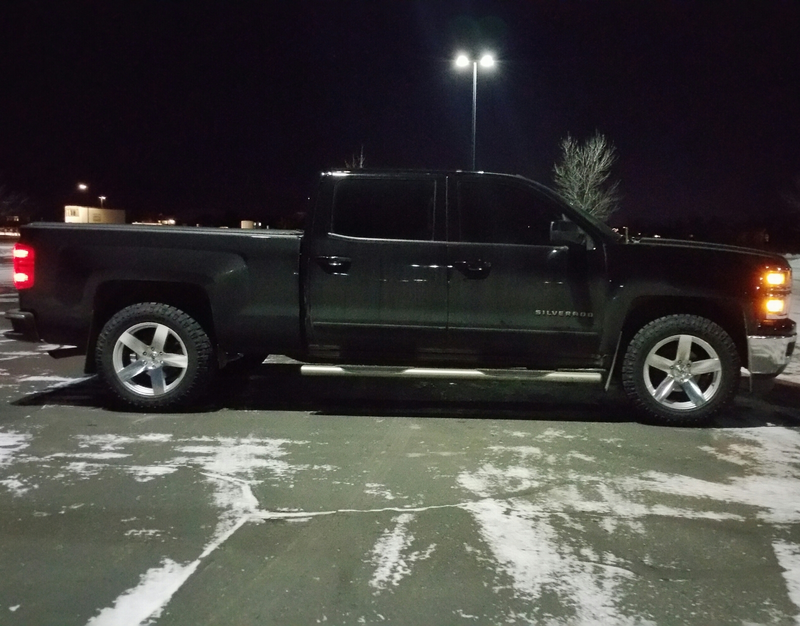

I have a '15 Silverado running 20x9 Black Rhino Everest +15 with 275/60R20 Duractracs. I did have to level my truck with a 1.5" kit and trim the inner corners of my mud flaps to get rid of the rubbing.
So imo just looking at it, its either def NOT going to fit or Im going to have to lift the Yukon and trim something in the wheel well too huh? If so then i'll pass on my Duratracs and try to sell them off (only used for a year) and grab something else. I do love the Duractracs though theyre beastly in the winter up here in MT. Maybe grab a smaller set of them or something idk. Im not really looking in to putting a whole lot of work in to the Yukon as it wouldnt be my primary vehicle (used for winter, boat/camper haul).

Well its not letting edit the OP but here is how my truck looked before and after the level

Put the same level kit on and it should fit easy 33 inch tire will fit.Are those 20" rims on their already?
Yes. On the Yukon currently are 20s. The wheel well area on the Yukon just looked small/lower to the current tire.
Thanks for the reply, i will look in to a good set to level and research more.

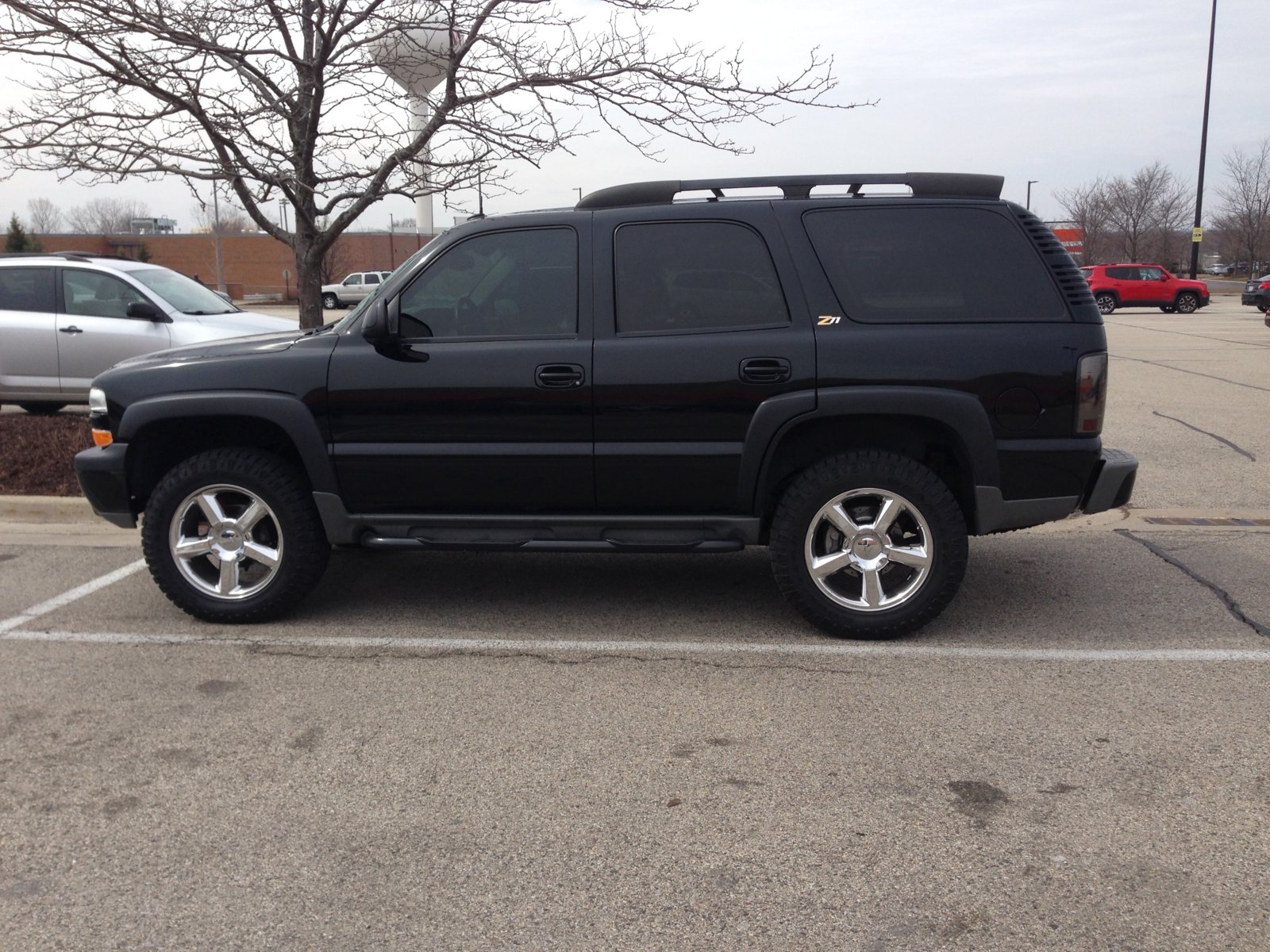

Im betting they are 275/55/20 so your about 32 inch on those your duratracs are 33inch diameter so your only going up 1 inch even though it looks alot more.If you go up 1 inch in the keys and maybe 1inch spacers on rear i didnt have to put them on my 04 you will be fine.I have the same duratracs that you do.

Im betting they are 275/55/20 so your about 32 inch on those your duratracs are 33inch diameter so your only going up 1 inch even though it looks alot more.If you go up 1 inch in the keys and maybe 1inch spacers on rear i didnt have to put them on my 04 you will be fine.I have the same duratracs that you do.I have absolutley no rubbing,triming or cutting.
