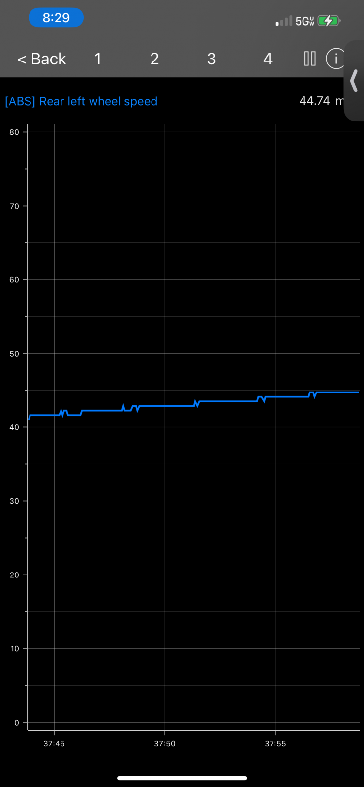

This first one is an example of what the graph looks like on a good sensor:

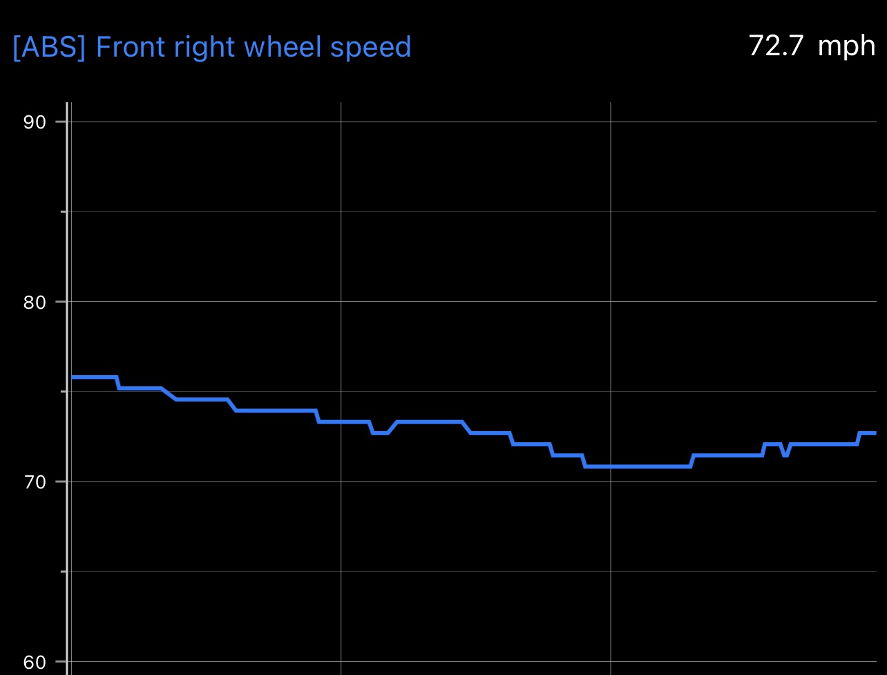

Then a couple of minutes later, here’s the bad sensor again:

I’m kind of at a loss as to what I am looking at, not knowing the sampling rate, etc…

I am guessing a bad connection or a wire that has rubbed to ground and is pulling the signal down. Since you replaced the sensor, it is not likely the sensor. I do not think the reluctor wheel could have drops like you are seeing.
Something more than likely damaged the wire for that wheel sensor somewhere along the harness?? Not sure if water or brake fluid could have made its way into the ABS controller, connector. I am not sure where it is even located in these vehicles, I am sure a Internet search or someone can tell us where the ABS module is located.
What I would do is jack up the drivers rear wheel and depending on the differential type, try and spin the wheel by hand and watch what happens. Sure it will be a slow speed, but you might have a helper pull on the wiring and bang around where you think the wiring harness may be routed while watching the sensor graph and see if you can force the drop outs.
