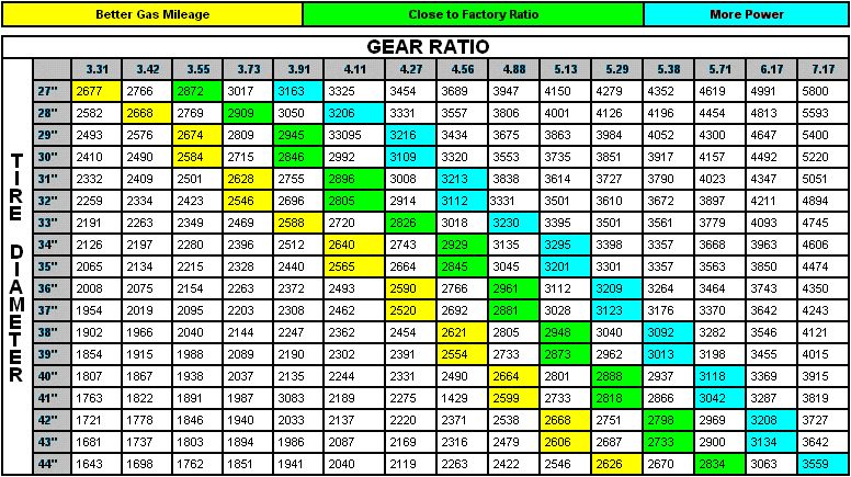

Here is a picture from bowties post in the Lifted Supension - Z71 & 4x4
your running Metric to Standard Result: 285/75/17 = 33.8x11.2/17
so possibly if you wanted you could run 4.88 for more power but its your choice in all.

With 285's, I have factory 4.10 gears with the G80 in my Silvy (different vehicle, I know) and I have great power compared to one with 3.73's. So anywhere from 4.10's to 4.56's would be good for 285's. Even 4.88's but that seems like too much gear for that tire size.
